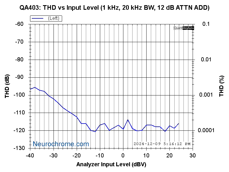

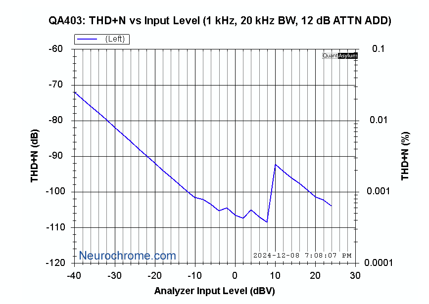

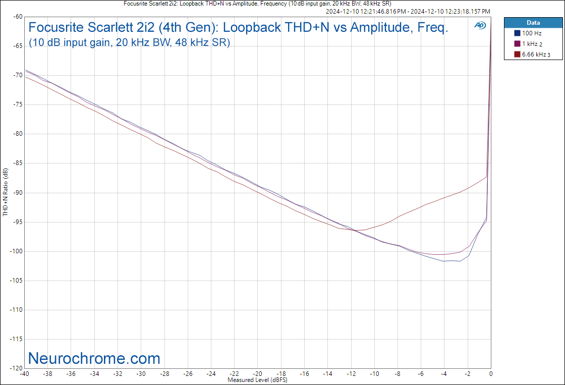

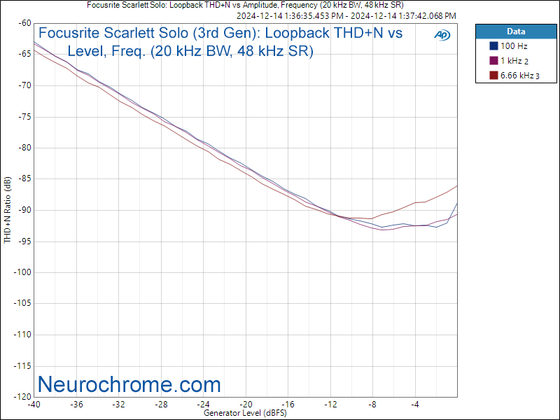

I just finished testing three such options:
Unfortunately ultrasonic noise limits the maximum usable frequency for THD+N vs frequency sweeps on the Scarlett sound cards. Basically the noise renders the 192 kHz sampling rate useless for audio measurements. 96 kHz works fine, but then you're limited to a maximum test frequency of 15 kHz if you want two harmonics (H2 and H3) included in the THD measurement.
I've included the loopback plots below. I have tons more measurements available here: https://neurochrome.com/pages/measuring-distortion-on-the-cheap
- QuantAsylum QA403 Audio Analyzer ($600)
- Focusrite Scarlett 2i2, 4th Generation ($200)
- Focusrite Scarlett Solo, 3rd Generation (Refurbished from Focusrite: $80)

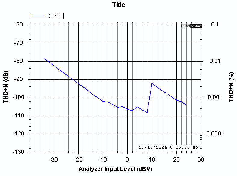

Excellent. That's actually pretty remarkable unit-to-unit consistency.Hey Tom, can confirm your results are consistent with my unit.

At one point I discovered that that my long standing hiccups with my Scarlett 2i2 was related to some software incompatibilities; so I had to look for an alternative.
The gen4 has been discovered to be slightly worse than gen 3, and I was tempted to get the QuantAsylum QA403.

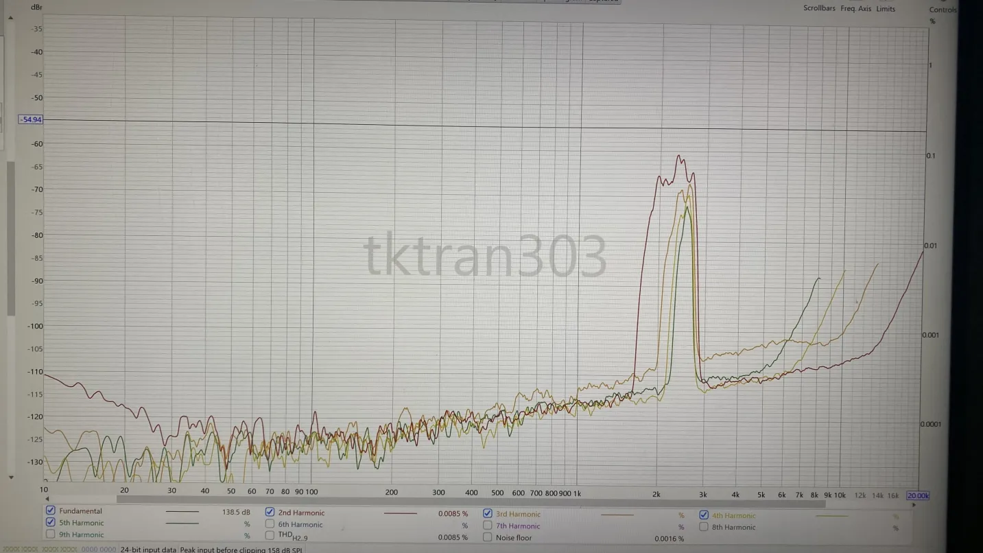

What is the test environment? I was hoping to run REW with it, but I hadn’t heard any reports of people doing that.

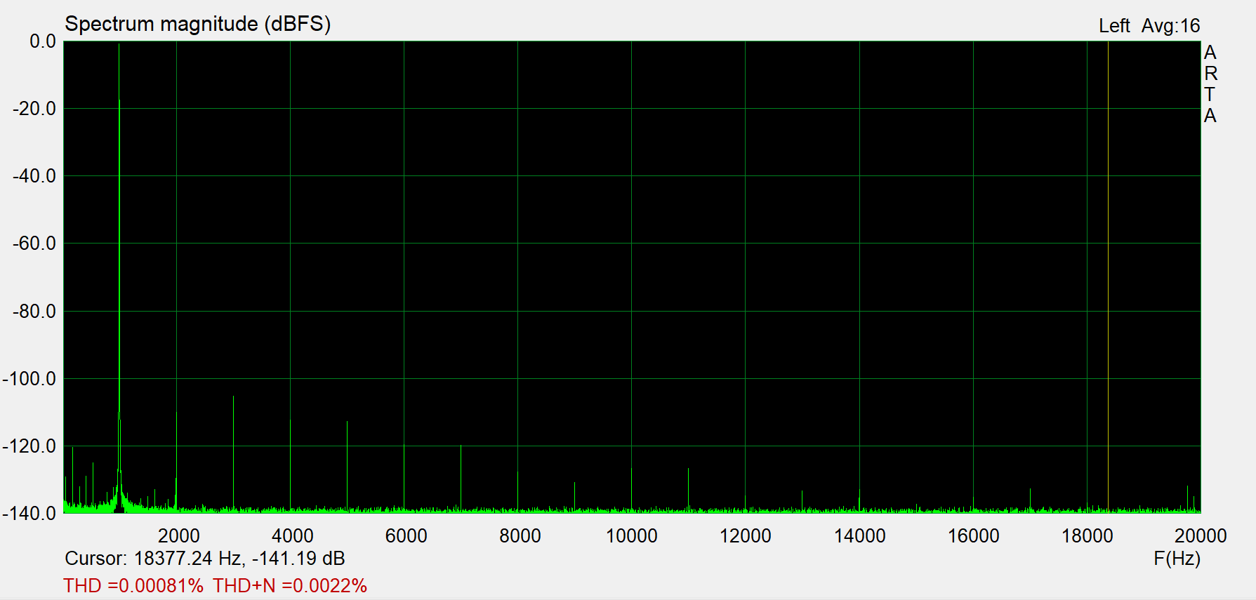

Below is the plot of 1kHz loopback, single ended, with a 2nd generation 2i2. These go for 1/3 to 1/2 new bought used, so meet the cheap goal. These also have analog input pots.
I like ARTA, and use the win 10 snipping tool to save images like below.

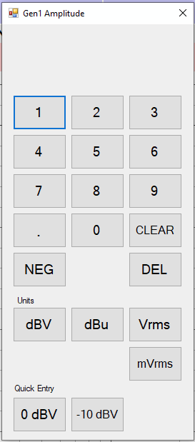

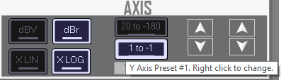

Great, but not intuitive.Control+1 (Ctrl 1) or 2 brings up the direct entry for each generator.
This wasn't intuitive either:
You can also right click the GEN button. Unless I remember incorrectly, the dialog you show is different from the one that comes up with a right click on GEN1. Why? Again, not intuitive.
True. But that's still not intuitive. It's not intuitive that I have to right-click on a seemingly inactive field that says "20-180", or something like that, to set the Y-axis settings. How about a button labeled Y-AXIS or something?When you get the unit, right click on every tile to see what options there are. It takes all of 10 minutes and you'll know what is what.
True. Until next time you need to use it.After using the unit for a day, you'll know where everything is.

Like this one that says "Axis Y Preset"? The one where hovering the mouse pointer on it, tells you what to do?How about a button labeled Y-AXIS or something?

Personally, I love keyboard shortcuts, Alt keys, function keys and not having my hand on a mouse all the time. The fact that the QA guys are so responsive to requests and features is also unique. You can operate the QA403 with just a keyboard for most tests, or a touchscreen all-in-one which is pretty cool.
We've had 15 software updates since September 2023, many with added useful features and improvements. Amazing. One of my previous analyzers had just one release in 25 years!
That's flat-out false. I base my opinion on my educational background, which includes human factors engineering, i.e., how humans and machines, including software, work together. But it is still my opinion. I do believe it's an informed opinion, however.ou're coming from the AP and have been using it for years. Anything else will seem to be not "intuitive" to you.
If I had to right-click every item in MS Word, Final Cut Pro, Photoshop, or any other program I use on a regular basis in order to figure out if it had some hidden function I'd go mad. Figuring out how to use a simple piece of software like the one for the QA403 shouldn't be a game of right-click whack-a-mole. But it seems like we disagree on that. That's fine. I was able to learn the APx500 software without ever reading the manual, using the help function, or any of the hover help items. I was going within seconds of launching the software. That's an example of software that's intuitive to use.
I simply don't have the patience to deal with crappy software. And I have high standards. I mention both in the video. As I also say, you can decide whether what I grumble about would bother you. You have clearly decided that it doesn't bother you, so great!
I see lots of room for improvement in the QA software. I'm not here to slam QuantAsylum. I just think it would be nice if the quality of the software matched the quality of the hardware.
That's great! I missed it because it's buried with a bunch of completely irrelevant information. Had it been in the prominent dialog box I would have seen it.You mentioned a progress indicator for automated tests. We have one...
