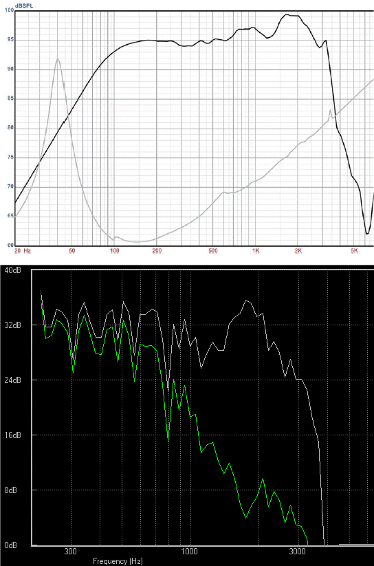

gedlee said:
no speaker should be used above the point of the first surround resonance because no speaker is pistonic in that region
Does it look as though I have crossed this driver far enough away from the cone breakup? The top plot is a factory plot on this 15" driver. The lower is a screenshot of my crossover simulator showing the peak at least 20dB below the main level.
Thats some pretty rough looking data. I'd hate to judge anything on it, but youy have the right idea.
(I didn't think great accuracy was necessary and this plot showed what I wanted to show.)
Thanks for your opinion.
Do note that "first surround resonance" is different from (and often lower than) the more obvious "cone breakup", and that in fr plots it often produces a null rather than a peak.
Was it obvious to you where that resonance was?
No . . . the response curve is too ragged, indicating all sorts of resonances and breakups, and making it hard to identify the cause of any. That's why I stopped using large drivers for anything but subwoofers years ago. There is something really odd going on at 600 Hz. . . . anything that can produce a blip that large in the impedance curve should be looked at . . . (and a smaller one at 900-1000 Hz., but I don't know what those are either). There's also the obvious big null a bit below the most obvious breakup . . . the cone, or at least the edge of the cone, is out of control.
But as I said, I stopped using big cones up high because they are unpredictable and unmanagable.
IMO surround resonances has a little common with a cone diameter. All drivers has surround and and surrounds are the weakest parts of radiating surfaces and starts resonate first (sometimes supported with cone rim resonance). Surrounds differs in weight, geometry, material and width. These properties are responsible for where the resonance is and how well is damped. Most often it is in the range of 700Hz (for heavy half-roll or wide pleated) to 1K2 Hz (narrow pleated) and doesn't make peak at IMP curve but small ripples or plateau.
Resonances below probably comes from spider and airborne resonances in motor or basket. Nevertheless they can be EQ'ed out perfectly if they are not excursion dependent.
