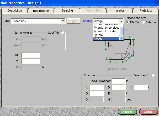

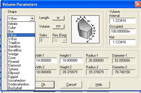

Take a look at LEAP or Bass Box Pro. Both have a rather extensive list of possible enclosure types. Can't imagine you needing more basic shapes than are available in them.

I do believe this is only for internal volume calculation.😉Try simulating the Nautilus(for example)😀Or this:Take a look at LEAP or Bass Box Pro. Both have a rather extensive list of possible enclosure types. Can't imagine you needing more basic shapes than are available in them.

Not with LEAP it can simulate the polars as well and the environment and volume you the simulations in.
That's a unique exception although you may be able to get close. You don't really need to anyway. All you need is the measurements set and impedance runs with the drivers in the enclosure and you can do the crossovers from there.
