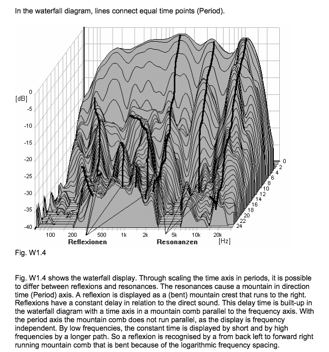

It is hard to imterpret. What you want to look at is the ring-down of the device. Periods makes the portrayal of time axis equivalent across the bandwidth.

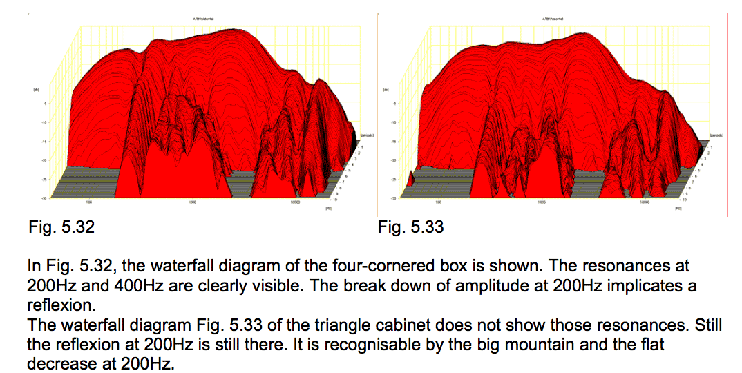

Photostory speaker acoustics audio measurement development OK² Nugget Dipol-Cardioid Kardioid free
A couple example from one of the papers attached below.
Given the discussion context, not the best example (wall panels -- and different measures)
2. I like looking at 3D and not 2D (2D is boring). I like the new wavelets offered by some members of DIYaudio.com....These are typical compression drivers....none of them are flat when measured on a waveguide. Isnt the idea behind CSDs or wavelets is to see what driver has sound that "lingers"? I do not see how a 2D model can show that is a easy way.
3D is needed if you have ms as time. Once you factor out that confounding information by switching to periods the 2D view gives curves you can analytically measure and removes the need for mental gymnastics.
They may not be as pretty as 3d graphs but are a whole lot more useful.

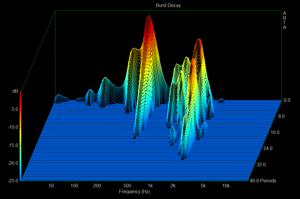

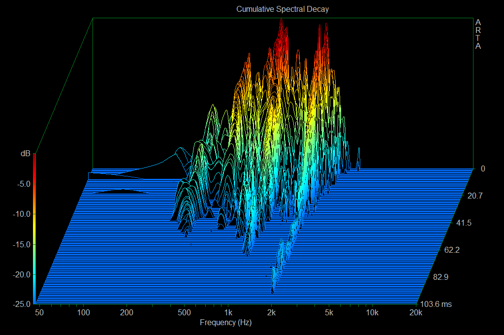

Thanks for the explanation of Periods. I will have to check how Arta does this.
