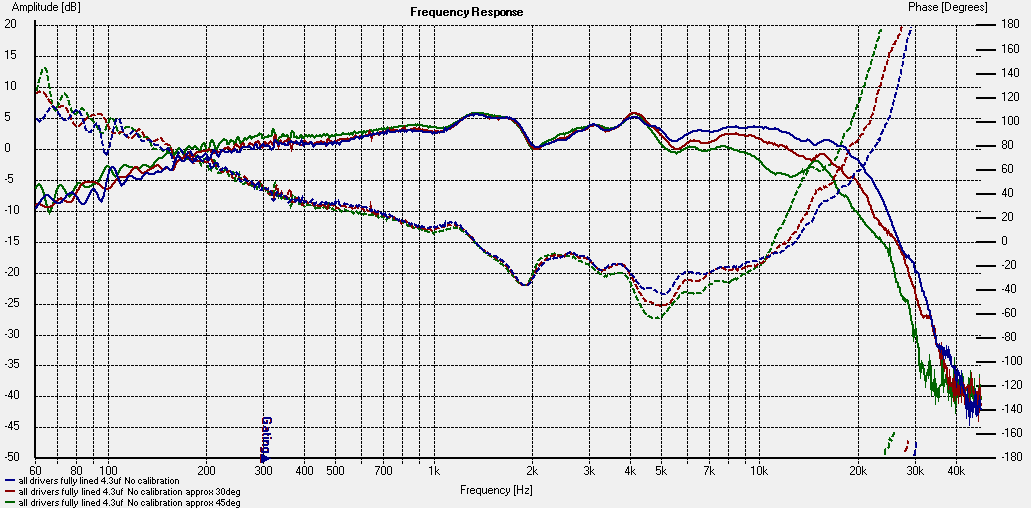

I've done some horizontal off axis measurements of my drivers at 15 degree intervals out to 45 degrees (I had trouble past that due to room reflections). I'm just not sure what it is I should be looking at, with respect to making decisions about my crossover 🙂 They were pretty non-directional out to about 4K (and I'm now crossing 2nd order acoustic at 3K at the moment) so wasn't sure if I needed to worry about it at all.
Also another thing I wasn't sure about when doing off axis was the relative shift of the drivers when rotating the cabinet. I simply rotated on the axis of the middle of the cabinet leaving the mic in the same place, but when the box goes past 45 degrees the mic is pointing at the side of the box rather than at the driver (due to the arc the front baffle follows), so I wasn't sure if I should move the whole stand back to compensate (probably need to re-read my d'appolito!!).
I don't have a graph with the individual drivers handy, but I do have one with the very first "crossover" which consisted of a single 4.3uf cap on the tweeter, and the midbass' running full range. This will show what I mean about being pretty non-directional to about 4K. My measurements have improved since then, and so has the crossover (I think!) 🙂

Thanks Dan, the graphs do show the story 🙂 I went and checked and I only did off axis measurements of the whole system not the individual drivers as I had thought, I also discovered that at 30 degrees off axis they are a lot more directional that that graph I posted I think I didn't do a very good job on those measurements 😉
