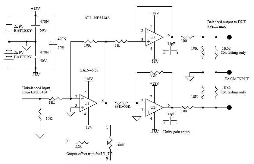

Hi trobbins, Is it possible for you to share the schematics for the balanced line driver? I need to test some small PP headphone OPTs with REW using your method and I don't have any idea about the balanced driver.
Any help will be appreciated.
Sajad
Hi Sajad, attached is what I used for the balanced line driver in Fig.3 of the on-line doc.
I also started to look at using higher power levels. One method is to use a stereo ss PA amp as the balanced driver (some amps have integrated bridge mode circuitry with a balanced input), the OPT is placed across the outputs of the two channels to effectively double the available signal voltage swing. Given a typical 300W amp with a common +/-80Vdc rail for both amp channels, the effective PP drive signal is up to about 2x 80V = 160Vpk. That is 113Vrms, which for a 10kPP OPT could allow testing to 1.3W. But I didn't formally continue down that path at the time.

Thank you so much trobbins. In regard to using a class AB SS amplifier, the NE5534 driver should be placed in between the soundcard and the amp, am I correct?
added 1.25k resistors between amp and OPT - is that your intent too?
Yes I've read your article on Williamson transformers and I'm too using REW for measuring SE OPTs for a while now.
I always used reverse method with SE OPTs and in this method I normally use a resistor equal to nominal speaker load in series with SS amp output in series with transformer secondary and on the primary side I load it with a resistor equal to nominal primary impedance and take the signal from a voltage divider into the Scarlet 2i2.
This method only works for SE transformers since one side goes to B+, but in regard to PP OPTs the center tap goes to B+ and grounding one of the plate taps won't show the correct F response, so I probably use your method for this.
