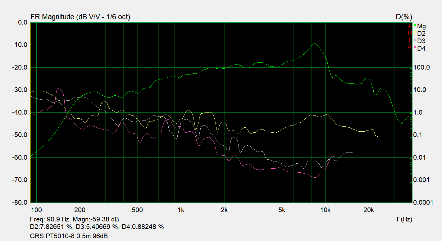

Even though there is another recent thread devoted to the new GRS ribbons, I thought I would start this new thread that compares the frequency response and distortion for the following:
My primary interest for all of these drivers is in dipole or open baffle systems with little to no baffle (e.g. nude) so I measured all of them "in the nude". To do this, I used the following:
Prior to starting the measurements for any driver, the SPL was measured at the mic tip using the SPL meter, and the level was adjusted to be 96dB using bandlimited (>200Hz) pink noise as a stimulus. This output is equivalent to 90dB at 1m distance. Levels remained identical during all subsequent tests on the driver.

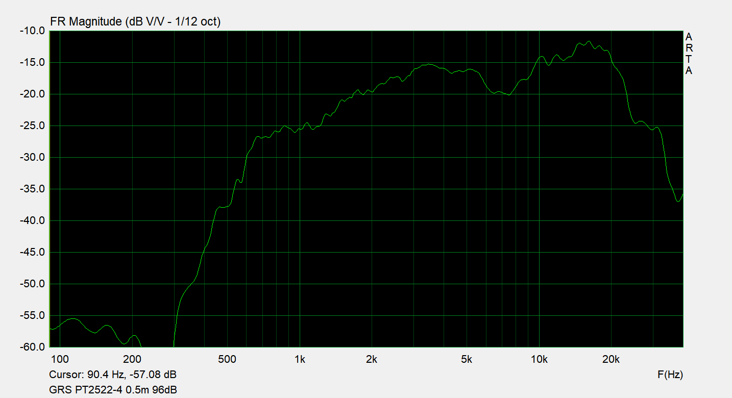

- GRS PT2522-4 (Neo3 copy)

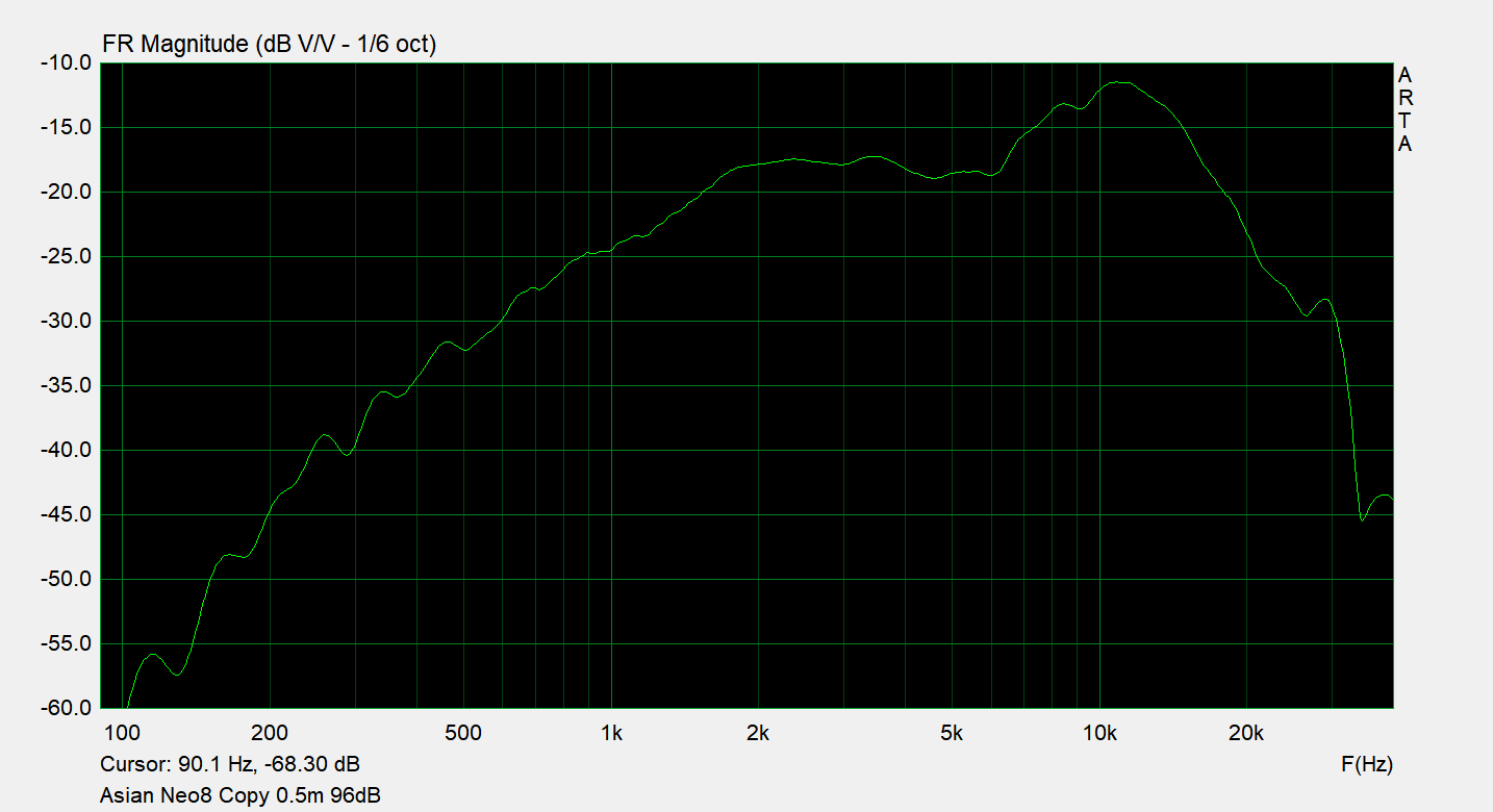

- Unbranded Asian copy of Neo8

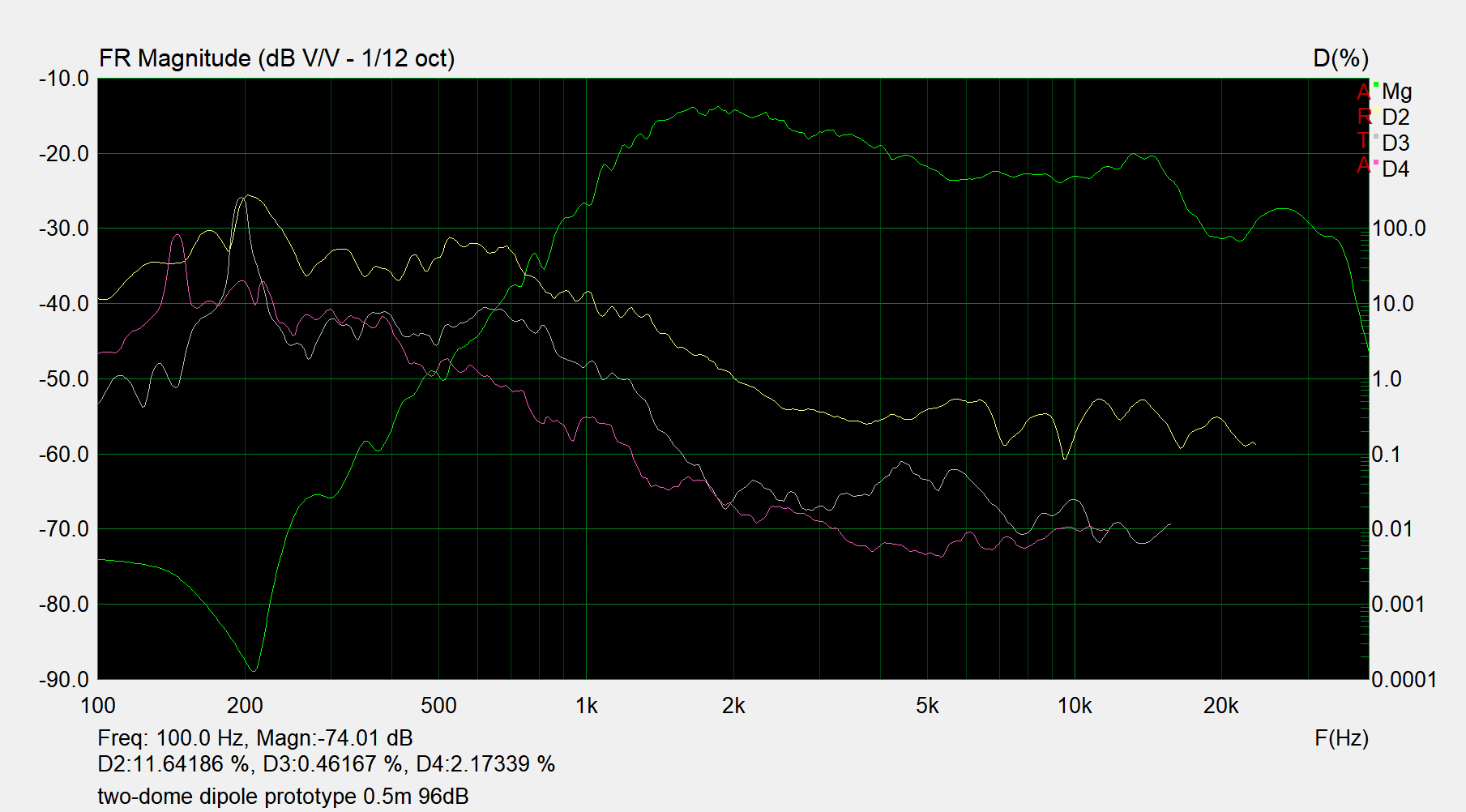

- back-to-back dome tweeters as a dipole
- All drivers were suspended by wires about 4-5 feet off of the ground
- Measurements were taken in a room with 7 foot ceiling, about 15 feet wide and 40 feet long
- ARTA and STEPS were used to perform the measurements, running on a Windows laptop
- The mic was an Earthworks M30BX, placed at 20in (~0.5m) from the driver
- Audio interface was a Focusrite Clarett 2Pre USB
- Amplifier was a Parasound Zamp v3
- SPL meter was the Galaxy Audio CM-130
Below, please find a pic of the drivers used. Starting from the two dome dipole and moving clockwise are the PT5010, PT2522, LM8K, and the Asian Neo8 copy at bottom left. Not shown: Neo3PDRW. All drivers were used right out of the box, without break-in. No series capacitor was used for these tests. I did not perform any impedance measurements.
First up are the frequency responses.

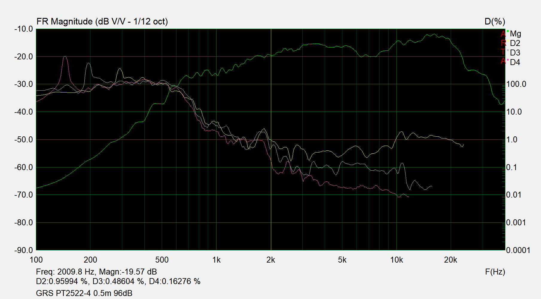

Next is the distortion for each driver measured in ARTA (I like to call this a "quick distortion measurement").

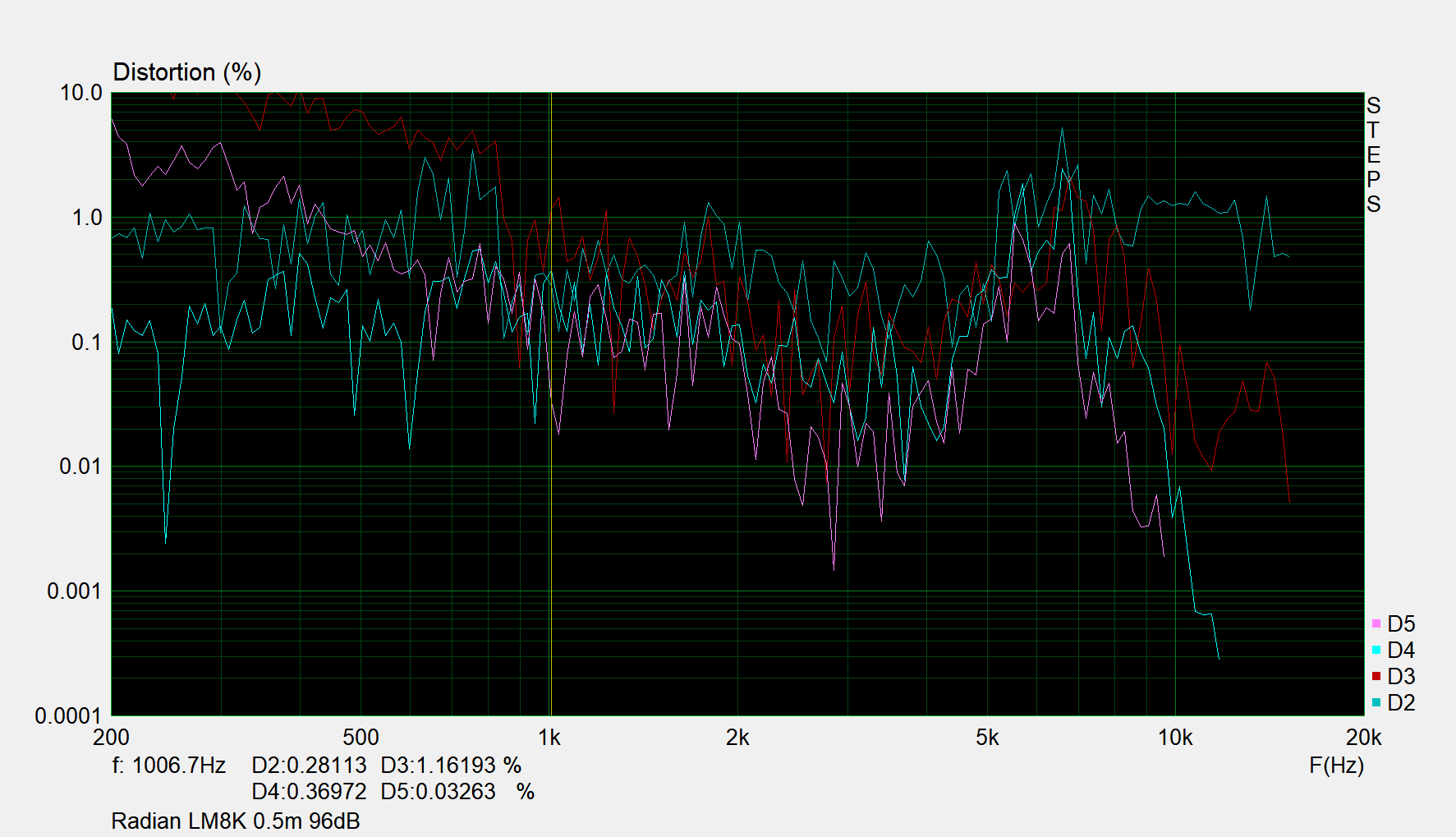

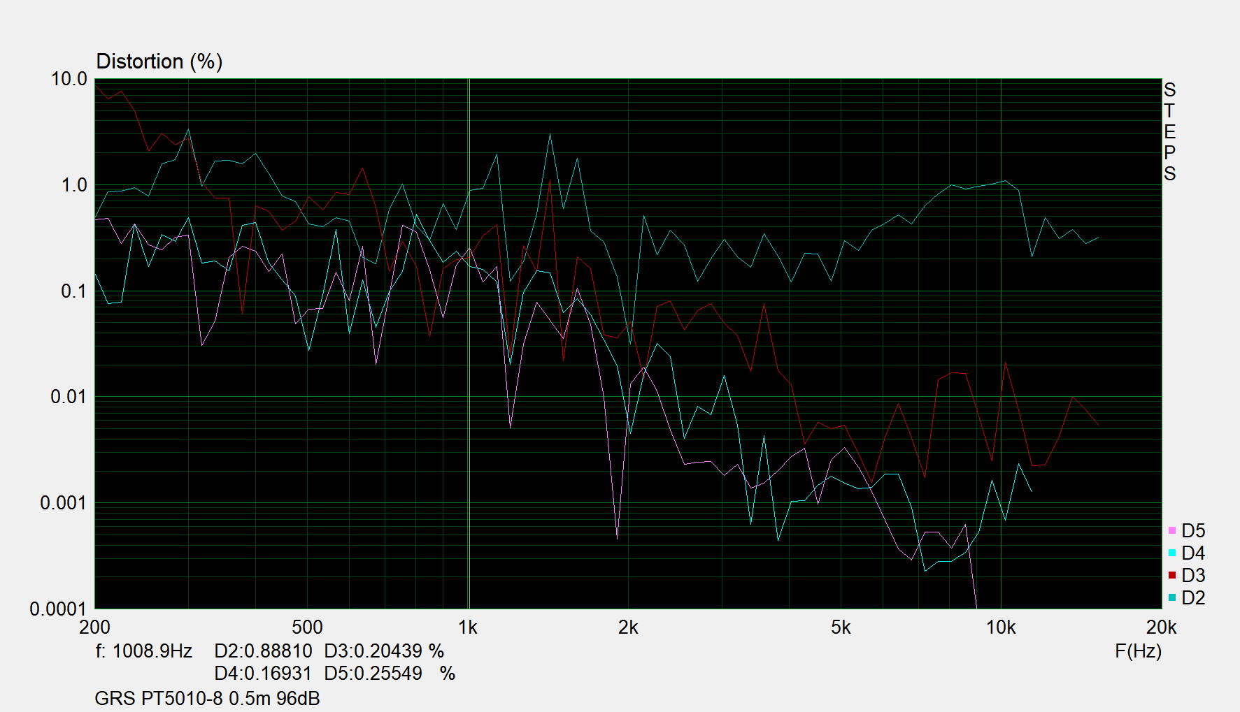

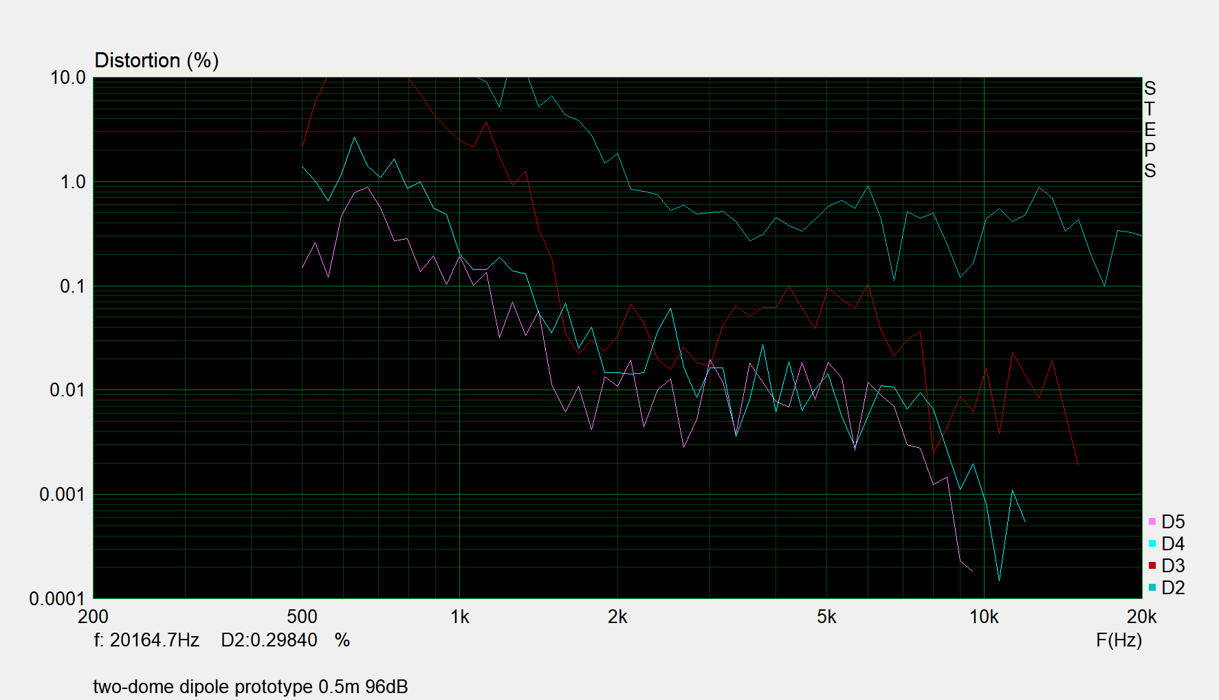

Finally, distortion measured using STEPS.
NOTES:
I did not perform a STEPS measurement for the Asian Neo8 copy so I don't have the data for it.

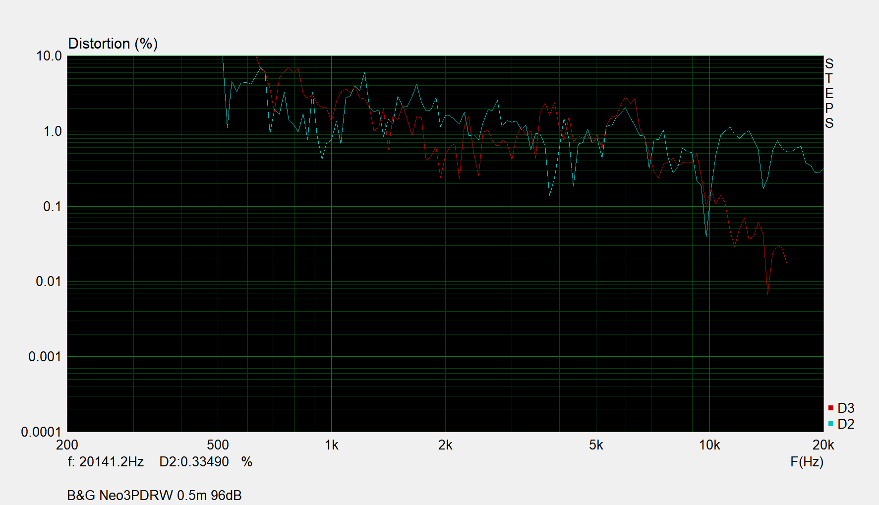

I accidentally overwrote the Neo3PDRW STEPS datafile with the STEPS measurement for the two-dome dipole. I will remeasure the Neo3PDRW and repost it later.
NOTES:
While performing the STEPS re-measurement of the Neo3PDRW it died and there was a "smell". I noticed that it, and the GRSPT2522, had become warm during the tests - the GRS was slightly less warm than the B&G from what I recall. I didn't think much about it at the time. The signals used in STEPS are essentially high power constant sine waves. In hindsight, the STEPS test is probably delivering more power than these two drivers can dissipate. Oh well, lesson learned. I got the two Neo3s off of Ebay as new last year and while they did look new you never know.
I re-tested the other Neo3PDRW and the resulting STEPS data is shown below.

I have been very interested especially in the distorsion measurements of the LM8K. But now I'm honestly a little bit disappointed. I hoped to be able to use it as a single naked midrange driver down to about 600Hz.
But your measurement show me, that you should not use it this way below 800Hz or even a little bit more.

Yes, based on distortion I think that 800Hz would be a good choice for crossover point. It depends a bit on the order of the crossover - lower orders like LR2 will be rolling off the power above the crossover point, so you MIGHT be OK going a little lower in frequency. It would be a good idea to measure the driver on the final speaker and see how low you can get away with.

The domes I used are Dayton ND25FW-4. It's a 25mm dome in a waveguide with a neo motor. I have crossed these over as low as 1.6kHz. The drivers are not expensive, but sticking two of them back-to-back is tricky. They can just about nest that way if the mounting holes are used and the drivers are offset a bit. For this particular prototype I cut away some of the waveguide so that the motor of one driver could rest up against the motor of the other. This keeps the side-to-side and front-to-back offsets of the acoustic centers to a minimum. I have to do off axis measurements to see how the pattern holds up but even with a slightly larger spacing, an un-altered pair actually has a very good dipole pattern.

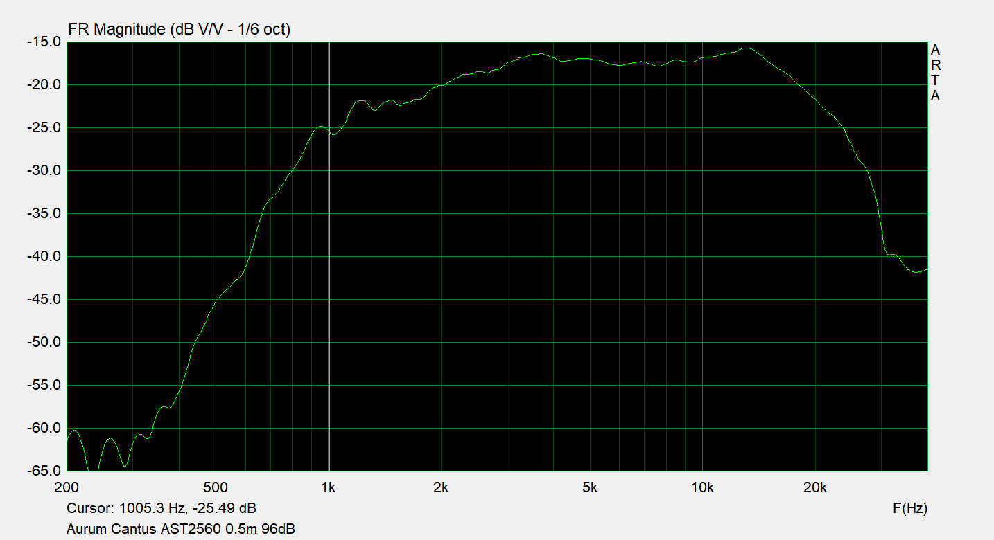

Here is another small planar driver to consider for dipole use: the Aurum Cantus AST2560. This driver is provided as a magnet assembly that includes a removable/replaceable "diaphragm" that are screwed onto a mounting plate. It is a simple matter of a couple of screws to remove the mounting plate, and what you get is a very small and compact unit that is mostly diaphragm. A thin felt pad covers the rear of the assembly but it can be peeled off. There are four dead-end threaded holes (for the faceplate mounting screws) that can be used to secure the guts to something (e.g. baffle or whatever).
I forgot I had this stored up for testing as a potential dipole driver, so I didn't include it along with the other drivers earlier in this thread. After having the Neo3PDRW burn up on me I have decided to no longer use STEPS for tweeter distortion testing.

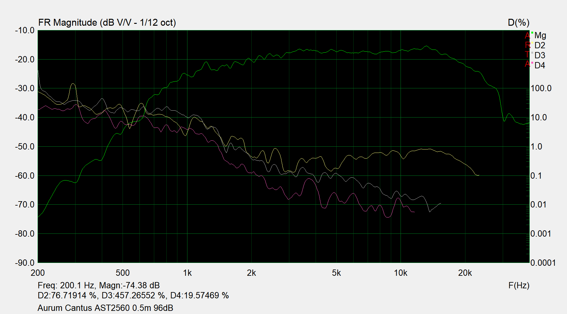

Plots of the on axis frequency response, and the "quick distortion" test, are attached. I used the same test conditions: 96dB at 0.5m with the driver suspended by wires.
This driver looks usable as a tweeter above 2kHz or so.

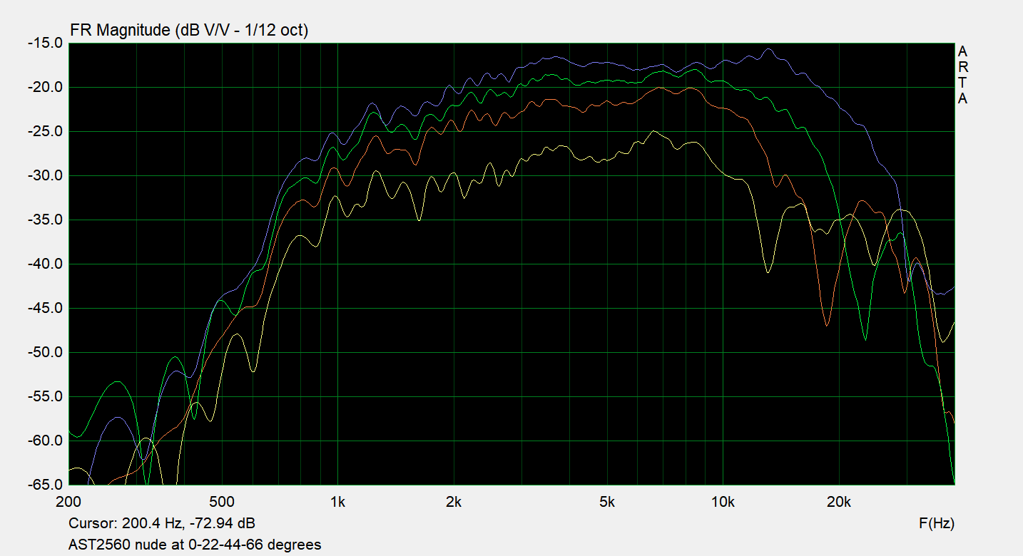

After testing the AST2560 above and while I had it on my test fixture, I decided to take a couple of quick off-axis responses and plot them together to see how it looks as a dipole. I used angles of (very approximate here) 0, 22, 44, and 66 degrees. It's not bad, really. The directivity of the pattern seems pretty constant until you get up above 10kHz. See attached plot.

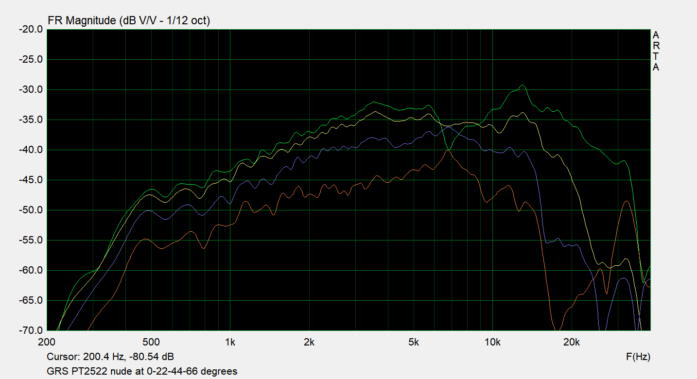

Well if I can do that I might as well do the same thing for the GRS PT2522 (Neo3PDR clone). After a few quick measurements, I had the 0-22-44-66 response family for that as well. But this time I found something, mmm, not great. The response around 7k has some issues. This is, not surprising and is very similar to the Neo3 dipole response. On axis there is a dip or partial null. As you move off axis this first goes away and then becomes a peak. The curves all bunch together and even cross. Eek. Just like what was observed for the Neo3 as a dipole. It's a real clone, down to the flaws and all. The plot of the response family for the GRS PT2522 is attached below.

NOTE: The GRS PT2522's 7k Hz on-axis dip is sharper in this measurement compared to the one that I provided previously. I think I was not quite on-axis the first time around. What you see here is truly on-axis for the 0 degree trace.

Nice FR plot but rather poor HD. Isn't that an expensive unit?
Hard to know the right level for testing tweeters. They aren't called on to play loud on music. Maybe far better if quieter test. Is there a 3D graphic for freq, level, and THD?
B.
For home audio that is getting up there in level. But that should be better at revealing flaws I suppose. Because the sweep only lasts a second or two I am not worried about damage all that much.
There is a distortion plot on the MFG product page for the AST2560 (see link in my post) that shows lower levels of distortion. Maybe a lower SPL level was used for it, and if so that is a good sign.
Yeah these are getting more expensive now. They were UD$40-50 each cheaper when I bought them, and right after that there was a price increase. Not sure why. Still, it costs much less than anything by Mundorf!
Edit: here is the MFG distortion plot - they do not provide the testing conditions, e.g. SPL, etc.:
Was this test run with the felt damping removed or in place?
Both the faceplate and the rear felt layer were removed prior to making the measurement.
