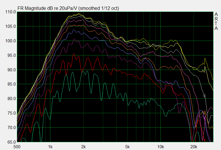

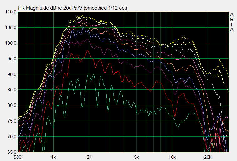

I have attached the response family (front and rear) of a slightly earlier version of this two-tweeter dipole that I have used in a loudspeaker system, crossed over at 1.6kHz. If you hover over the image you get info in the filename at the bottom of the browser window about angles used and which is the front or rear.
  • Dayton ND25FW-4 offset pair 25mm 0-11-22-33-44-55-67-78-90deg 70cm front.PNG
  • Dayton ND25FW-4 offset pair 25mm 0-11-22-33-44-55-67-78-90deg 70cm rear.PNG
I've considered using the AST2560 as a dipole, matching it with the Purifi PTT6.5 (also dipole). I would only do so if it was equally low distortion as the PTT6.5 (or close). Based on your measurements, I'm not sure it reaches that level of performance. Would you agree?
Unfortunately, I've only found dome tweeters that do, specifically the Bliesma tweeters and the SS 9900 and I can't afford using 2 of those back to back for dipole.
Believe me, and many other who have tried: you cannot just take a pair of any old tweeter and put them back to back to form a dipole. The pattern will likely look terrible. Many have tried.
I have not found many, if any, dipoles formed by two dome tweeters places back to back that have a better pattern than what I show above. The tweeters are inexpensive, and distortion is relatively low above 2kHz. You can even use a lower crossover point, because to equalize the driver flat you will be reducing the SPL in the vicinity of 2kHz by over 10dB, and this keeps distortion down around the crossover point. With a crossover point at 2kHz or higher, these are pretty good. They are not going to best e.g. the Mundorf AMT25D1.1 but two of them do cost about 35 times less!

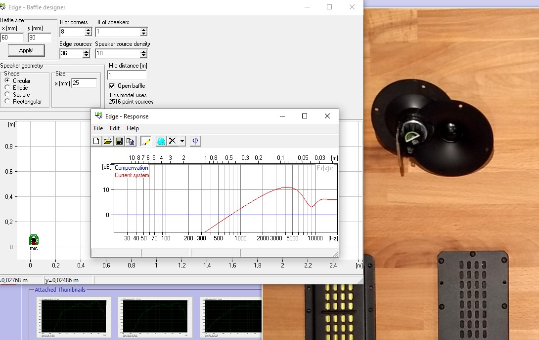

Charlie's el cheapo tweeters seem to have conical waveguide, which explains high spl around 2kHz even in dipole configuration.
Here is a quick Edge sim 60x90 elliptical "baffle" and a planar radiator. Dipole first null is so high that it isn't an audible problem to elderly people!

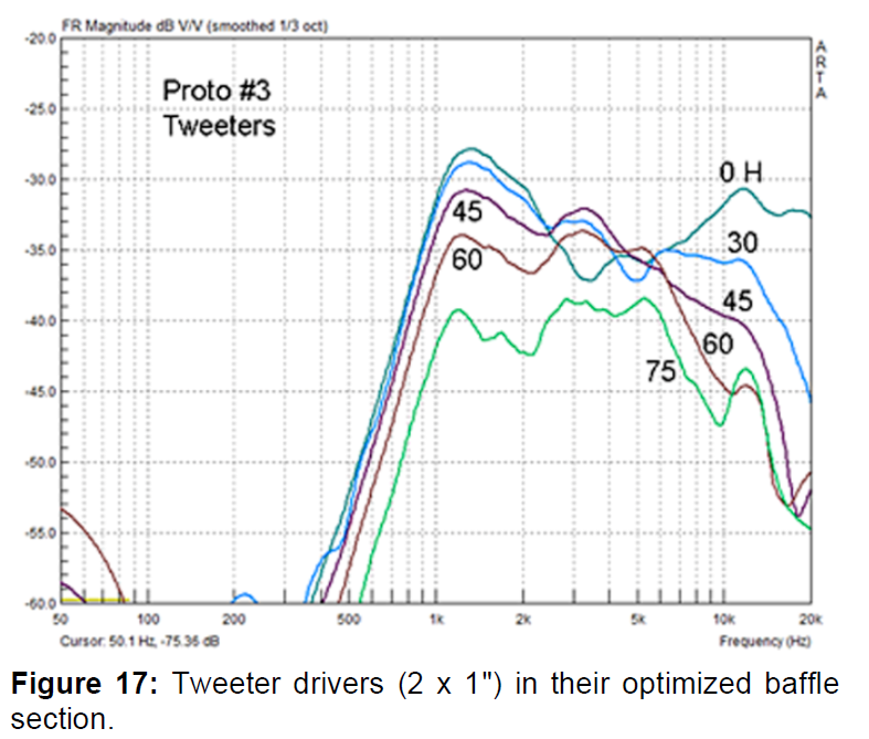

Thanks to forum member fluid, I happened to read the following a paper by Linkwitz in which he talks about his LX521 speaker:
https://www.linkwitzlab.com/IJAETv2n2a2-Linkwitz-1.pdf
If you look at page 123, section 4.1.4 Dipolar Tweeters, he has this to say:
Radiation from front and rear tweeters interacts in
space forming a radiation pattern with sound
cancellation in the plane of the baffle and a dipole-like
angular dependency, Figure 17. Below 2kHz the baffle
is acoustically small and a true dipole response results.
Above 5kHz the inherent directivity of the dome drivers
takes over. Front and rear radiation only interact at
large off-axis angles. An LR4 crossover at 7.5kHz was
chosen to combine the tweeters with lower and upper
midranges.
Figure 17 shows the on and off axis response of the pair of tweeters he chose to use in the LX521. These are small flange 1" dome tweeters, and he installed them on opposite sides of a narrow baffle, one elevated above the other.
As you can see in Figure 17 (attached), there are some significant problems in the 2.5k to 6.5kHz frequency range. Above this the tweeters are getting directional and their output does not see the baffle, and from what he (SL) told me this is why he chose the 7.5kHz crossover point. I think he would have liked to use a lower one, but could not because of the response issue.
So, with my back-to-back "el cheapo" (to quote Juhazi) dome+waveguide tweeters I have been able to avoid this sort of problem completely. I think it is pretty novel in this regard.
