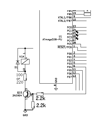

I hope that it will be useful to at least a few other people. The diodes serve two functions, and admittedly they are not a particularly great solution. They drop some voltage, which is useful since the relays are being powered by + 15V, even though they are 12V relays, so any little bit of voltage drop is welcome. Additionally, I have had issues where logic devices have an off voltage that isn't 0 V. It has caused me a few issues in the past, though it's probably better to just use a resistor rather than diodes.
...powered by + 15V, even though they are 12V relays,
I have had issues where logic devices have an off voltage that isn't 0 V....
A couple hundred ohms to the relay gives the 2.9V drop you want.
The low-level for TTL (ancient technology) is 0.8V. So a naked transistor "can" turn-on for a "low" level. A diode (or a Darlington) works. But the usual technique is a resistor voltage divider and pull-down. You can even buy transistors with this network built-in.
