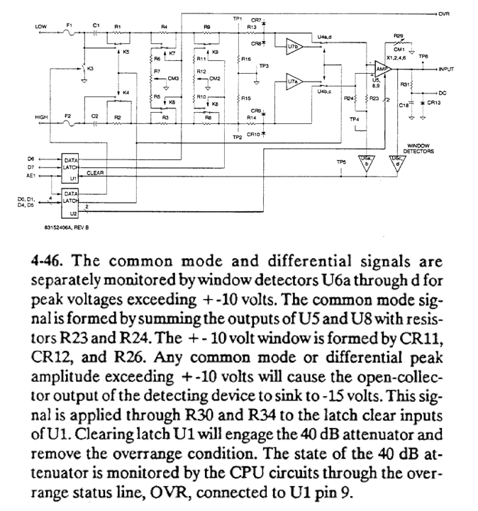

I thought this description of the Boonton input overrange circuit would be helpful. Especially since it uses LM339's. In principle you want an overrange trigger that is essentially instantaneous and a down ranging circuit that's slow to go downrange. 3 sets of comparators could handle the task. Overrange, above range and below range.
A simple up/down counter plus something like this could handle the ranging. 10 dB steps would be a better way to exploit the capabilities of a soundcard ADC.
I don't think you need to make any special bypass for ultra low distortion. The Boonton with opamp upgrades is already at about the limit of the Shibasoku 725's measurement floor. Which is below that of any ADC's I have tested.

From what it sounds like the Boonton uses the window detectors only for the 40 dB attenuator, and the rest are controlled by the CPU. Is this the case?

It occurred to me that it is worthwhile to sense common-mode voltage for the auto-ranging attenuator the way the Boonton does. That is now shown on the schematic.
I was a bit hesitant to add this because it does add a fair bit of complexity, and I struggle to come up with a situation where a an AC common-mode voltage of high enough magnitude to justify switching ranges will be present, but it only adds one chip to the board.
