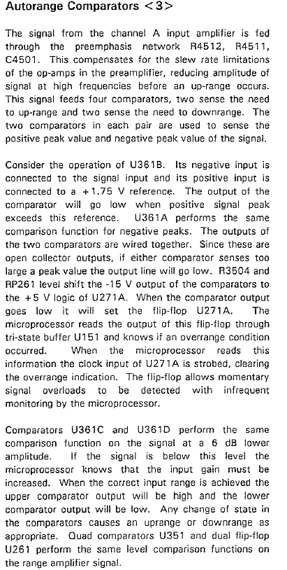

The Boonton uses an LM339 to sense peaks and a latch to scale up. Some simple logic could probably work OK with an up/down count for the level. The HP8903 schematic is pretty hard to follow so I'm not sure how that's done.
The AP system one uses the process attached (clipped from the sys 1 manual.).

It also occurred to me that you could use the single-ended diff amp output downstream as the sample point for auto-ranging. The input will momentarily overload whether auto-ranging operates feed-forward or feedback. By having the detector sample from the final single-ended output it doesn't load the input and can be tailored to keep the INA ahead of it in its lowest-distortion sweet spot. You also don't need a differential input for the detector.
The primary challenge with the peak detector circuits that have been discussed so far is that they won't work great at low frequencies without making the range switching unacceptably slow. I can think of three solutions.
1) Live with it. Relay chatter might be an issue at low frequencies, so testing below some frequency (maybe 60 or 100 Hz) will require manual ranging. A manual range override would therefore be provided.
2) Use a true-RMS detector IC. It will be inaccurate for non-sinusoidal signals, but maybe that doesn't matter since 95% of the use case for a device like this is sine wave testing. If there is a need to look at the spectral content of bizarre waveforms, one could always use the manual range override.
3) Throw a microcontroller and an ADC at the problem. This one is the least satisfying to me, but I would be willing to entertain the idea for the sake of an experiment, particularly if other solutions prove to be unsatisfactory. Atmega328s are about $2 and can be programmed using an Arduino for those of us who are "digitally challenged". They have a 10 bit ADC built into them. They also have a PWM output that could easily be filtered to drive the comparators. I know that one could eliminate the comparators entirely with the microcontroller, but this brings me to my final point with this.
