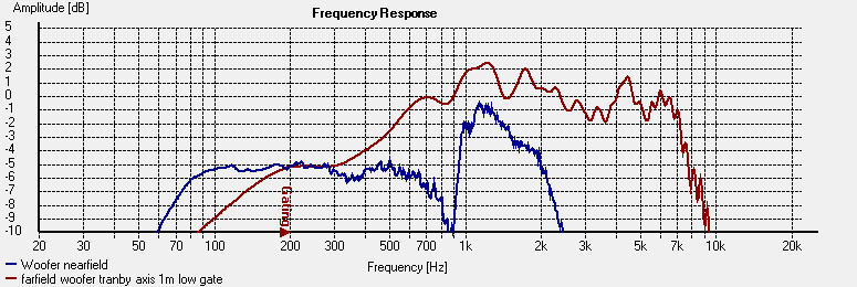

Measurement approach, 2-way closed box
Regrettably, the HolmImpilse manual is not to detailed..
But after messing around a bit, I figured out the "match" function under the "manipulation" tab.
I chose 250 Hz for the centre matching frequency and a width of 100 Hz. This means that the program matches the signal level between 200 and 300 Hz.
You could of course do this manually by adjusting the dB offset of the two curves until they intersected at the desired point, but i found this function kind of neat. For this excersise, it is of course advantageous that the two curves to be matched has a relatively flat response in a range where they can be spliced.
This is why I wanted to get the far field measurement to extend reliably down to the expected "plateau" bleow the baffle-step roll-off.. or should i say roll-up? 🙂
Anyway, here's the result:

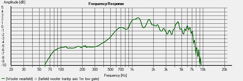

And now for the final wrap; turning these two curves in to one.
Again, HolmImpulse has a neat function called "stitch" under the manipulation tab.
This is very similar to the "match" function, you choose the centre frequency for where you want the splice,and the "width" of the splice. To me, it seems that within the width chosen, the two curves are averaged together to give a smooth transition.
I cose 250Hz and a width of 50 Hz.
But nothing happened!!??
Why, of course, the new spliced curve was obscured by the original curves! Hide those and the new spliced curve is there! come on, don't say I'm the first one to scratch the brain box over this one! 😀
Et Voila!
So, what can I do with this alpine landscape then?
the curve looks rather rough, but then again, I set the resolution fairly high in order to have a close hard look at things..
Baffle step.. This tells me that the baffle step starts to roll up at about 300 Hz.
Looking at the aforementioned SEAS plot, this one suggests that roll-up starts at 200 Hz. As opposed to the 12L measurement box, my box contains some bracing, bitumen-sheet lining and additional lining with 12 mm "armaflex" foam to increase cabinet transmission loss. Despite the acoustic stuffing, this might rise the box Q a bit lifting the LF shelf a bit.. or it's just the measurement! *s*
Anyway, the discrepancy is hardly dramatic.
Now, where does the roll-up stop?
Again, the SEAS plot indicates around 1k.
Now, this is where things get a bit ambiguous.. My measurement rather suggests that the roll-up stops at around 700 Hz, followed by a bump at 1k.
The baffle step sim I did, predicts that the roll-up is continuous in to a 2 dB peak at around 1k.
First question: why is there no pronounced 1k peak in the SEAS plot??
I went back to the baffle sim and move the woofer closer to the bottom edge corresponding to the SEAS baffle. Well, the peak dropped, only by a dB or so, but it also became less sharp. I guess this observation combined with some measurement inaccuracy could at least partially provide some explanation.
It also tells me that I would have been better off placing the woofer closer to the edge, but I don't really feel like scrapping those boxes right now! 😀
Back to the issue of baffle step correction;
Should I consider a slope between 300 and 700 Hz, or up to 1k??
Now this is where I invite learned men to look at the curves and speak their opinion! 🙂
