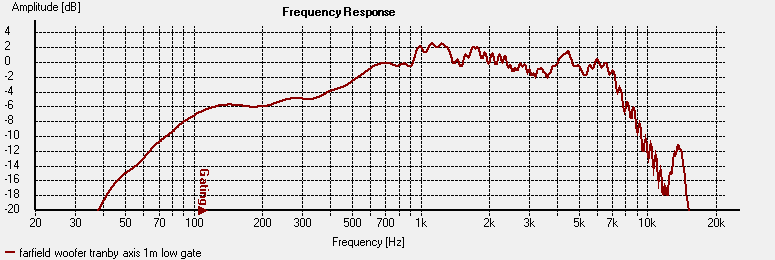

Below is a plot showing 1m on axis measured in the workshop, where I have increased the gating time until I got a clear "low-frequency shelf" giving me some confidence regarding the start and end of the baffle step roll-off.
Assuming for the time being that this is a valid measurement (those of greater knowledge might yet again step in and correct me here!), I hope to use this for calculating a baffle step compensation slope. The actual level of baffle step is something I intend to establish by measuring actual room response with the speakers placed as they will be used.

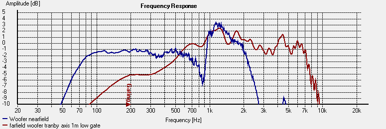

As for distortion measurements, The original SEAS data-sheets have this, and I don't really expect this to be too different in my design. Besides, I only have a 50 dB measurement range with my set up at home. In the workshop this dropped to 30 dB due to background noise from machines and ventilation.
Finally, I think it is interesting to compare this with the original SEAS data-sheet plot, there seems to be a correlation.

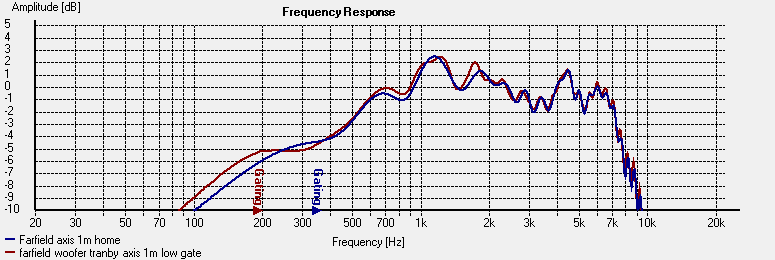

Now, I have some measurements for which I feel reasonably comfortable, perhaps time to start pulling things together a bit?
With an eye towards future x-over work and respnse shaping, which I hope to be doing in the relative comfort of my living room, I thought it would be a good idea to gauge a farfield measurement doen in my living room with the "farther" field measurement I did at the workshop.
I superimposed the two, and adjusted the gate-time for the home measurement until the plot matched best with the workshop measurement.
This should allow for some consistency further on .. I hope.. 🙂
This is what it looks like, the red curve is obviously the one from the workshop as it has the better LF extension.
