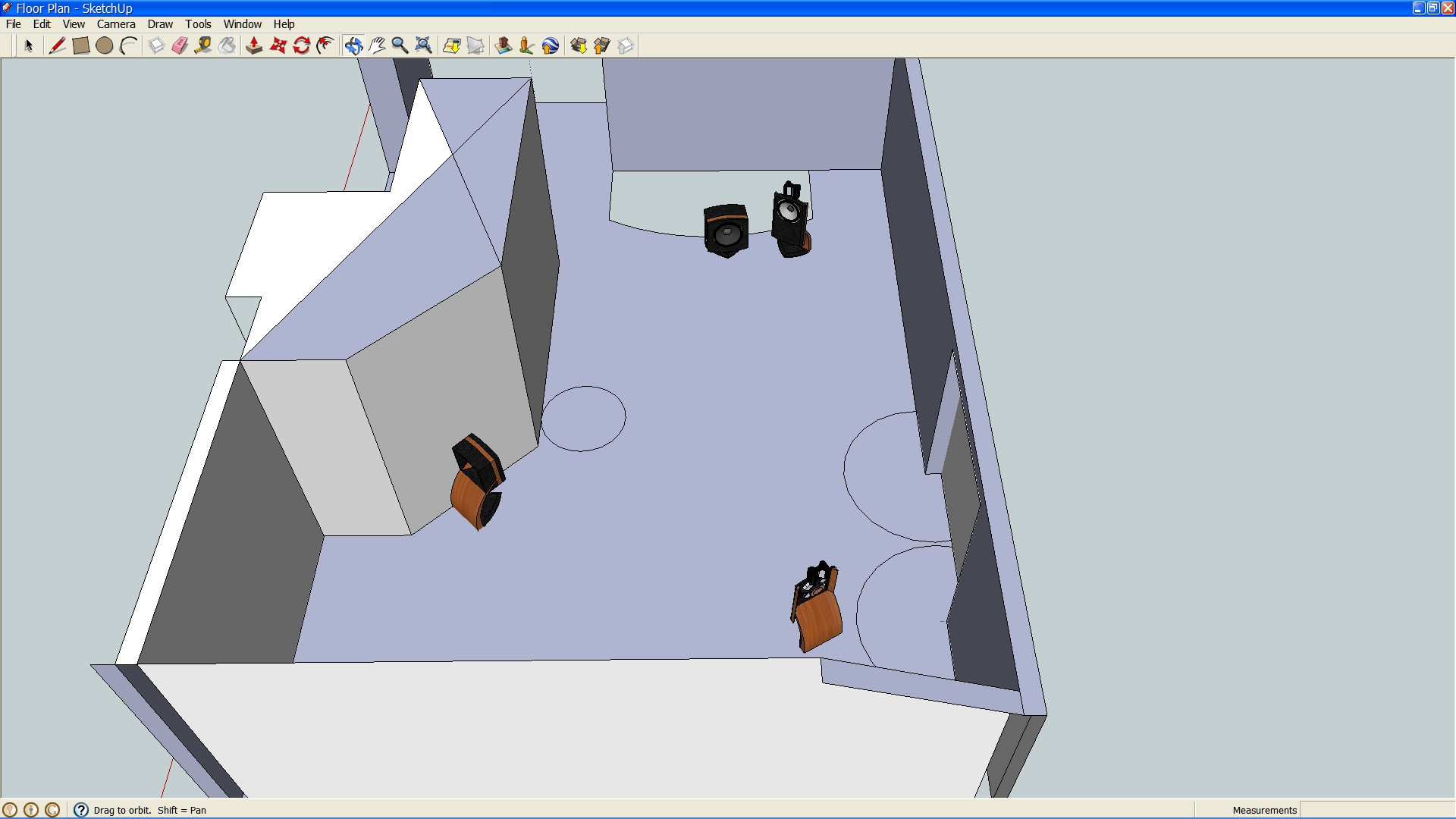

This is the basic layout.

Dipole, about 0.5m. Behringer 😱 😀
Single mono dipole? Orientation? What EQ settings did you apply?
Do you believe the mixer/master engineer intended the bass to be inside the head ? 🙄
Of course not and as I already said, I don't get in-head localization like you do. All I get is deep, clean, tight, fast, articulated, ultra-smooth bass - best signal modulation reproduction 🙂
Maybe you're running the sub too high? Or it produces too much noise/distortion.
Didn't you find the smoothness of the frequency response quite enjoyable?
