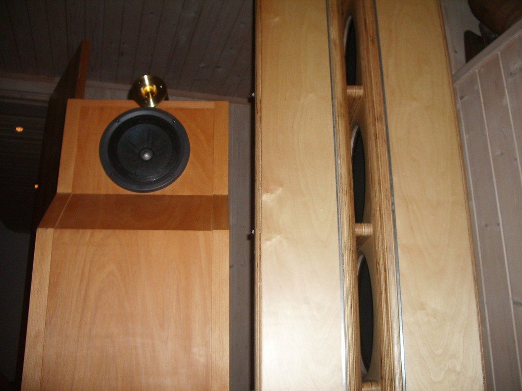

I have just finished building a set of slot loaded open baffles, comprising of 10 x 15" drivers pr. side - these are up and playng in my 400 sq.ft.++ (40m2) regular basement room, concrete floor/walls insulated and panelled just like a regular living room. NO room treatments of any kind, just sensible placement of necessary furniture, and equippment. The room is a dedicated music room though, so care have been taken to have symmetry on everything from the speakers rear wall to well behind the ears of the listener...
This is my third large format OB bass system, and it is WAY better than anything else I have ever heard.
Top class bass for playing regular music (ridiculous surround-style foundation shakin' "bass" is of no interest) is definitely possible with OB, it is just a question of scale, quality of drivers and enough space around the speakers (and a couple of other clever tricks
And slot-loading DEFINITELY has quite a lot of directivity at least at a certain distance; the amount of energy hitting you in the sweet spot is downright scary.
To my ears, dipole bass is difficult to integrate with monopole subwoofers. I've tried it many times, and every time the monopole sounded "different" than the dipoles. Hard to describe, but its a different type of sound.

Did you ever build this kind of construction in this scale yourself? I have all the mentioned systems here, and there is a very marked difference in the directivity between those regular OB's and the slot loaded version. No question. This is also usually the first comment from other listeners - some 10-12 seasoned audio friends happened to mention this particular feature. Move a foot to the left or right and it changes caracter. Listening distance is about 10 ft. right now - I can relate to your theory when we increase the listening distance but at 10' I have to relate to our EXPERIENCE rather than theory.
Mind you, this particular "concentrated energy field" was not on my mind when designing the whole concept - we just discovered it during the first listening session.
If doing SLOBS is wrong I don't wanna be right.

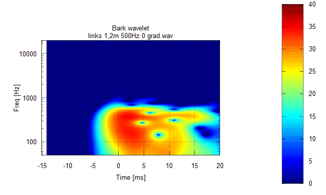

If one would do equalized or normalized comparisons, then time-domain ringing would be the only (possibly) remaining difference between the three source types, right? It would be interesting to see if there would be any significant difference in ringing (because of 'less' or 'fewer' mode excitation).

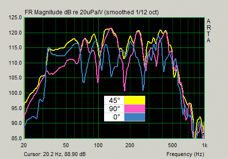

I’m still riding my hobby horse … the dipole woofer directivity.
It is obvious that we don’t see a figure-8 pattern below the Schroeder frequency. But the excitation of individual modes can change dramatically when the dipole source is rotated.
Measurements were taken in a 4 x 5 m room with “hard” walls except the front wall, which is a slanted ceiling in the upper half and a knee wall below. The H frame is 1.30 m from the front wall and 1.10 m from the side wall. The microphone was on the 45° axis, about 1.30 m from the H frame. 0° is along the 5 m length, 90° along the 4 m width of the room:
You can probably imagine why I choose the 45° alignment. I have processed those three impulse responses through Elias’ Bark wavelet analysis.
It is up to everybody to see for himself if it does make any difference in the time domain "ringing".😉

But wasn't exactly that one point Earl was mentioning that there is virtually no directivity in small rooms at LFs ?
One always has to consider the bandwidth that is being talked about. In the modal region directivity cannot exist, but above the Schroeder frequency it can. If the bandwidth is such that it encompases both regions - as it almost always does for dipole speaker systems - then one cannot easily determine if the sound quality difference is due to the range below fs or above. So lets say that a dipole system is deemed to "sound better" (and I for one am not ready to accept that premise as unconditional) then it could be the differences in the "directional possible" region or it could be the other region. We just do not have any data (that I have seen) to make that determination.
I have said that, on paper, a dipole has an advantage from 125 Hz up to about 500 Hz, but dipoles also have disadvantages as well. I consider these two octave to be just about the least important perceptually so it becomes a real mixed bag as far as a dipole being the ideal. From the examples that I have heard, the dipoles did seem to be very good in this region, but thir poor performance elsewhere left them lacking IMO. (And no I won't point out the specific dipoles that I have heard - they were well regarded however.)
But to me that means that there are leftovers from directivity, no ?I’m still riding my hobby horse … the dipole woofer directivity.
Yes, I was quoting you with <125Hz in mind.One always has to consider the bandwidth that is being talked about.
And thanks to John for the measurements and time time you have invested !🙂
Yes, that is correct. The more overlapping modes that get excited the more the "pattern" can begin to converge on the dipole or cadiod. At very LFs where only a single mode typically gets excited, the wave in the room can only follow the direction defined by that mode (its mode shape) . As more and more modes gets excited then the wave can move in more and more directions until at high modal density the wave can propagate in an arbitrary direction.
It depends on how we define directivity. In my polar measurements I can clearly see the figure 8 above the Schroeder frequency and several distinct mode frequencies below, which are individually more or less excited depending on the rotation angle. Of course some modes (diagonal/vertical) are less or not susceptible to rotation.But to me that means that there are leftovers from directivity, no ?
I really wonder if a "prepared" room like John's or Earl's would show less change of room modes with dipole woofer rotation.

I'll be taking some additional measurement today. I'll look at rotating the dipole. But remember, rotating the dipole changes the location of the sources. That will change the result.
Thanks in advance. I would have thought, that any of your dipoles would be a point source below the Schroeder frequency. 😉But remember, rotating the dipole changes the location of the sources. That will change the result.
My dipoles were on a lazy Susan while being measured from 60 cm distance in the room:
I think above diagram looks like a textbook example 🙂
