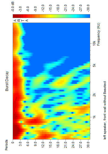

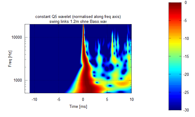

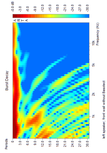

John,
your Arta burst decays may be good for detecting driver resonance issues, but they are inferior to Elias' methods when you want to see room dependent timing issues. You may compare my diagrams, which show the influence of some front wall absorption http://www.diyaudio.com/forums/mult...resentation-loudspeaker-room-interaction.html:
In the above diagram you can clearly recognize the attenuated front wall reflection at 7 ms. This is much less visible in the Arta burst decay diagrams from the same IR measurements:

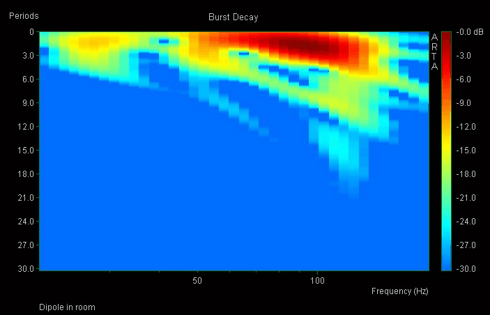

Ok, here we go:
Near filed of the monopole source. All sources would have this anechoic far field axial response.
Frequency response:
Burst response in CSD form:
In room 3 meter measurements. Same mic and source positions as before:
Monopole:
Frequency response:
Burst sonogram:
Burst waterfall:
Dipole:
Frequency response:
Burst Sonogram:
Burst waterfall:
Cardioid:
Frequency Response:
Burst Sonogram:
Burst waterfall:
Overlay of frequency responses:
Note that since most of these figures have the same names as the original ones, they will appear in my original post. SO DON'T GET CONFUSED. 🙂
Frankly the only noticeable difference is in the frequency response. There are some differences in the burst sonograms as well because of choosing a different plotting option.
FWIW, from my perspective my conclusion remains what it was when I first designed the CRAW, cardioid woofers just seem to work a little better. [edit] With regards to frequency response and sensitivity to position.
[edit] Apparently the original figures are still displayed in the original post (#376 on page 38). I don't know how that works being that I deleted the originals from my site. I guess nothing on the internet ever really goes away.
