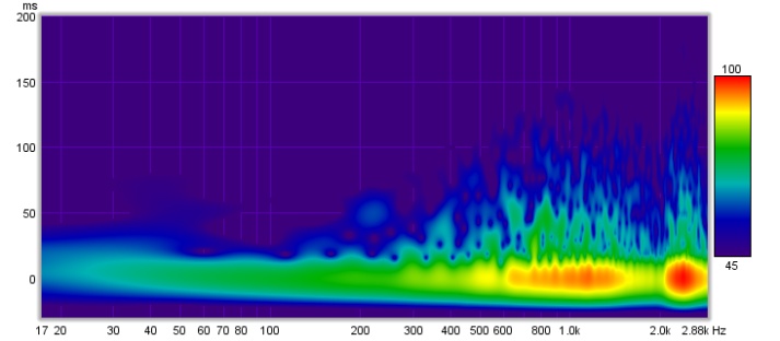

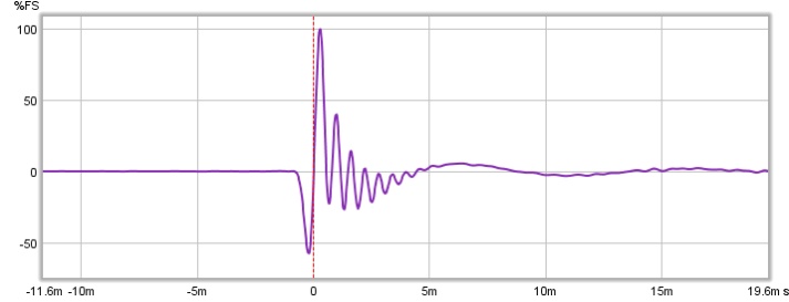

Markus:
In post #530
What are microphone distances?
Windowing for spectrograms is too large and 30dB range is too small; can't get much from this view.

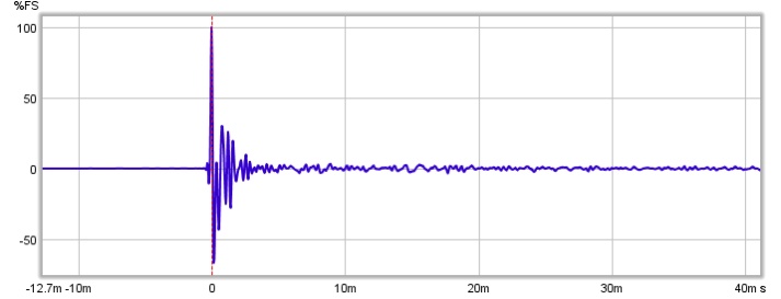

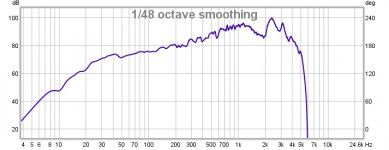

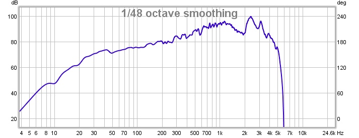

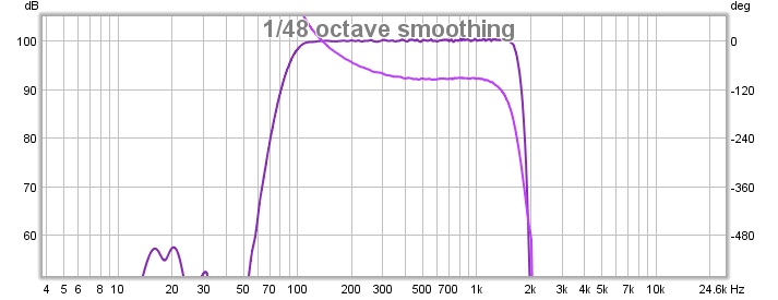

Here is 10" Peerless driver suspended 30" from carpeted floor, and >5ft. from walls and ceiling. Microphone is 30" above floor, and 30" from driver:
Frequency response:
Impulse response:
Spectrogram:
Spectrogram windowing is 60ms, Blackman-Harris 4
Inverse transfer function is generated from IR, band limited with FIR and minimum phase version generated of this inverse.
These inverses are applied to measurement sweep by convolution, and used to measure driver. Microphone and driver are undisturbed from initial measurement. Sound of sweeps during response recordings are smooth, audibly there is no reverberant/echo effects produced by inverse functions.

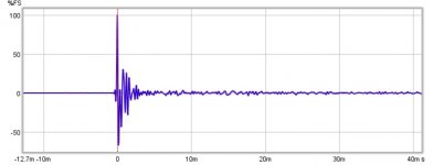

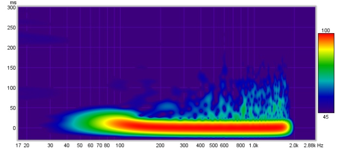

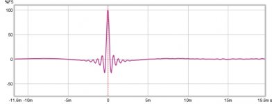

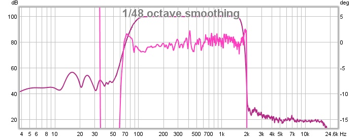

Results of linear phase correction filter:
Frequency response:
Impulse response:
Spectrogram:

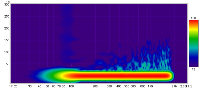

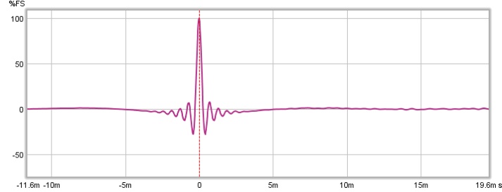

Results of converting linear phase filter to minimum phase filter:
Frequency response:
Impulse response:
Spectrogram:

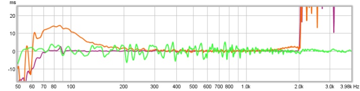

REW has nice group delay feature; overlays of GD for raw, linear phase EQ, and minimum phase EQ:
As usual, minimum phase filter is ruinous to group delay performance.
Andrew
