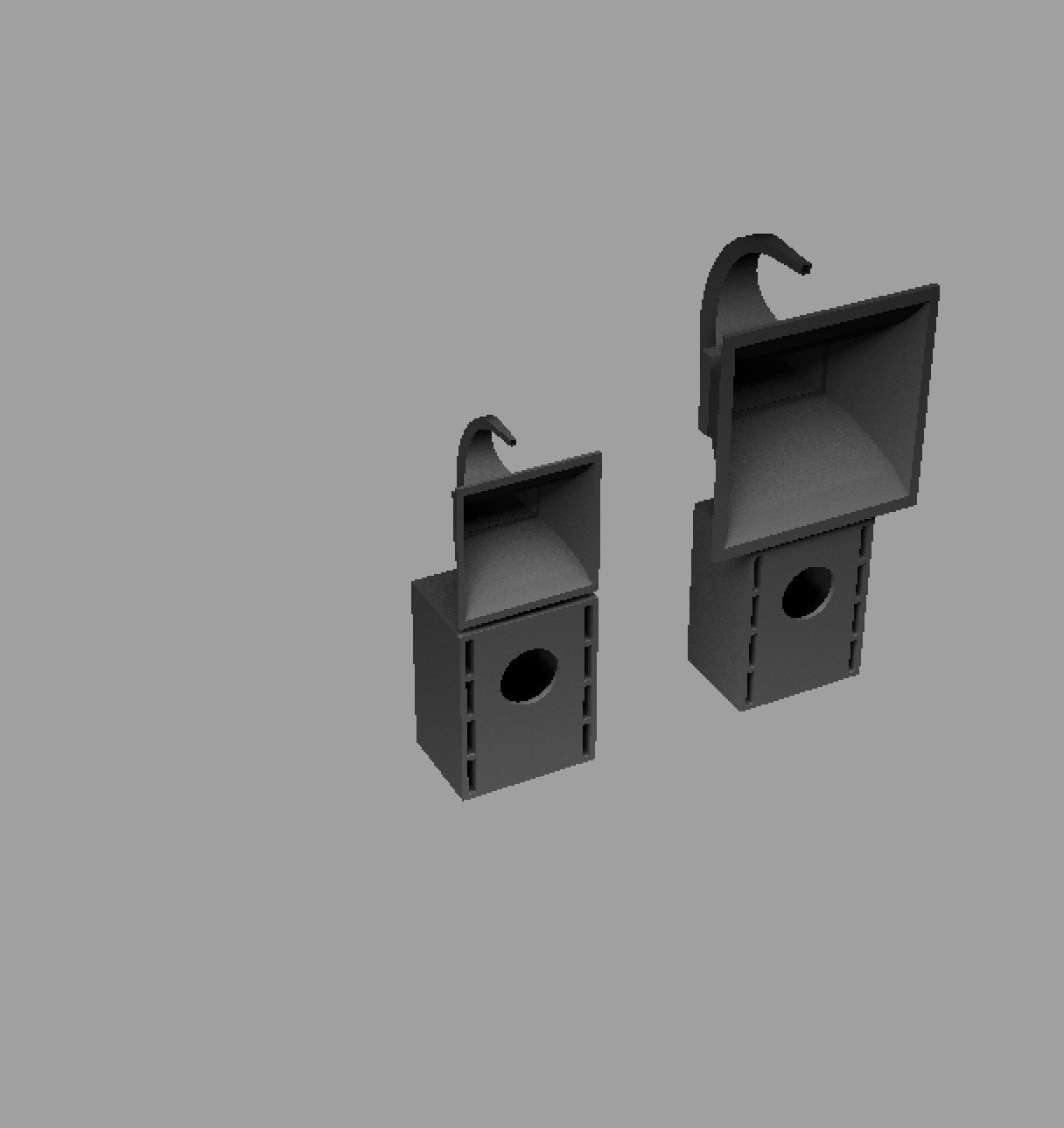

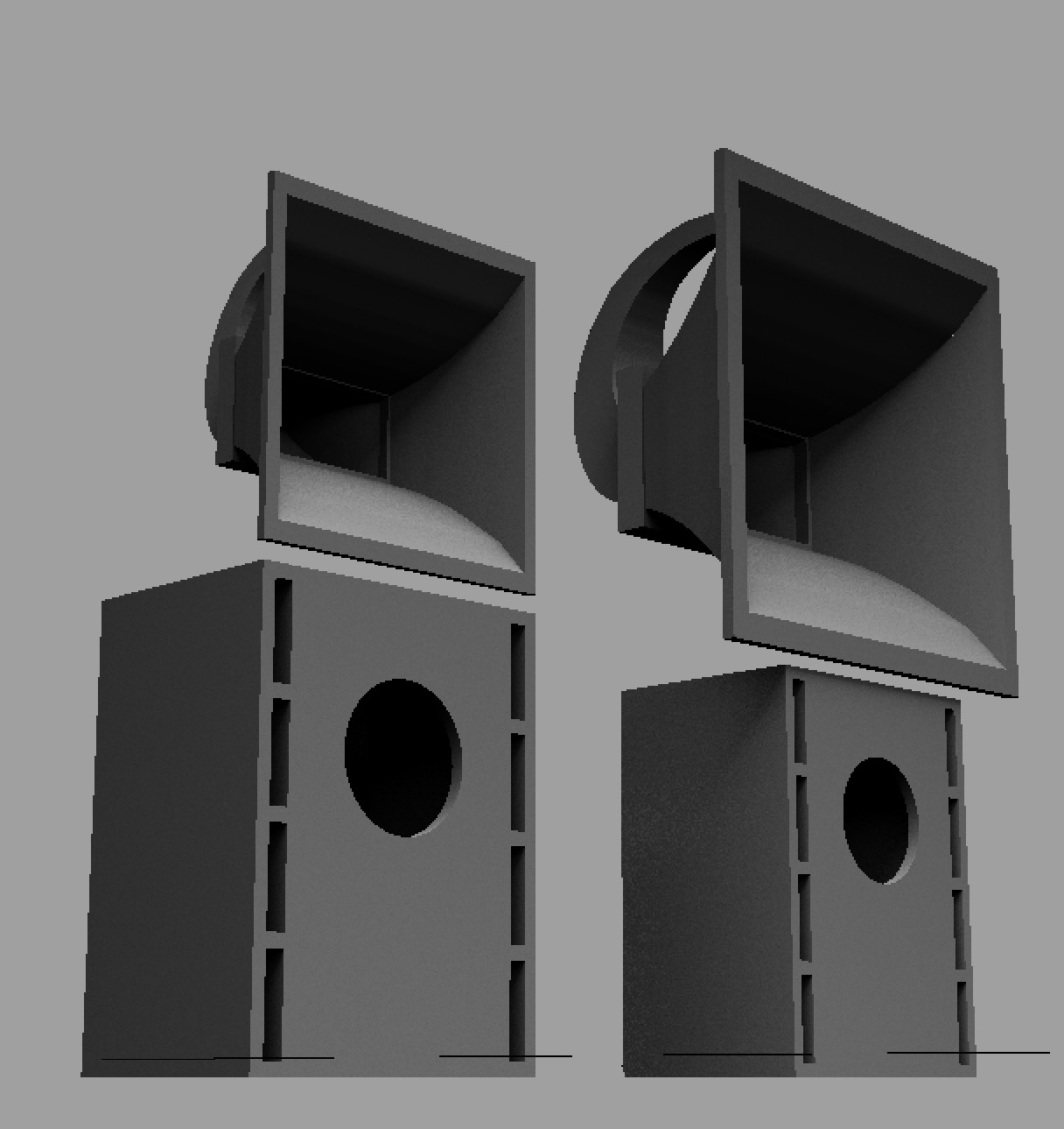

I´ll post it here... ( was considering a new thread - but since I have not followed up this thread I find it correct to post my topic here )
OK - so I have NOT built any 360L Onkens....
, but I am considering the smaller version:
La petite Onken (J.Hiraga)
I have sold my Duplex 604E´s.
I was wondering how difficult to scale down the SATO horn to the dimensions of the front dim. of the smaller Onken.
SATO horn:
Le systme de Mr Sato (J.Hiraga)
Is it possible?
- or am I way over my head....
... already drawn the la petite Onken box with the original SATO horn ( huge ! ) and with a scaled down version.... see pictures attached.
