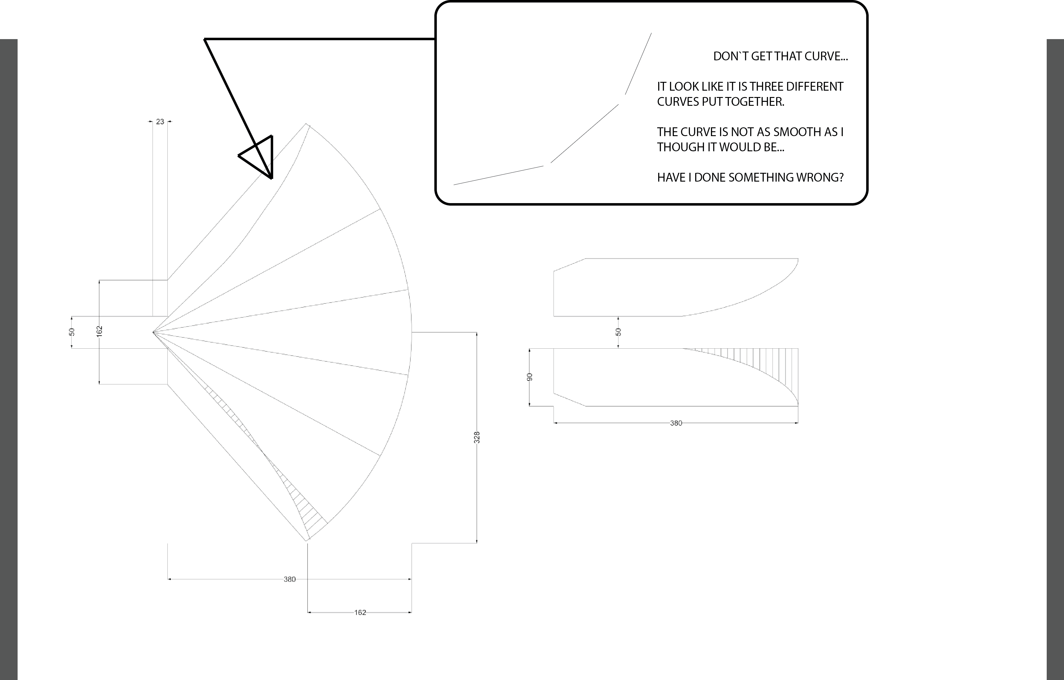

Hey all ..
two questions....
Could someone with knowledge about this certain wood horn:
*is the curve correct on the Yuichi A-290 Horn on my drawing ( see attached drawing ) ?
**what driver(s) should I consider for the A-290 Horn?
- - - - - - - - will the EV DH1A driver work until I get ahold of a better one?
two questions....

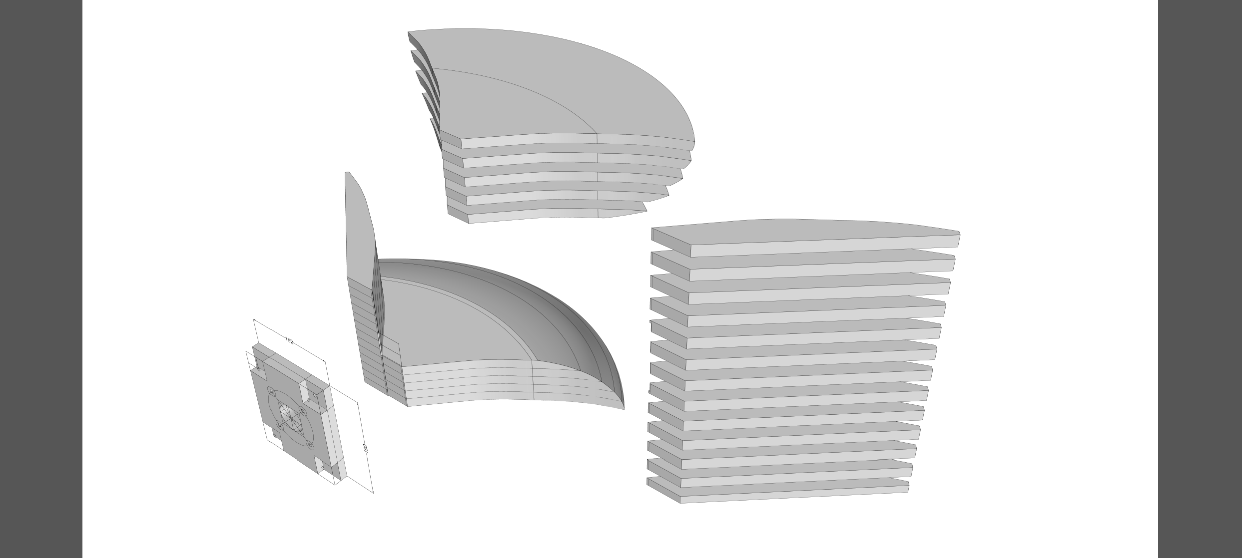

I´m quite sure the drawing is correct. I see on this page : Wood Horn
- that the pictures of the horn has the same type curve as the drawing that is attached in my previous post.
