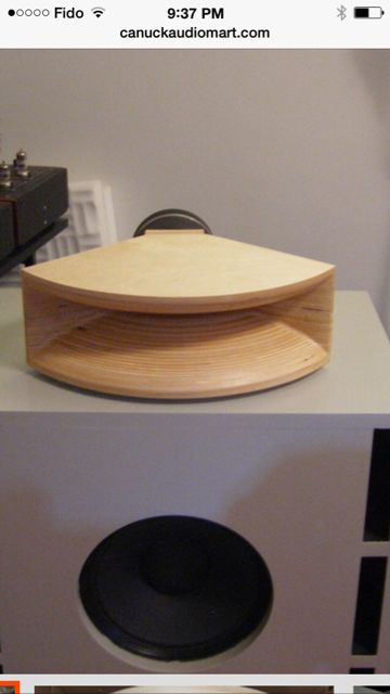

Here is the link for those interested: http://www.canuckaudiomart.com/details/649172748-wood-horn-kit-for-tad-jbl-radian-faital-etc/
Very nice looking horns!
511s should be easy to beat (yeah, haters gonna hate) but I am sure these are a great step forward.

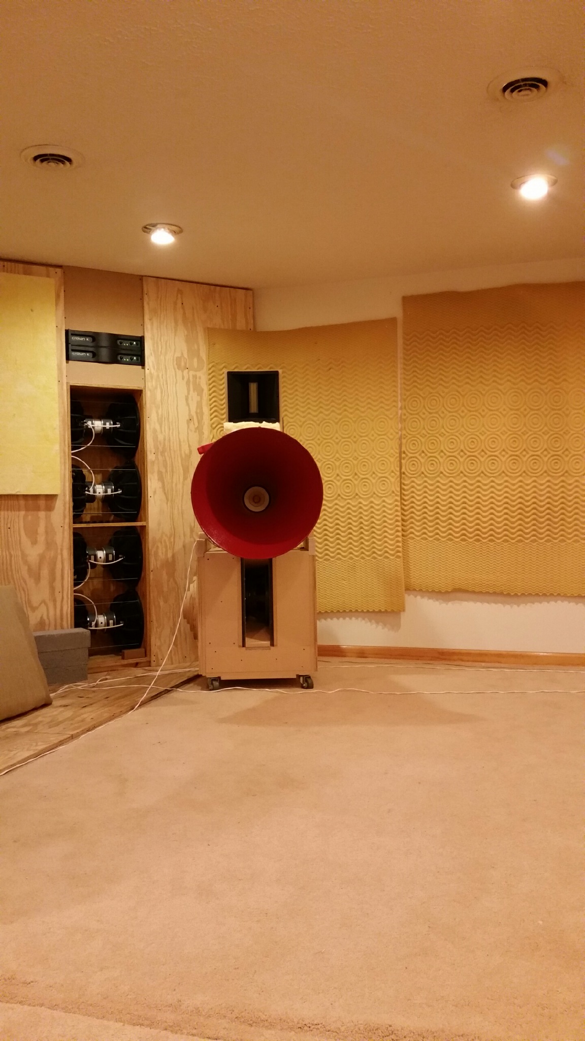

My way of joining into the fray 🙂
Tell us more about components. I see a cool in wall PP slot loaded sub. I also see a PP slot loaded sub on casters. A pleated diaphragm tweeter in a horn and some sort of Fostex or Lowther in a bi mid horn.
The in wall sub is cool - why did you not flip on driver magnet in so that you can reduce mechanical hysteresis induced second order harmonic distortion?
The in wall, infinite baffle is a push-push to cancel out any vibrations. I built that back in 2010 before I was introduced to the concept of ppsl, which,
the mid bass (woofers) are. The ppsl cabinets are made out of double thick
3/4 mdf for a total of 1.5 inches thick. That's why they are on casters.
Double thick mdf construction is the only thing sort of generic to this thread.
The large round red horn is loaded with a Tang Band w8-1772. The large tweeter on top is the Stage Accompany SA 8535. All the drivers except the subwoofer section are time aligned. It's an active 4 way using a custom built
analogue 18db/oct crossover. Subwoofer amps are Crown K2's, Bryston 7B's run the mid-bass, a custom tube amp runs the mid range, and a highly modified Parasound HCA-1000 powers the ribbons. The subwoofer drivers (eight units, 4 oppsed pairs) are Acoustic Elegance IB-15's loaded into approx
500 cubic feet. The mid-bass each contain a pair of Eminence Definimax 4012-HO.
