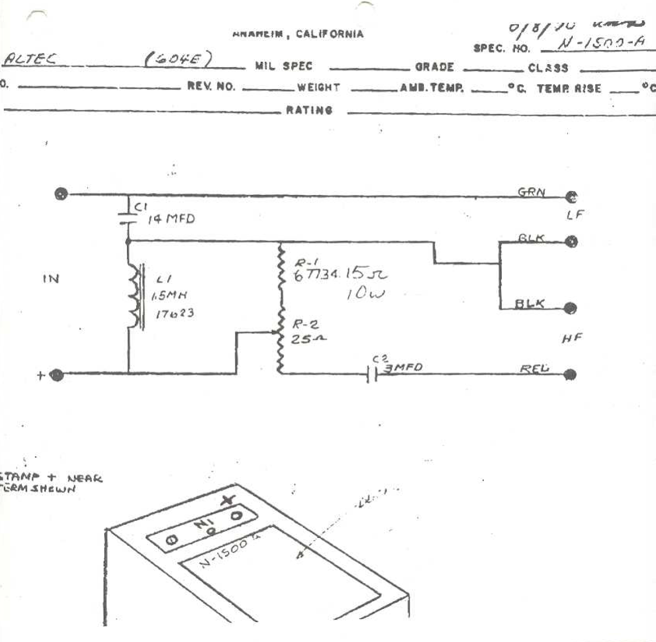

Please fill me in on the problems regarding the crossover :
The thought did strike me when I read about different "optimal" crossover frequency when using the ONKEN cabinet than what the N1500-A crossover does for my Altec 604E.
I have today a DIY version of the N1500-A crossover
Schematics attached.

You are facing a totally different scenario with 604s vs. 416s and a midrange horn.
You have to run the bass up to where the horn cuts out, at least 1.5k
N1500 is a decent textbook solution but I recommend looking into advanced thinking on the problem. I believe that Hiraga's xover is derived from the Urei "afttermarket" xover....not sure about that.
I tried lots of experiments with various 604s trying to get them to play as well as a 416 + discrete horn with no success but for the 10 minutes I heard Hiraga's coaxes in Munich I was soundly impressed. Very coherent and a huge dynamic sound.
Basic problem with the 604s in my interpretation is that both the horn and woofer are stretched outside their optimal ranges. Beyond that there are time alignment issues (addressed by various crossover designs over the years) and the constructional facts that the horn is right in the way of the cone and felt is glued to the damn cone behind the horn...making the crossover region even more tricky.
Good luck. I think it can be done.
Maybe I'm being picky because a lot of people love 604s but I'm sketching it out for ya as I see it. Hope the comments are of some use.
Study up. Lots written about 604s.

No knowledge of JH's XO beyond that he had done one, though it's more likely to be 1600 Hz than 600 Hz...........
Note that Altec XOs in general are optimized for high power apps and studio monitor apps in particular, so a high XO point + loading cap on the HF driver is mandatory, which is intolerable [to mine and some others ears] at the fractional power these normally operate at in a HIFI/HT app.
It's been several decades since I dealt with the 604E, the last model I've any 'hands on' experience with, so with all my notes gone AFAIK that ultimately led me down a far different 'path' than what's considered 'proper', theoretically 'correct', etc., I'm reluctant to offer much in the way of XO advice other than that no 604 thread is complete without reference to Jeff Markwart's website: Jeff Markwart's Corner - Phase Corrected Crossovers and specifically: Altec Compression Driver Rear Loading Caps
