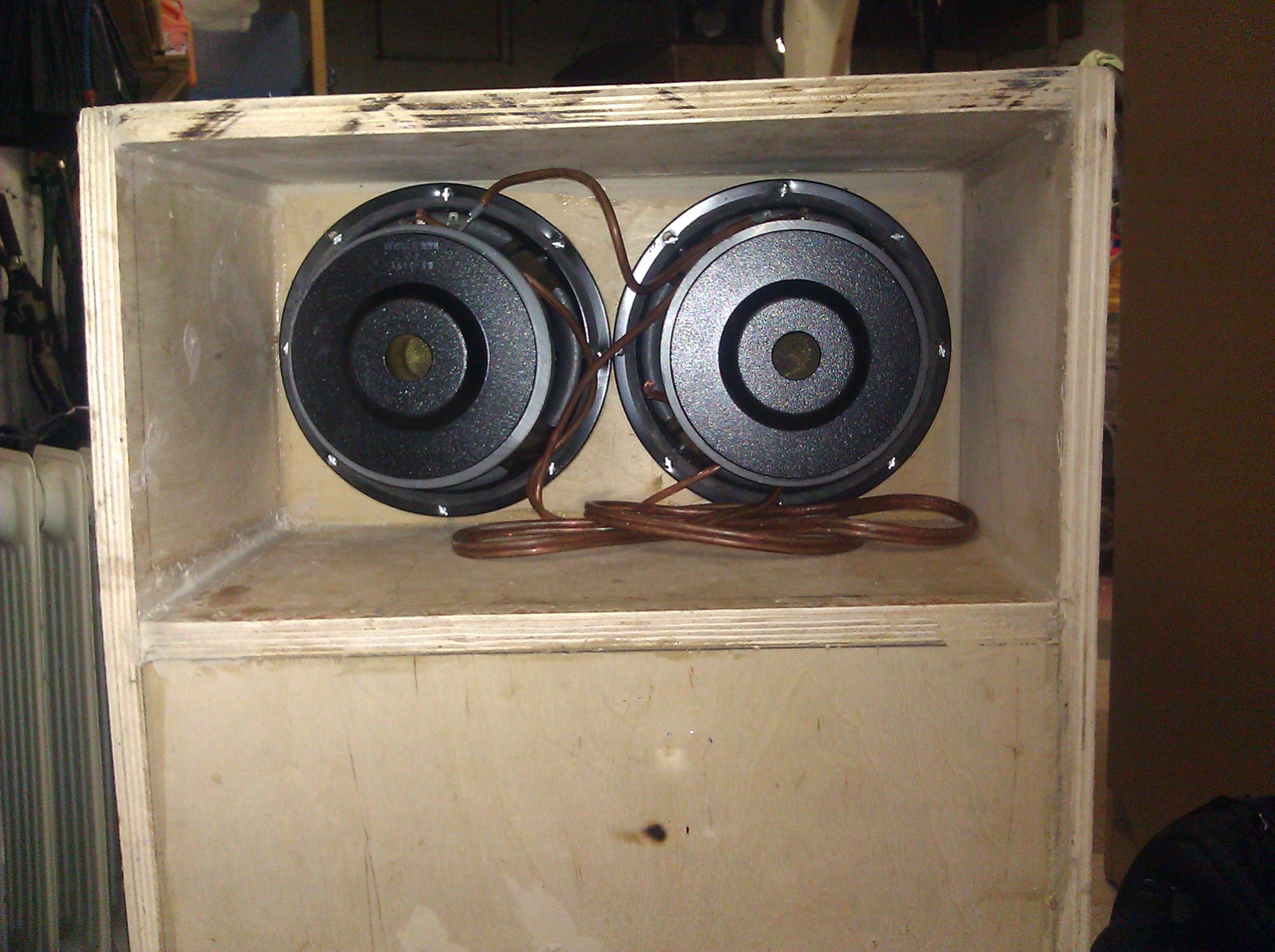

you can test without the lid ,(you lose some 35 hz )
I have some screw holes to seal before I fire it up.
i fired it up
So last night I ran some 35hz to a 100hz through the bass horn it sound so sweet. I also rrun a frequencey sweep through the bass horn you can hear the difference as the frequencey change. When I get the spl meter I will put up some numbers. This bass horn sounds really good for the size speaker it use.

measurments wood be nice for comparison,but the most importent question is ,do you like what you hear.😀

Yes I like what I hear. It sounds real good.
I will do some measurement for sure

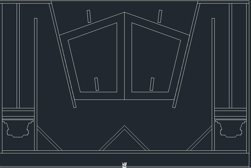

ive been simming a bit ,i think 46"h makes the horn mouth to small
is the widht oke as it is now?
you can make the width a little wider it is a bit tight when screwing down the speakers. 22" width should be good.

46" high isn't good ,the mouth becomes to small
basicly if you want 4 speakers in it wil have to become about twice as big as this one.
why not stack 2 of these on the side(or 3 or 4😀)
4 wil be 6' wich is perfect for tops over the audiance
wheels on this one and example with 4

what if we make it wider would that make the mouth bigger
epa;279346 i have a cold [/QUOTE said:epa how about you get better first then we continue.
yes but its stil 820 ltrs + complete redesign.
not imposible ofcourse but 820ltr cabs are a pain to move.
