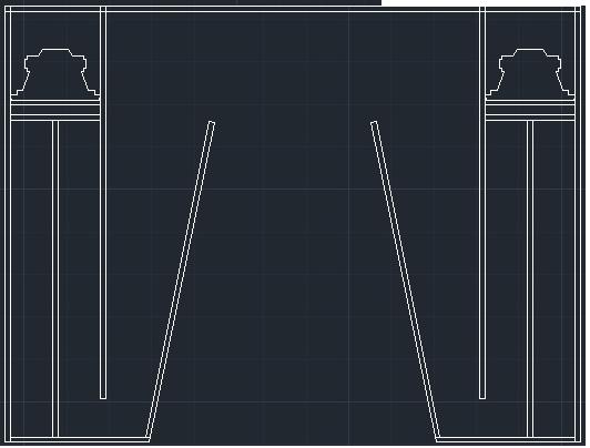

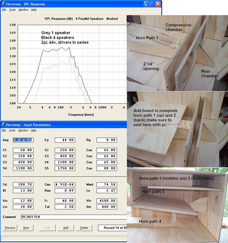

to get things clear,if you put the hr data from post 64 in hr,you should get fr graph of post 63, and thats is the one i moddeled.
Has anyone done any measurements on a built version of this to see if the response matches the predictions? I'm particularly interested in a comparision between the predicted and actual impedance response curves.

the moddel is a extended version of jbells mcm flh

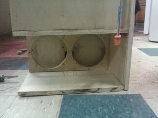

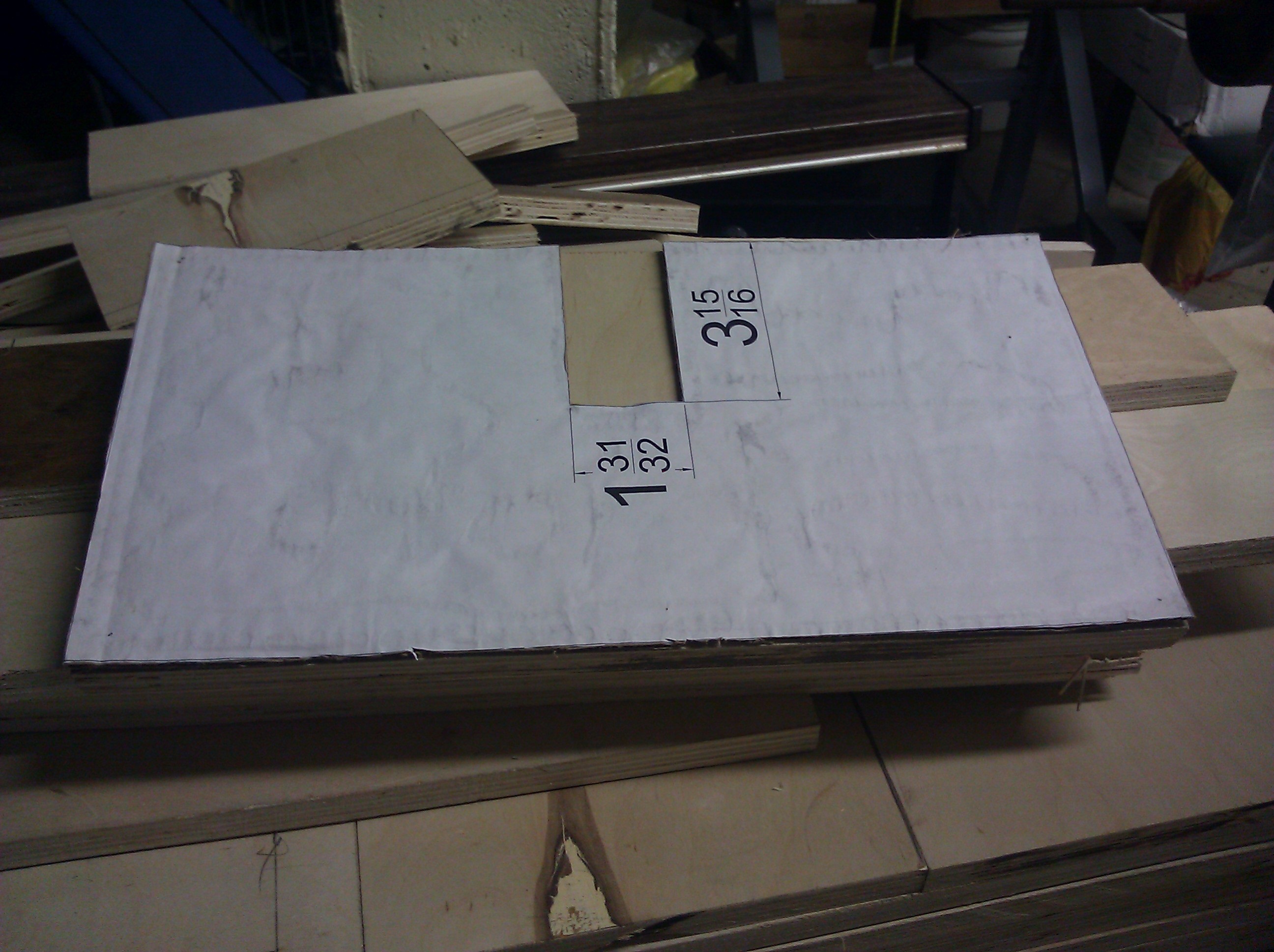

fitting speaker on baffle
Ok I want to mount both speaker on the baffle board but I am afraid the speakers surrounding might get damage when the cone is moving. Is they away to cut out the speaker hole on the baffle board that won't damage the speaker surrounding when the cone in moving.
measure the outside dimension of the surround(~7"),thats the size of the hole to cut
Ok I will try that.

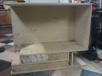

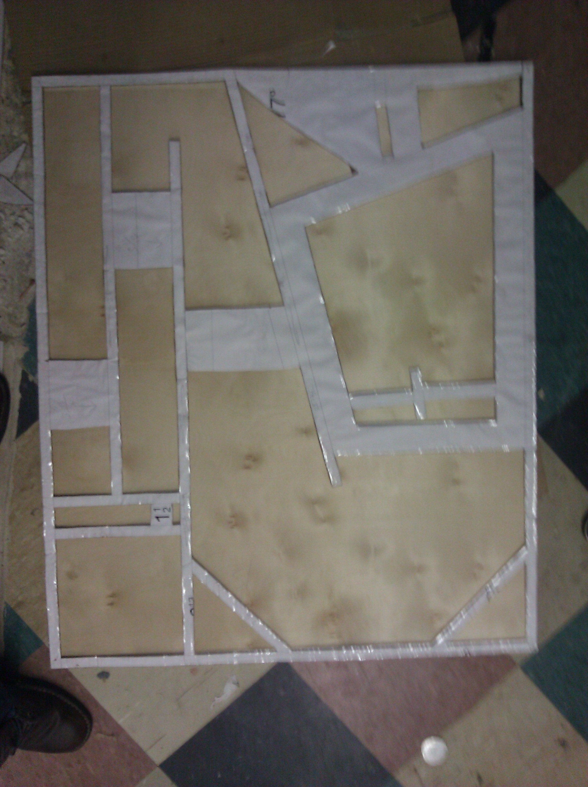

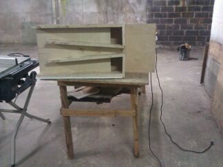

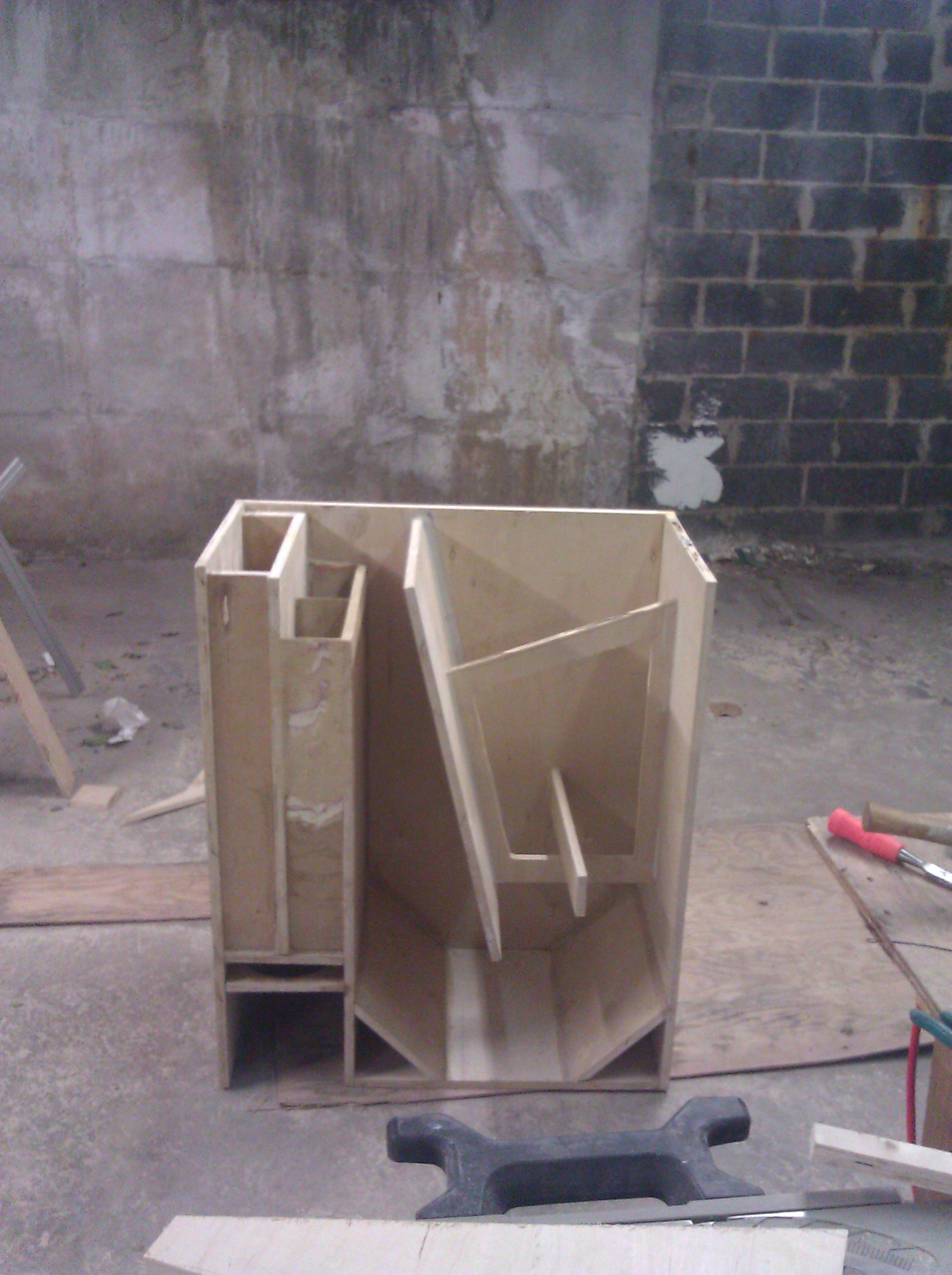

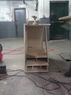

I am having a little trouble cutting out the speaker hole the right way.otherwise everything is going well, i would have finish it this weekend but some miner trouble stop us from finishing it
7" would be good - btw, the woofer has gaskets on both sides.
I know Epa told me, i think am doing something wrong. i will trrrrrry again later.
loo
i see you made the first section verry precise.😀
I tried, the first section is a bit tricky but we got it done and the box is not too big with handles i can left it by myself

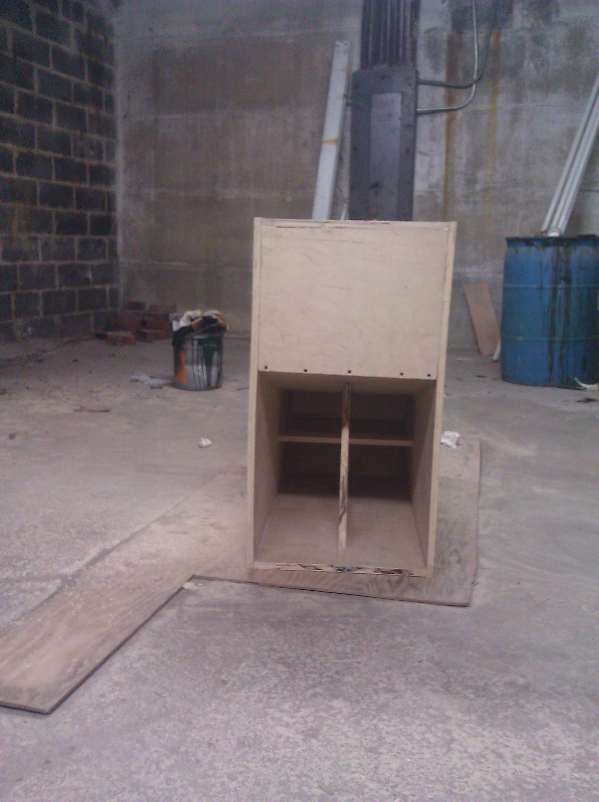

Ready to go another round
Woha....looking good Kornnylike!!
Thanks odougbo

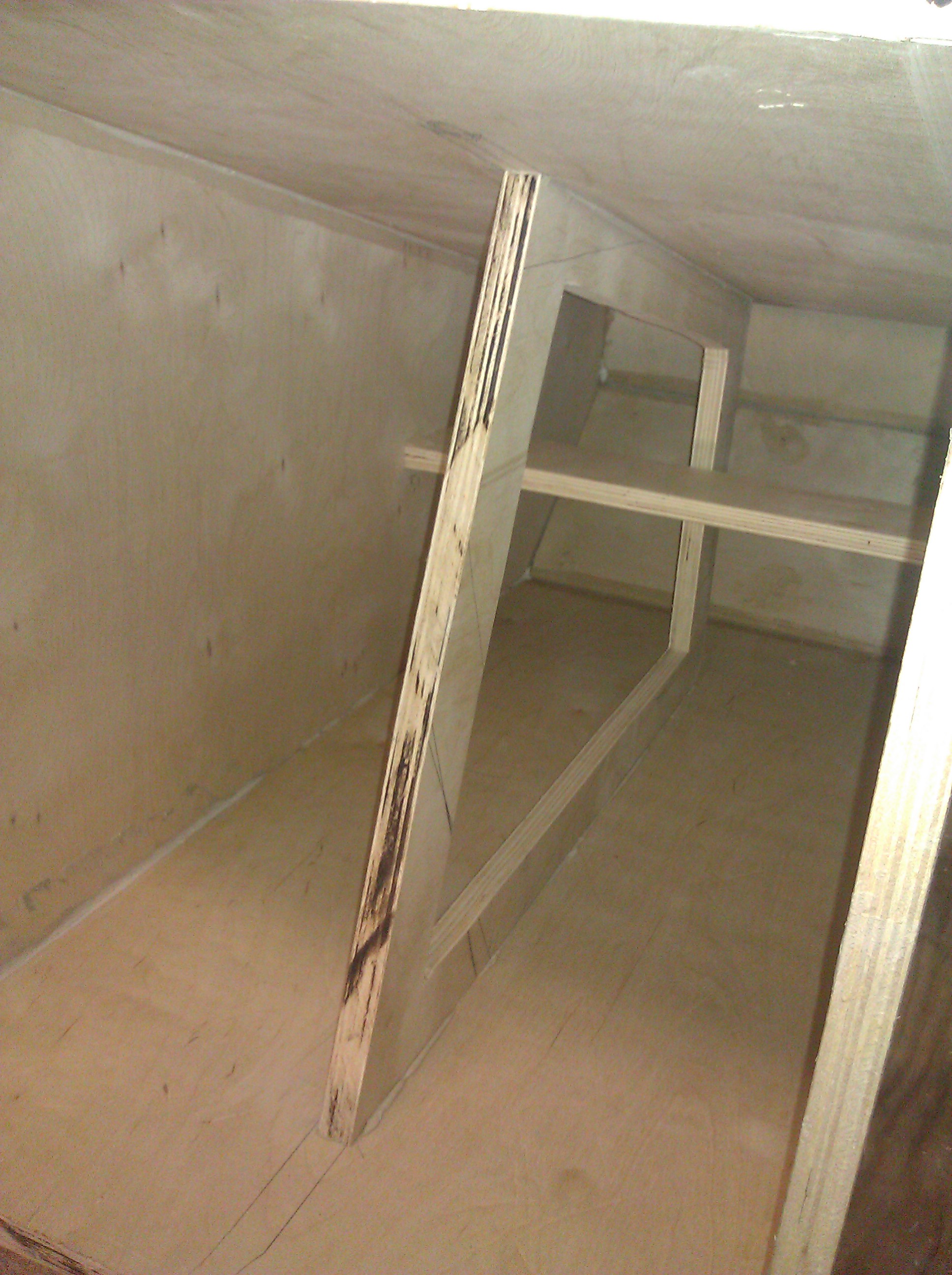

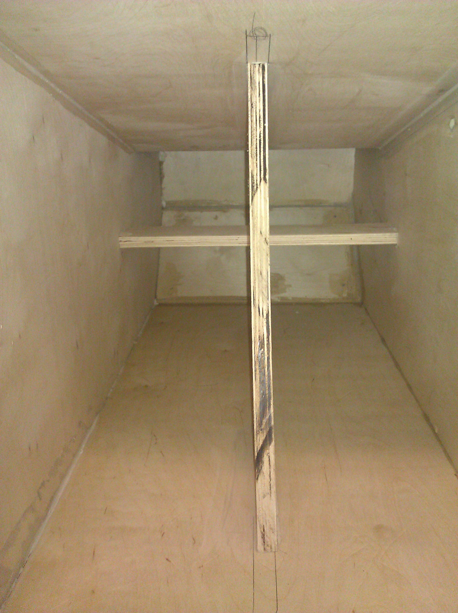

This bad boy is deep.
put some extra screws in ,you don't wan't vibration/leakidge there.
Will do
