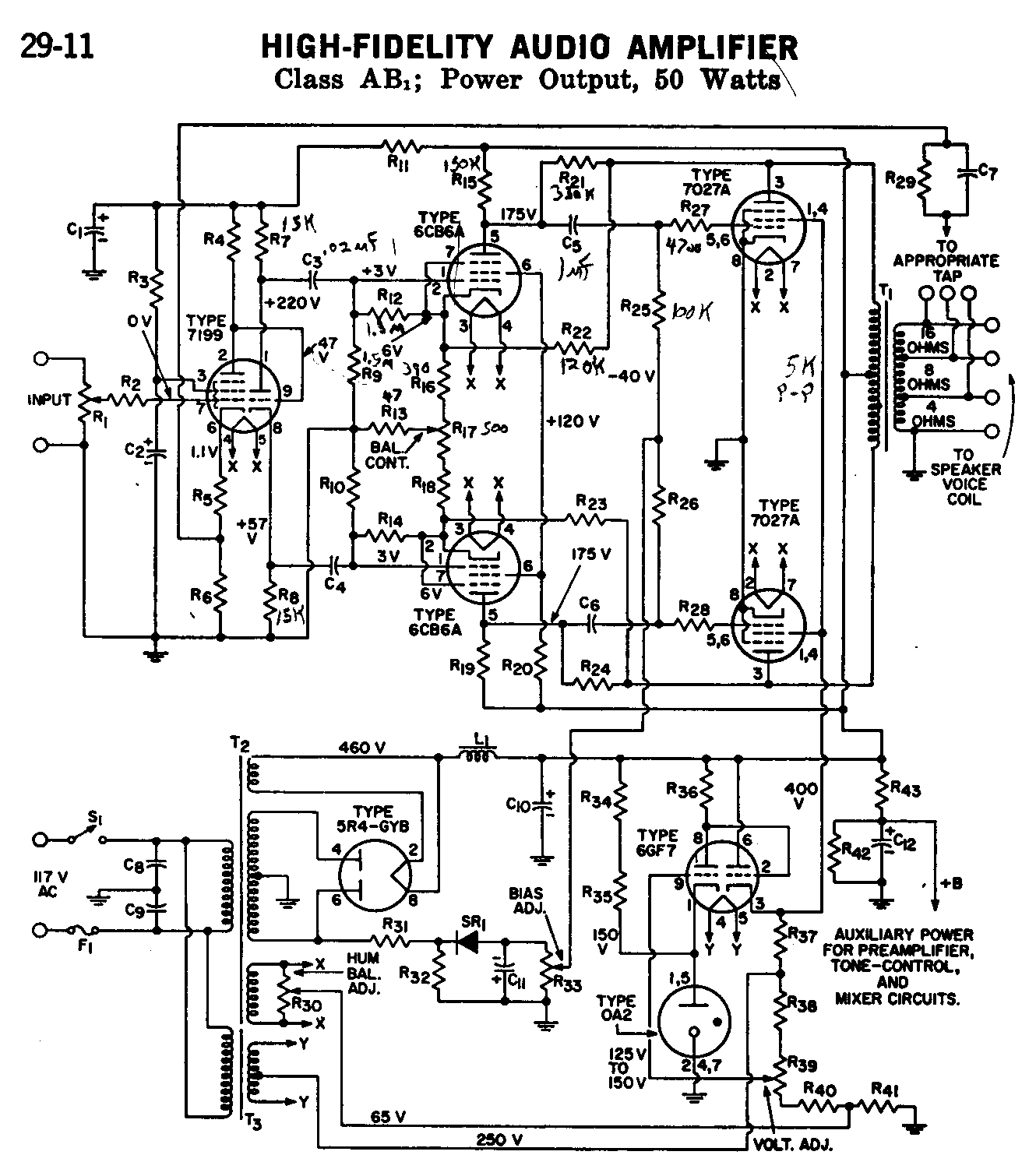

RCA comes the closest to the ultimate design I've seen with their handbook amplifier (RC-30 page 696). I would just replace its output stage with a circlotron stage to reach ultimate status. Why this circuit? It has hidden in it the magic crossover fix scheme Broskie mentioned. The Schade feedbacks to the driver cathodes. Current sense resistors are implicit in the OT primary winding resistances. Some improvements could still be made such as a CCS tail for the driver. Input stage and splitter can be anything you prefer.
I had often wondered why the RCA circuit used two types of Schading (to the driver cathodes, and to the driver plates). I had surmised that something was different between the two, but what? Well, the cathode feedbacks are differential, while the plate to plate feedbacks are SE for each output tube. Broskie's "magic fix" article (but in totem pole form), revealed the secret.
Looking at the SS totem pole circuit form, the feedback pickoff would transition linearly for a class A output stage. But notice what happens with class AB, the pickoff transitions smoothly until the crossover region is reached, then it speeds up, and then returns to smooth tracking once the crossover region is departed. This is NOT LINEAR feedback!
This is ERROR ENHANCED feedback. It is similar to Hawksford Error Correction in that it has an enhanced error component, but here it is mixed with the linear tracking component. (HEC computes just the error component alone).
This means that the Schade loop using this feedback only needs a FINITE amount of feedback to completely fix the crossover error. So if one were to adjust the "magic" feedback level, one would find a "Null or minimum" error point (crossover dist. null).
This is why the RCA amp has the two Schade types. You only adjust the cathode feedback to the crossover null point. Any more Schading (lower output Z) has to be done by plate to plate Schading.
The question remaining in my mind is whether the RCA designer actually knew what was going on here. Is there some obscure article in the RCA Review journals describing this? Seems that no one else ever caught on to it. The SS totem pole equivalent versions of this were patented later at least 3 times.
In any case, this RCA scheme is WAY WAY more sophisticated than the Mac design. No one seems to have ever figured it out till this day. There you have it.

Here is a scan out of my RC-30 handbook. I think you can find better (larger) scans on the WWW. There were some similar amps from RCA earlier too. RC-19 had the 6V6 amp, and the SP-20 amp was commercially offered. Although the SP-20 has only the cathode Schades.
"I wish I had some idea what you guys are saying to each other."
Sorry to be confusing here. This admittedly takes a good grasp of both SS (solid state) design and hollow state design to follow. So is no doubt confusing to any electronic newbie. Maybe some clarifiers:
a) In the Broskie SS totem pole schematic, the magic Schade feedback pickoff would be one of the 100 Ohm to 100 Ohm tie points. The equivalent of the tube driver stage (one side) would be the transistor with its emitter connected to the 100 -100 Ohm tie point. The tube version just has its cathode connected there, equivalently.
b) The tube version uses a center tapped OT for tube loading, while the SS version is totem poled.
Converting over is not too hard here fortunately, since the SS version is drawn with collector outputs just like a tube stage. The 0.1 Ohm current sense resistors are in the SS collector to load path. Similarly, the current sense resistors for the tube version would be inserted between the plate and OT winding. Since the typical OT has significant winding resistance already, it is inherently present without adding a real resistor. Hence no plate resistors show up in the RCA schematic.
