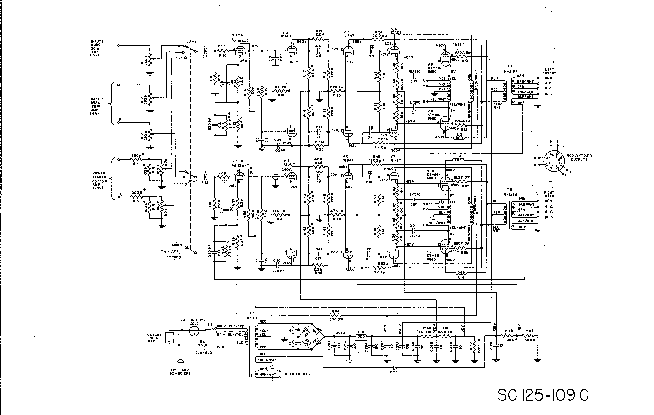

Triode output tubes, no negative feedback, fully regulated power supplies, permalloy output transformers(like old UTC LS units)... Single ended or push-pull... Go wild!
"Norman Crowhurst's "Twin-Coupled Amplifier". ..... Same thing as Mac."
"This is not true... A different topology... "
Yes, true enough, they are not identical per se. But functionally, the Twin Coupled arrangement provides the same 50% CFB (cathode feedback), and the same Unity Coupling (via the crossed Plate- Cathode caps instead of the bifilar winding, Mac even adopted this technique later). If these are the only "factors" of importance, note that the EV Circlotron does this even better.
The "sound" of the Mac, I would say, is more related to the high levels of FDBK. The unity coupling merely allowed Mac to lower the output bias currents closer to class B for efficiency. Then they clobbered the resulting bad crossover distortion with a pile of FDBK. I suspect that Norman's Twin Coupled Amp on the other hand was just biased higher to avoid the crossover dist. and then used less FDBK. It might well sound better to many. In any case, I would just use the Twin C OT technique to avoid the expensive bifilar OT, and then re-design the whole circuitry anyway, to use Sweep Tubes (some are much better than the usual audio outputs, verified by curve tracer). Or just go Circlotron.
But I have to agree overall, why bother trying to get Mac sound. You can do better. And even the 50% CFB and special OT arrangements of either Mac or Twin C or Circlotron are really unnecessary, just use some form of Shade feedbacks with a normal OT (popular on the forum lately too, try Pete Millett's board, it even uses Sweep Tubes, and George -Tubelab- has vetted out a bunch of higher power Sweeps that work well on it).

Both methods (Mc and Crow) use local feedback from the primary of the OPTs.
Fine except the load is connected to the secondary...
I like the ARC ST-70-C3, what stands output cathodes on 0 and 16 taps of the
secondaries, and grounds out the 4 Ohm tap instead...
audioresearchst-70-c3amplifier - mpbarneyamps
The point I am driving at here: Is that no matter how good the primary side
distortion may be controlled by cathode feedback - Distortion across OPT(s)
has to be handled by a long shifty GNF loop, if you don't feed secondaries
back to cathodes as ARC has done.
Well, you can apply plenty of local feedback(s) without getting OT phase shift problems, so that is good for fixing the tube distortions, crossover dist., magnetizing current, and primary distributed capacitance. Then only a modest amount of global feedback is needed for the OT resistance, leakage inductance, and secondary distributed capacitance. Ie, frequency droop and damping factor. Some might not even want to fix those two problems.
The AR setup looks to me to be sub-optimal, too little local feedback. Better to run that CT 16 Ohm setup back to some driver inputs instead of CFB for the outputs. Better yet to just skip it. See below.
The issue I see with the Mac type setup is that the class B crossover distortion requires a lot of feedback somewhere to fix it. Easy enough to fix though, just increase the bias current into optimum class AB. But then you don't really need all that fancy bifilar stuff or mega-feedback. There are better ways to deal with the residual class AB crossover distortion nowadays anyway:
Take another look at the Mac output circuit... The way the output tubes are configured with the output transformer, there really isn't crossover distortion in this circuit as both halves of the output transformer are always "on" and with the exact same current going through both halves... And you don't even have to match the output tubes! That's why they didn't go with class AB operation to reduce distortion... It wouldn't.
For instance.... The upper output tube in the MAC circuit is conducting, the lower tube is at cutoff. No worries... One half of the transformer's primary is cunducting current through the top tube's plate connection and the other half of the output transformer primary is conducting current through the same tube's cathode connection which means the signal is out of phase because it's the cathode; perfect for the other half of the transformer, the signal needs to be out of phase on that half.
I am probably not describing this well here... There is a book called "the audio encyclopedia" which does a much better job.
Daniel
The AR setup looks to me to be sub-optimal, too little local feedback. .
This is actually a good way to use feedback to tighten up the output section of an amp without introducing the dreaded GNF that makes amps sound bad. The problem with this setup though is that another stage of gain usually has to be introduced into the amp to keep output power optimal.
The definitive explanation of how these clever and innovative circuits work is Crowhurst's "Realistic Audio Engineering Philosophy." Originally appearing in Audio Engineering magazine, it was reprinted in AudioXpress's "Audio Anthology." There are pdfs of it floating around the 'Net.
