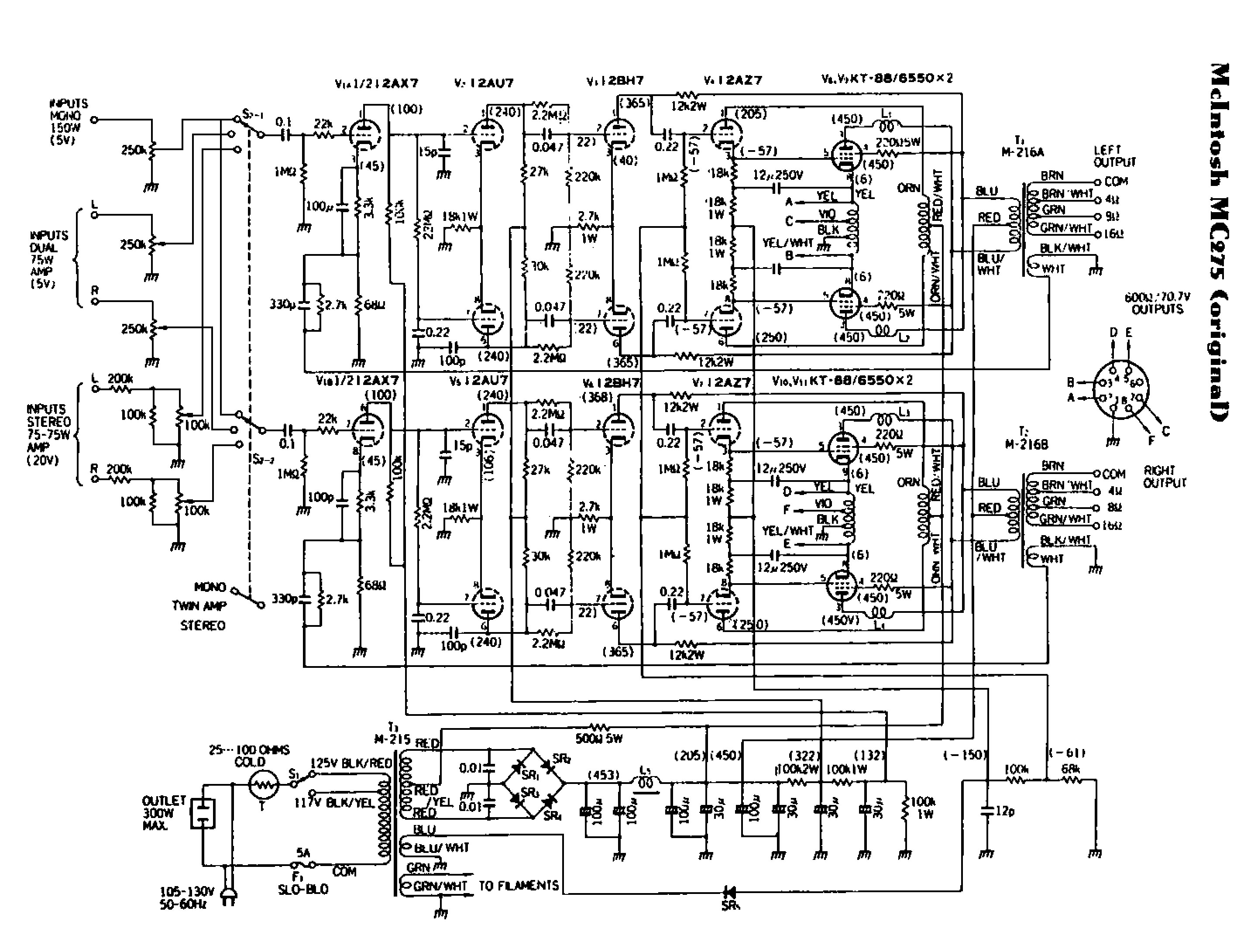

Odd fix of a MC 275
Hi
GridLeak.blogspot.com (I have a lot more to post)
I have been swamped with vintage guitar amps for players, or would have responded earlier.
My brain was "off" when I posted, so here is a better ex-plane-nation
If you look at the schemo, there is a center tapped coil, that goes to the two 12at or z7 tubes.
This coil takes signal from the 12at(z)7 plates, and is in-phase, or "boosting" the drive to the output tubes, through the out transformer.
I verfyied this with Mr scope when I found this problem.
This was done as the 12at(z)7 does not have enough power to drive the 6550s in cathode follower mode.
In these amps the output tubes just sit at idle, and are driven up to power, they have no gain, so the driver has to be pretty good to handle transit response, where short bursts can be ten times higher than the average signal.
My big trick through the years has been to take what I have, and make it work, so I can pay the bills.
This amp came from Italy, the first 275 I re-built or re-paired.
When I had finished re-replacing parts and clean-up, I brought the amp up on the variac and started testing. One channel was distorted, and I found one side of the "coil", or winding to one plate of one 12at(z)7 was open.
So, was there a way to make this amp work without re-winding the output trans, about $350 back then??
What I did, was to un-hook both coils, then I swapped out the 12at(z)7s for 12au7s, as the RCA book shows 330 volts max instead of 300 volts max plate voltage.
What is interesting now that I am looking at this schemo that has 12az7s, is the RCA book shows 330 volts for a 12az7 tube.
I have used 12az7 tubes over the years on guitar amps and some hi-fi and they always had a great sound.
Now what happened in the amp, is that when the winding was out of the circuit, the plate voltage was higher, so I swapped the tubes, and changed the 100k up in value so the plate volts was just a bit lower.
My 275 was not exact the same as the one in the schemo, and voltages might have been higher.
Re-storing a pile of "Macs" over the years, I found, "nothing is certain", as driver assemblies for one model were used in other version amps, color codes not always the same etc...
The driver stage in these amps, is a push-pull, cross - coupled circuit, using both positive and negaive feedback. Macs have a "balancing act" in the driver circuit, and in the out trans also, that provides massive control of the whole audio chain, from in to out.
The smaller amps, like the MC 30, 40 and 60s, and the 225s, are sweeter because the drive voltages/power needed is less to the output tubes, so the sound of the driver stage running high level voltage/power is less.
The 7591 tubes have a lot of gain, and less drive/grid power needs.
The higher power amps, have a "dry" kind of hard midrange sound, as the driver tubes are running very high voltages and working hard.
I also re-stored several McIntosh MIT-200, 200 watt amps with 8005 triodes, and they were truly amazing sound amps.
Hope this explains better

What you are calling a booster coil, IOW, is the one of three trifilar windings on the primary of the OPT, that is on the driver. The reason it was changed to this configuration is because of excess voltage on the driver section of previous Unity Coupled amplifiers.
Mc-275 stuff
That could be true, but the winding does add more gain, I tested all with my os-silly-scope, I use all the basic stuff, have no idea what a CAD program is, so I saw proof of this.
Without the winding, the 12at(z)7 stage is just a unity gain kath-ode follower, and I thought right off, when first snooping at a 275 schemo, how odd to add the winding to get more gain, or if reversed, negative feedback to this stage.
The amp sounded soop-er afer the mods, a 12au7 more linear stage.
Using a high-gain tube to drive the grids was to me weird.
The MAc driver stage is all over the place with high-low gain stages
You have to spend a few months inside one to understand one
I mean, what the original reasons, more likely you are right, as Mr Mac was trying to use the 12at(z)7 stages for reasons no one except a few could even guess.
