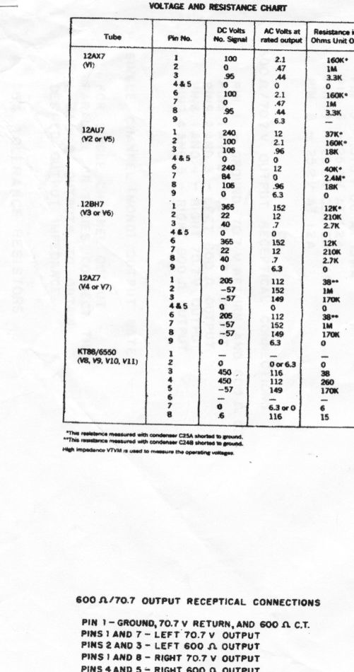

Dc resistance chart
Tony,
Attempting to send attached but can't get thru .

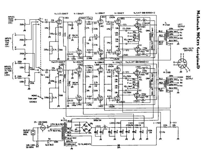

looking at what the intentions of the designer were, i deduced the following:
1. separate feedback winding was used because the amp was intended to be paralleled for greater output of 150 watts mono, so if you do not intend to go this route, we can dispense with the separate windings for feedback and just ground the common terminal and take the feedback from the 16 ohm tap which is costumary...
2. likewise with the cathode feedback winding, if you do not need the line outs,(i doubt you will ever find use for this!) then the cathode feedback windings can de done sans the taps, to simplify winding the traffo.
with those out of the way, i believe hacking the traffo would be less complicated....
would appreciate inputs from tube gurus here!!!
tony

hi,
we can still determine the turns ratio, if you can borrow your friends' amp, what you can do is pull-out all the power tubes, in fact all tubes...
then on the 16ohm tap, inject an ac voltage of say 10volts....
with a 10volts on the 16ohm tap, you should have 5volts on the 4ohm tap, and 7volts on the 8ohm tap...
now you can measure the ac volts at the plates of the output tubes, list it down, it should be plate to plate...
next do the same for the cathodes of the output tubes, this sould be cathode to cathode...
next is the plate to plate of the driver tubes....
with these simple steps we can determine turns ratio...
interleaving mentioned in the manual says 5 sections, so i suspect 3 sections for primary and 2 sections for secondary...
trifilliar winding can be of two kinds...we can decide later when we get the data...
depending on the internal resistance of your voltage source, it may drop as you connect it to the 16ohm tap so check the voltage at the connections before proceeding with the other measurements....
