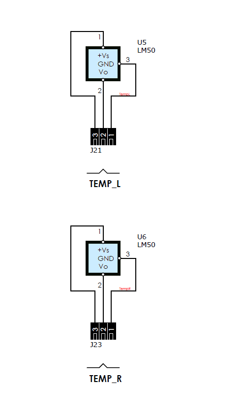

Is there anyway I can mechanically bypass the temp probes until that arrives?
You need to put back the temperature sensor - connect to the board all sensors (please be aware of + and - on sensor and on Maya).
Then in the settings menu to go to -- > show temperature --> disable and save.
After this it will ignore the temperature sensor and after this you can remove the temperature sensor from board forever .

But you can disable :
please enter -->Settings -->"Ena/dis temp sh" -->disable by rotate the encoder anti clock wise till the lcd show : disable
and then press again menu button then exit settings. This setting will be saved in Eeprom till the next time you enable this.
Did you try this ?
buzzforb
please put 2 straps between center and minus of both temperature sensor pins on Maya like in photo,
this way he will let you enter the settings and disable show temperature.
For the rest here is a firmware that at power on show : "Maya Preamp Ctrl" and on timer show warming up, with smaller time at startup " Warming up " that can be disable by setting to 0 the time and with temperature sensor disabled by default.

The jumpers on the temperature sensor worked perfectly. Hooked up inputs, bridges grounds as well as negative input for the SE input. When I measure the output of the controller, the positive phase output is (x)kOhm above ground. Unfortunately, the negative phase is also showing the same number. It does not appear that jumpering the negative phase to ground on the input is grounding the negative phase output. Inassume that this is not a problem because it is simply dividing down 0, but will it ground the negative phase input of the instrumentation amp as needed?

Yes, that works. I did try that before but it was with an earlier firmware.
Thanks Danzup

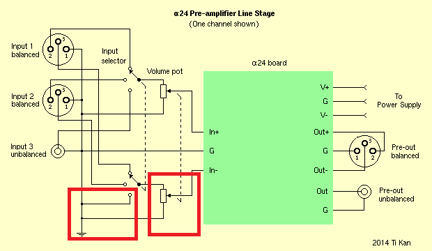

I am using a balanced version of the Maya with the AMB differential line stage. The differential line stage can accept SE or Bal input as long as the controller can ground the negative pin when the input is SE. Is it possible to set the Maya up to do this and still have option of balanced input on second input spot? I am including a diagram from the AMB site.
This AMB sch is wrong.
It shows pin1 of the two inputs connected to chassis and then this chassis connection going to the bottom of the vol pot !
Do not connect the vol pot to chassis.
The output Pin1 is shown connected to G on the pre PCB. Pin1 should be connected to Chassis.
