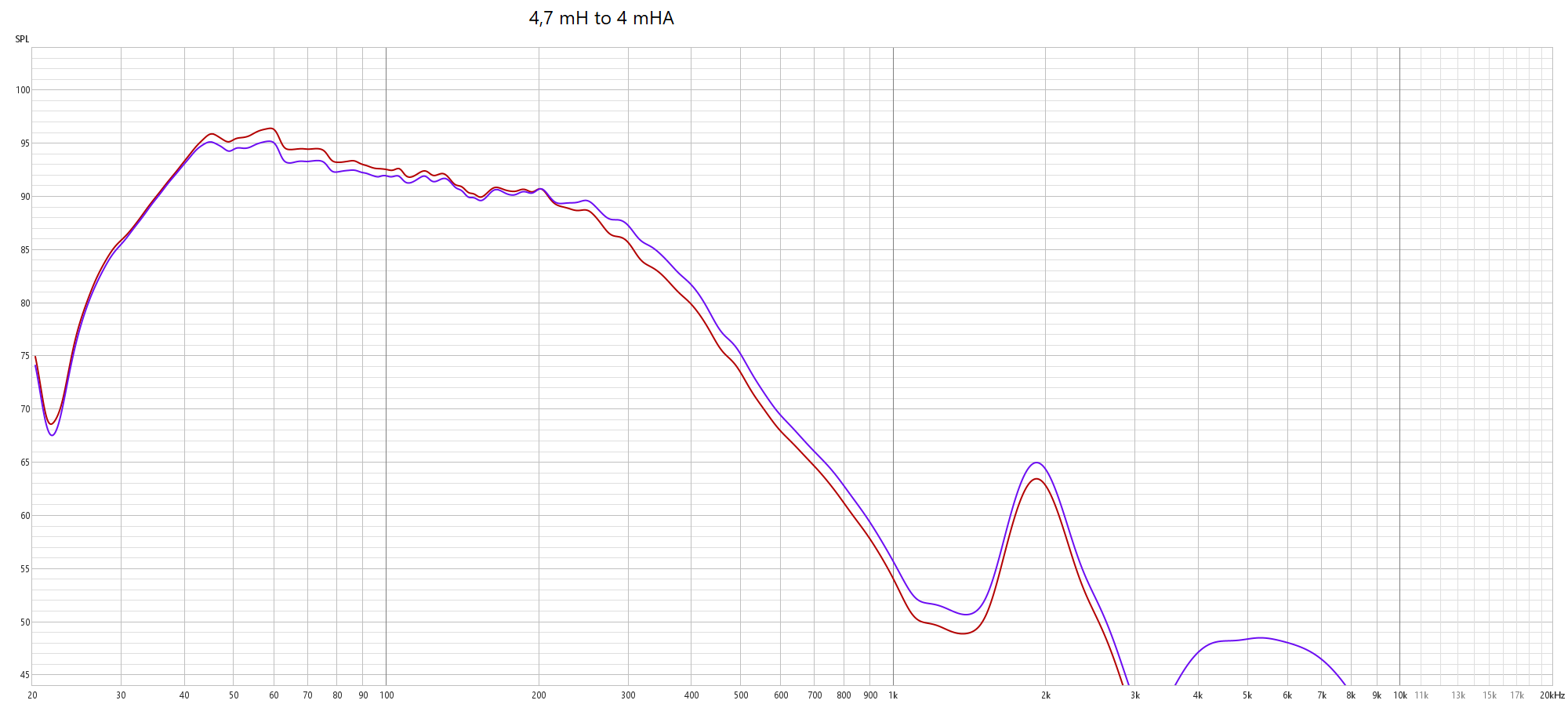

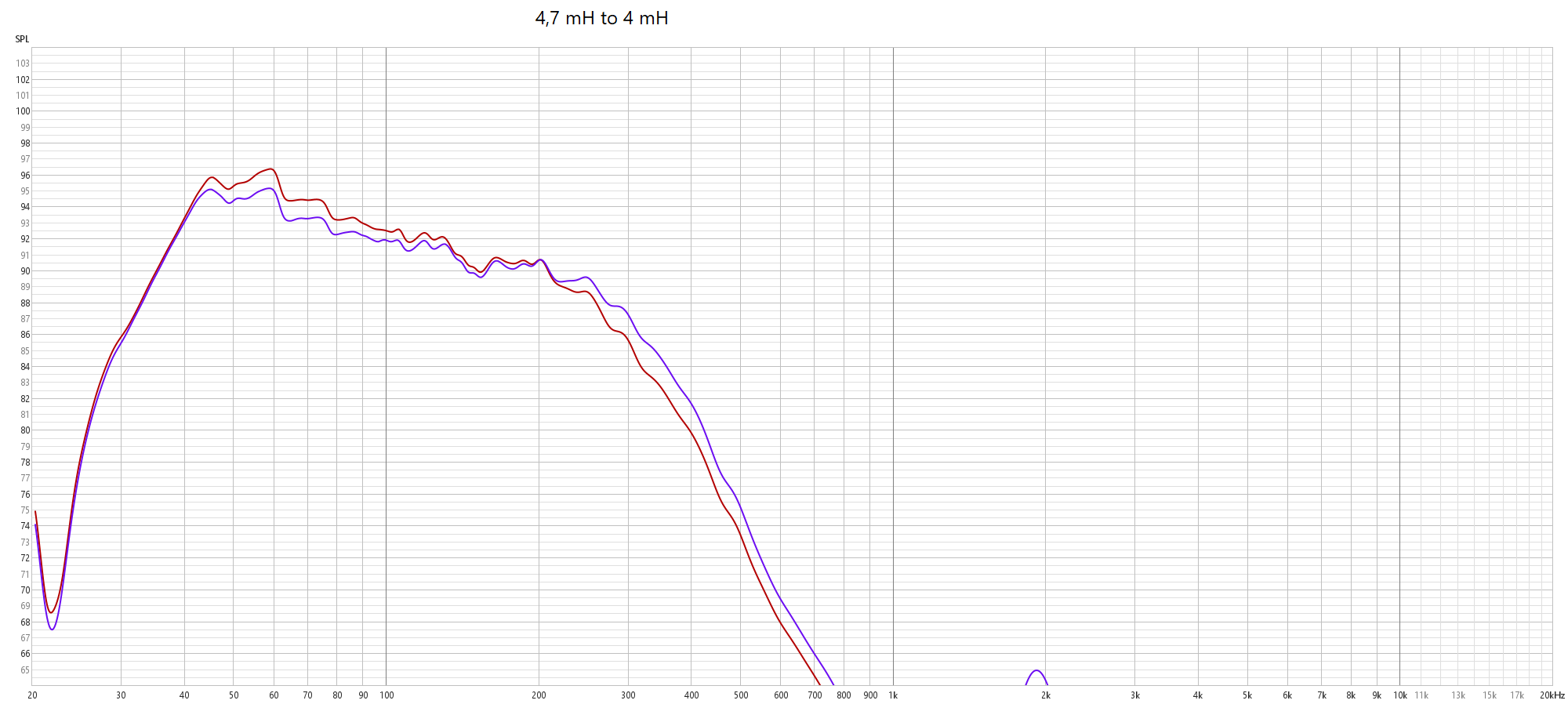

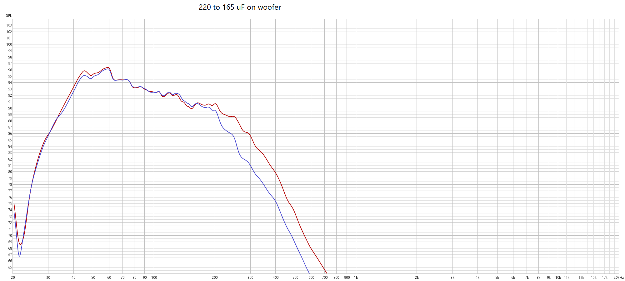

I think you are trying to show us that as you let the woofer play higher, and reduce the capacitance the 2Khz resonance rises. Its 25 dB down so maybe not immediately discernible, or you can in fact hear it? What do you hear? can you see it add to the response at 2kHz?
My earlier suggestion was to see what movement in the VituixCad programme did to the response as you moved the mid woofer cabinet backward and forward, in the hope that it would produce a better fix than playing with the electrical components.

Just messing around testing things.

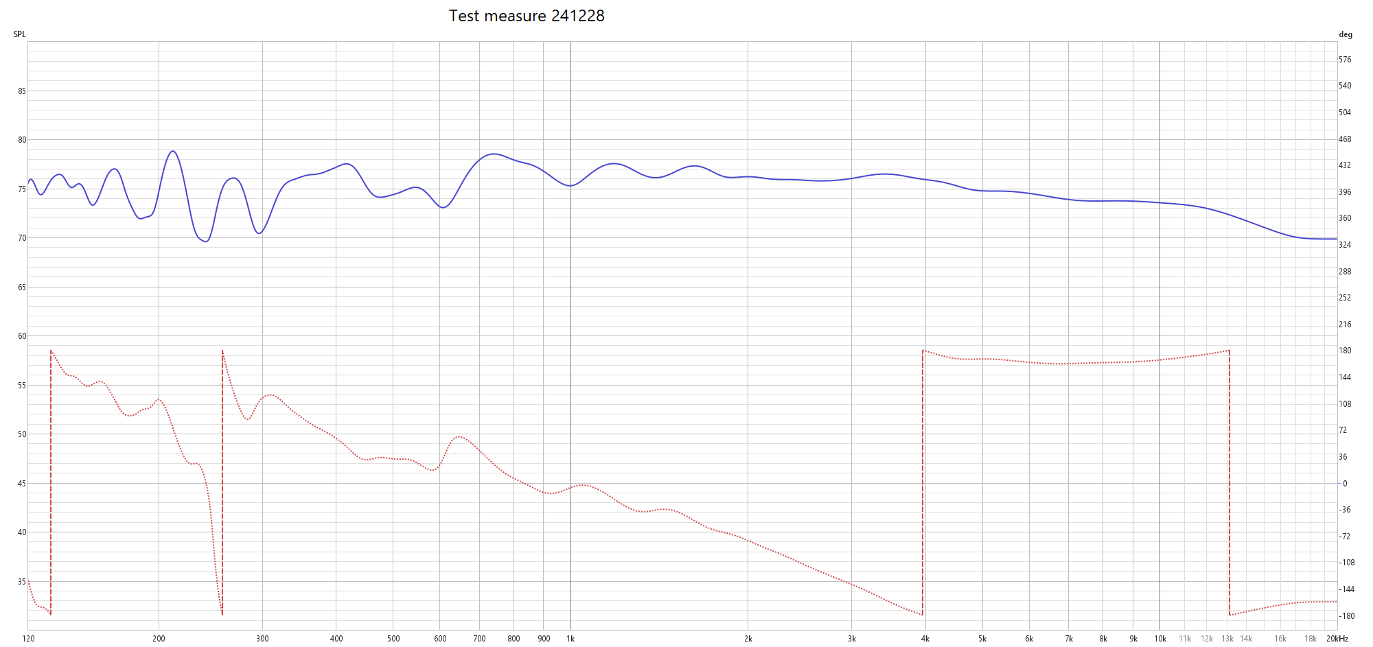

And a spontaneously made measurement from 120 hz, show´d up like this with mid and twee closer woffers baffle front.
No Ray, i can´t hear or see it.What do you hear? can you see it add to the response at 2kHz?
regards John
Before you adjusted the Z axis of the drivers correctly, yes the red circle in the picture.Do you see that because the behavior att crossing LF to MF ?
My red ring in the picture?
The total summed output of the 2 drivers was lower in amplitude, then the individual drivers output.

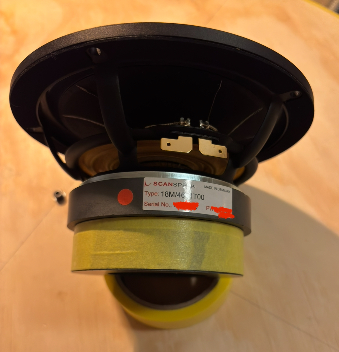

I can recommend adding bucket magnet to the 18M. Found some magnets in the basement that had a perfect fit. The magnet stick fine secured only with painters tape.
Soundimports even have original Scanspeak magnets with big enough inner diameter.
I really like 18M and I am confident I will never part with it. My search for ultimate midrange in 3-way is over.

I got inspired from @Kwesi to try adding bucket magnet. So far I have tried it with SB17MFC = nice result. with dayton RS225 4 ohm (Alu) - Bit more grunt in midrange.
With 18M difference was not night and day. I tried back and forth with and without many times. I cant measure TS, but I could clearly feel more force from the driver with added magnet. I could also measure a bit more dB above 200 hz.
As with subjective difference in sound with magnet:
Driver sounds a bit more grown up. More grunt. More agile. Better transients. Sound of voice is kinda moved a bit in front of the driver.

But the 18M is 156 mm wide original, how you mount a smaller one?Magnet i tried was something similar to this:
And did you mount it counter pole or what?

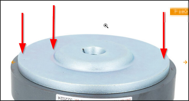

18M has 110mm magnet. Thanks for confirming added magnet works well. I am going to start the project with it very soon and planned to use additional magnet, so far it brought SQ improvements always I used it.
I just mount it on this surface:
As with direction of magnet it you mount it like this:
At some distance away from the driver, like 20 cm, the magnet and driver wants to go away from each other.
Moving the magnet closer to the driver, like 10 cm, the same thing happen.
Moving magnet very close to the driver, the magnet and driver pull to each other and basically magnet snap to the driver. Be careful at this stage with both fingers a magnet. It may chip a bit.

I always use a guide tube to mount bucking magnets onto drivers. Its basically a plastic sleeve made from a disposable kitchen cutting board wrapped around the speaker magnet. Its then secured with either 2 worm gear (jubilee style) clamps or clear packaging tape.
I then use medium viscosity cyanoacrylic glue, coating the magnet with a squiggly bead, then two thinner beads on the outside and inside edges of the same magnet face. Its best to double check your magnet polarity to the woofer so you're 100% sure its correct. The two magnets will be repelling each other initially, then attract each other when the poles are very close.
CAUTION - watch your fingers and wear safety glasses!!! Tiny magnetic shards and chips embedded n your eyes is a bad thing. You have to make 100% sure the added magnet is going to do what you want it to.
On some applications, an extra magnet mounted with same poles against each other, it can reduce magnetic flux in the VC gap, reducing sensitivity and raising Qts. It may also affect flux linearity and geometry in the gap, possibly increasing distortion.
Mounting an extra magnet with opposing N+S against each other will reduce flux in the gap. This is due to redirecting the flux away from the gap. Sensitivity will also decrease from this.
Sometimes nothing will happen and you've wasted a perfectly good magnet on an already great driver needing no help.
I'd verify any of these magnet additions are first tested via TSP analysis (ie. Dayton WT3) and measuring driver acoustical output behavior.
