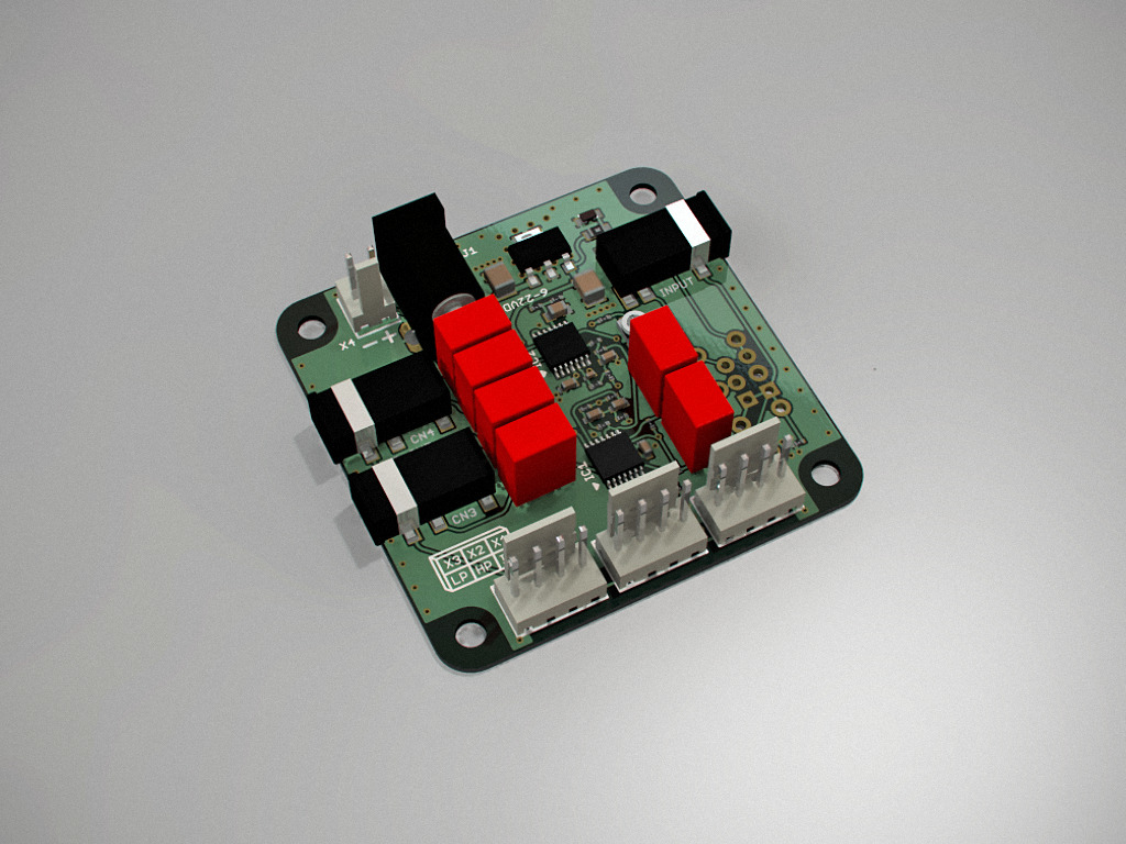

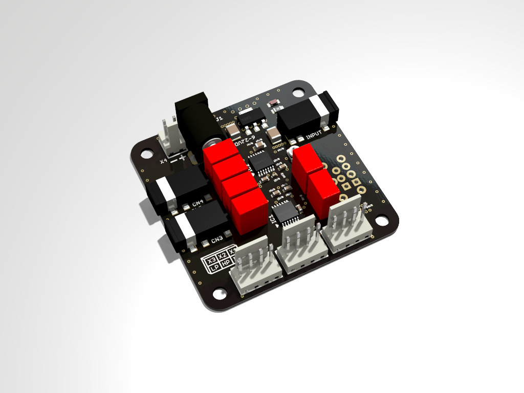

Some small changes, Rev 0A.
Suitable crossover for the MAX9709 boards. (Same shape)
Linkwitz-Riley configuration, x-over at 200Hz, single ended configuration.
Input:
3.5mm jack pre-potentiometer
3.5mm jack bypassed potentiometer
4x pinheader post-potentiometer
Output:
3.5mm jack Highpass Stereo
3.5mm jack Lowpass Mono+Mono with adjustable gain
4x pinheader Highpass Stereo
4x pinheader Lowpass Mono+Mono with adjustable gain
Coupling caps are either MKS2 (Wima) or 1206 X7R ceramics.

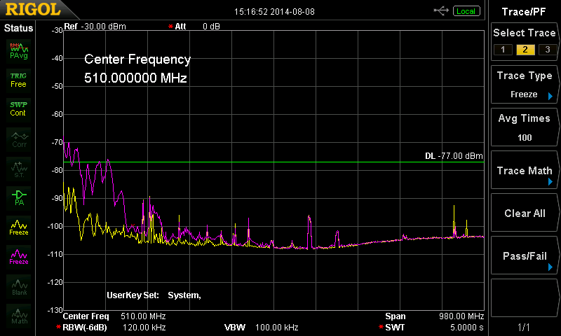

Regarding RF+HF within a filterless design, our/my MAX9709 performs like shown.
Test setup:
40cm cable on one channel with a 10Ohm load
wideband-antenna (EN61000-6) (30MHz - 1GHz) RMS/AVG
measured 3 meters away
yellow: background (radio-stations etc.)
magenta: background + MAX9709 pcb
-77dBm is ~ the EMI limit

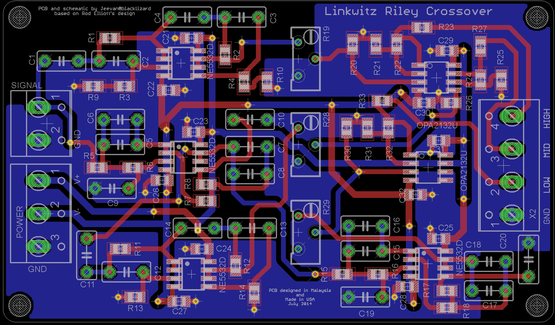

I hope it doesn't bother you reviving this old thread. At the moment i'am looking into active crossover designs using linkwitz-riley 12db slopes. I found your crossover board on this thread and 360suctoms site, but could not find more info. I want to use it in a small bluetooth speaker to practice some elecktonics and the single rail seems handy.
Now using elliot sound calculator i came across a different layout compared to yours, am I missing something?
for the high pass you changed the position of the resistor to ground and resistor over the opamp. What is the impact of this change?
last thing is; how do you mute the output in your design when powering down?
