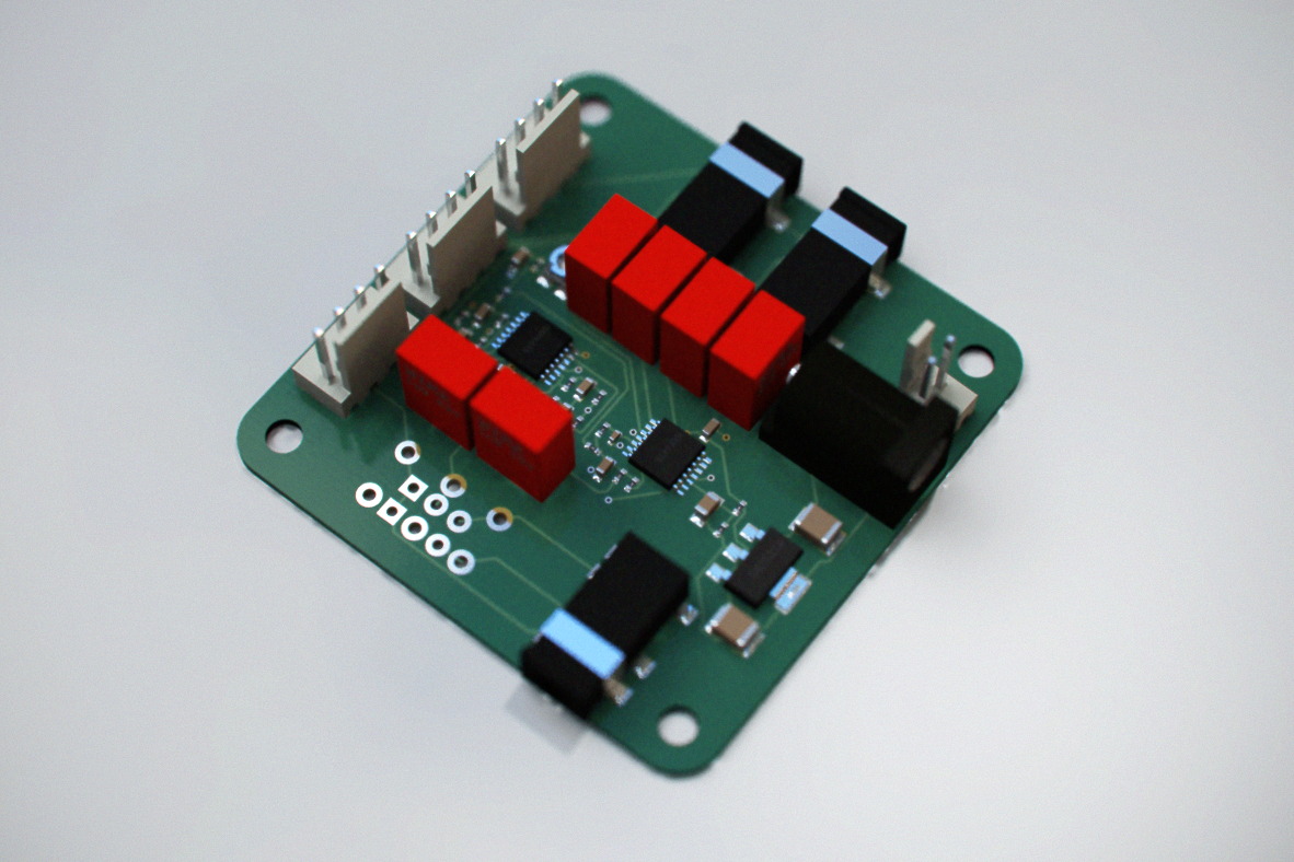

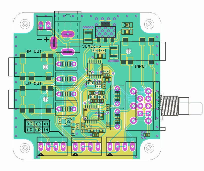

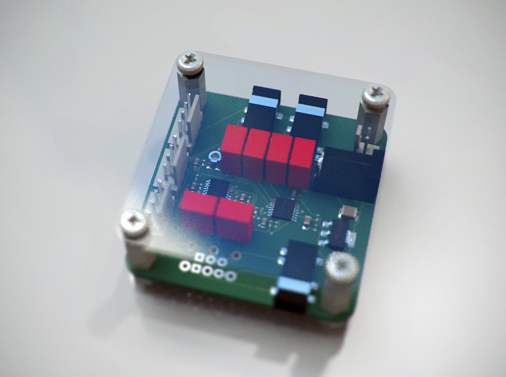

Suitable crossover for the MAX9709 boards. (Same shape)
Linkwitz-Riley configuration, x-over at 200Hz, single ended configuration.
Input:
3.5mm jack pre-potentiometer
3.5mm jack bypassed potentiometer
4x pinheader post-potentiometer
Output:
3.5mm jack Highpass Stereo
3.5mm jack Lowpass Mono+Mono with adjustable gain
4x pinheader Highpass Stereo
4x pinheader Lowpass Mono+Mono with adjustable gain
Coupling caps are either MKS2 (Wima) or 1206 X7R ceramics.
