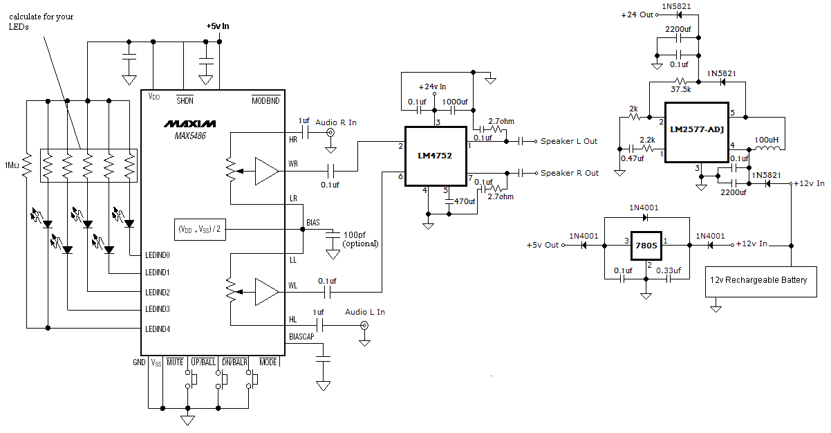

so the CR2302 battery didn't last long to power the chip since it fell below the 2.7v threshold 🙁 I've attached a schematic below of my setup, anyone have any ideas on how to make this work with my single supply 12v battery?? adding another large battery to my setup is going to kill it, since it won't be very portable (not to mention practical having to charge them both.. :/ )

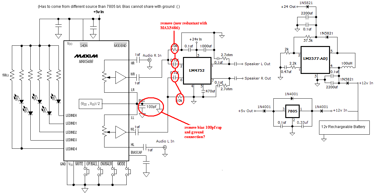

agh, I can't figure out how to edit my last post. Someone pointed out an error in the schematic I made by accident...I mistakenly swapped the W and H MAX5486 pins. Here's the attached corrected schematic.
I am also attaching another schematic with new corrections I am going to try that were suggested to me. These might solve the single supply problem..
I will report back!
Also note, I found that 1M ohm was the wrong value for all the LEDs. this drops the voltage to ~1.5v which most LEDs won't work with. Instead, I used a 470ohm resistor and most LEDs worked fine minus one Blue LED I had which was probably higher consumption.
I will report back!
That bias point should be on half supply. As the name implieas, and is shown even in the schematic. THEN decouple it to ground.
jd
yeah jd, not sure how i missed that, guess i was just assuming that LL and RL had to go to ground because that is how most standard pots work.

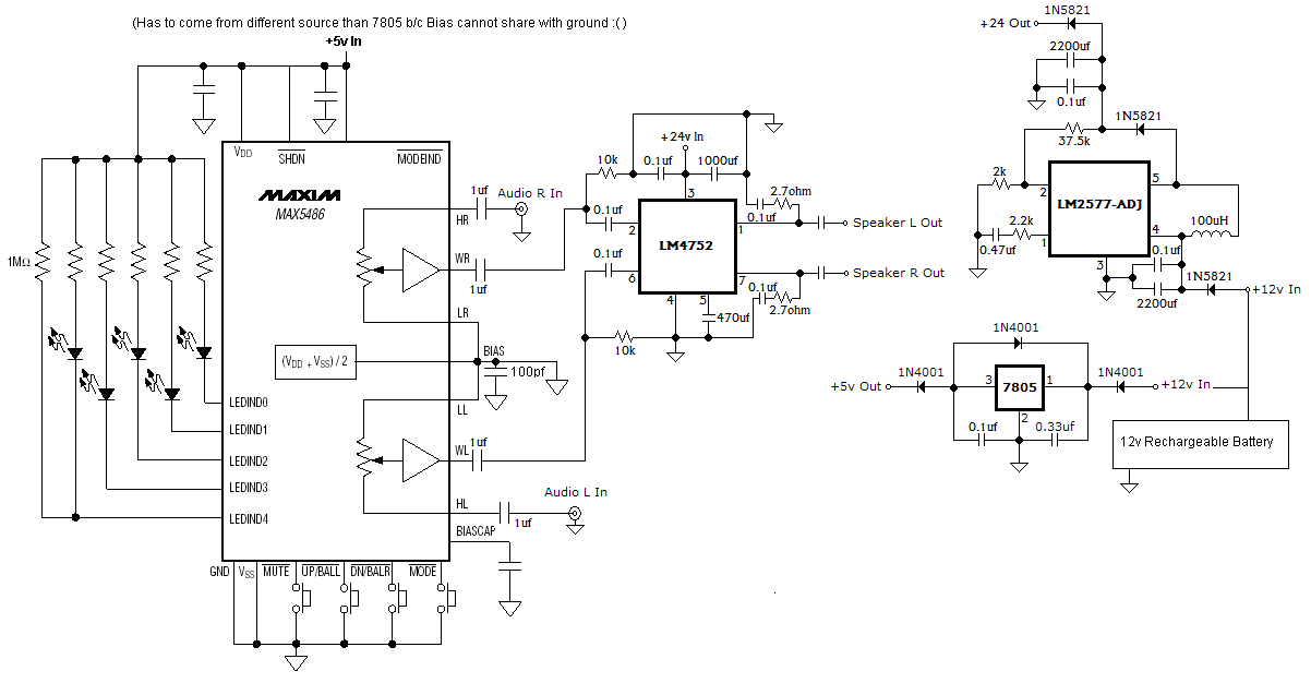

anyway, I finished my chip and it's working great. The only final complaint I have is a strange sound it makes when powering down LED0 when lowering the volume 20%-0%. Not sure why it does that but I doubt there is much way around it other than not using the LEDs.
Everything else is great though, and I updated the schematic in case anyone should want to use it in the future.
The main change is that you need to add 1uf caps to the input or it will make terribly load pops and clicks when the volume switches are used.

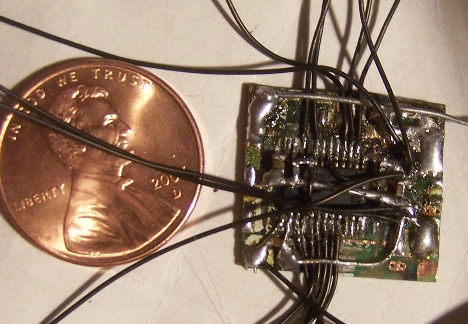

I also included a pic of my chip.
ah fixed the LED0 problem. Just needed to have the LED 5v power separated from the chips power sources (separating the VLogic and VDD voltages makes the chip sound understandably better as well). Also added a ground plane behind the chip which helps as well I'm sure. Now it sounds silent and beautiful 🙂

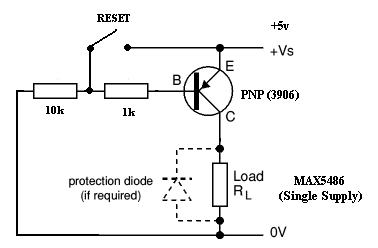

Still trying to fix the lockup problem on this chip which is, that withstanding, a fantastic circuit.
Basically when the input reaches the Vpeak ((Vdd+Vss)/2) or clips the circuit goes into a permanent lockup which cannot be undone even with a shutdown or disconnecting Vss. The only way is to disconnect ground or Vdd/Vlogic, i.e. a full power reset.
At least you can make a simple reset button with a general purpose PNP. I attached a schem of what I'm using.
