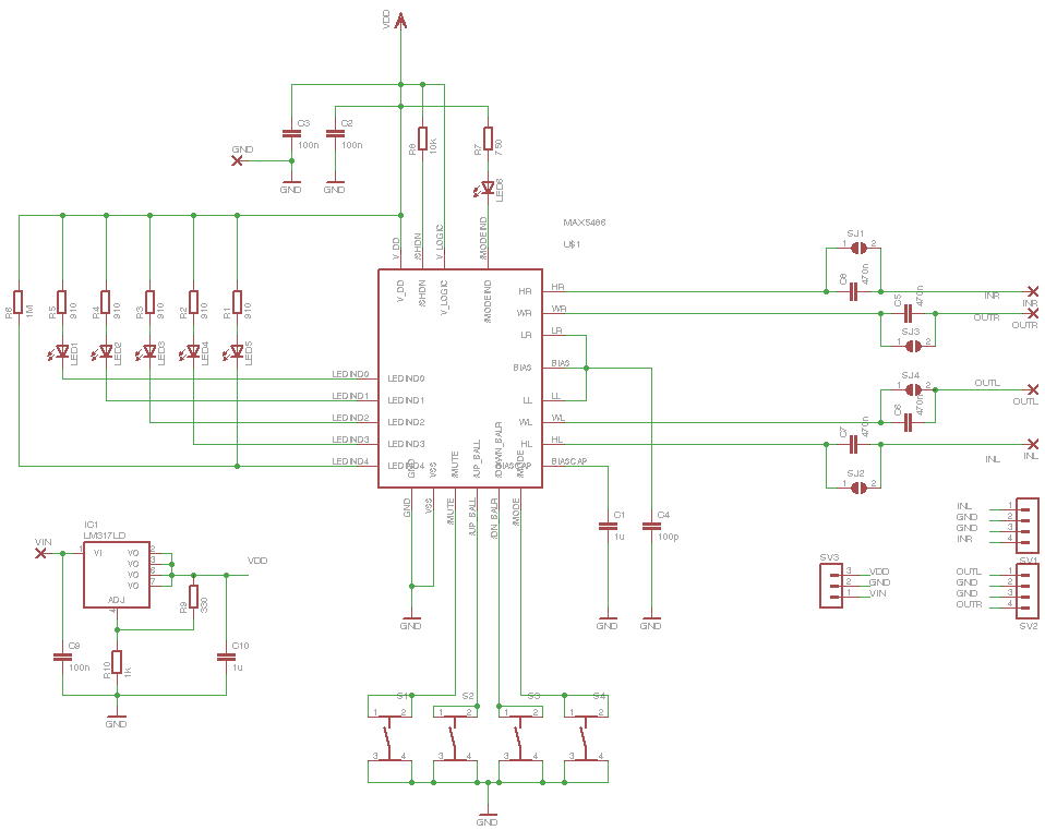

i just want to say, that i actually got less to none problems with this chip. Everything works like intended, there is only a small decoupling problem with the LED-PWM, that conducts little noise to the ground-plane. This might be a small layout issue which should get fixed easily.

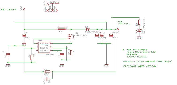

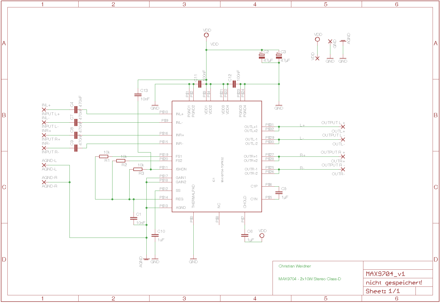

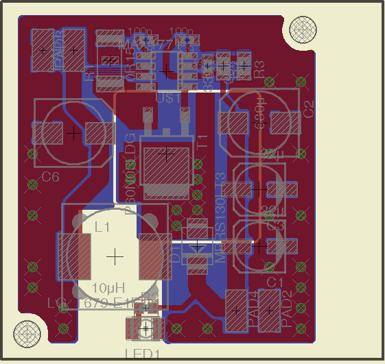

So my setup is as follows:
Power-Supply Main:
7.4V Li+ Batterypack -> DC-DC Step-UP to 14.4V using MAX1771
Power-Supply MAX5486:
LM317 14.4V to 5V on board
Power-Supply Amplifier (MAX9704 Class-D):
14.4V from DC-DC Step-UP
The Input is decoupled via 220nF FKP into MAX5486 and then coupled via another 220nF into the MAX9704. As the MAX9704 is differential-input, the ground (inverting input) is decoupled via 220nF to GND.
The shematics are attached. (I just need to fix the PWM-noise of the LED-driver)
Regards, doc

Hi, i have a few MAX5486 and this discussion is very nice and useful. I'll try to make an adapter TSSOP to DIP first, then i can start to test. But since now i have a issue: when the IC is in the balance mode, MODEIND is on and the LED is ON too. But when it's in volume mode, everythig gets dark... I'm just a beginner but isn't there a way to create something that make the presence of the current turns one side on and the absence of this current turns another side on... something like a relay, a very delicate relay. That could be far as necessary from the MAX548 (relays are eletromagnetic things). Then we could have two LEDs, two little windows in our panels ou a bicolor LED (when it's green, it's VOL, when it's yellow, it's BAL. As i said, i'm just a beginner and... is it insanity from me? rs...
You may try to connect a N-channel MOSFET to /MODEIND. UGS(th) should be lower that 3.0V.
G -> /MODEIND
D -> R_led -> LED -> VDD
S -> GND
As /MODEIND is open-drain-output, balance-led will light up, when /MODEIND is active (low), providing a GND-path to MODEled from VDD. If /MODEIND is not active, you'll have somewhat like VDD - Vfled - V_Rled on that pin. At VDD ~5V, and a green led, this is some 3.6V. Knowing this, UGS(th) from your additional NMOS should be lower than that.
If using a duo-led, you'll one with common anode.

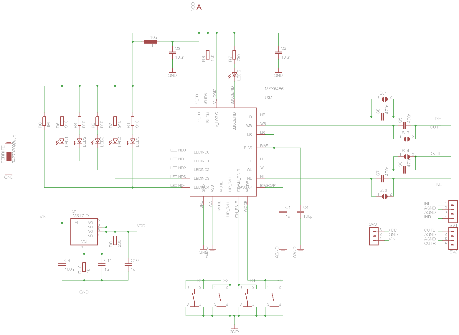

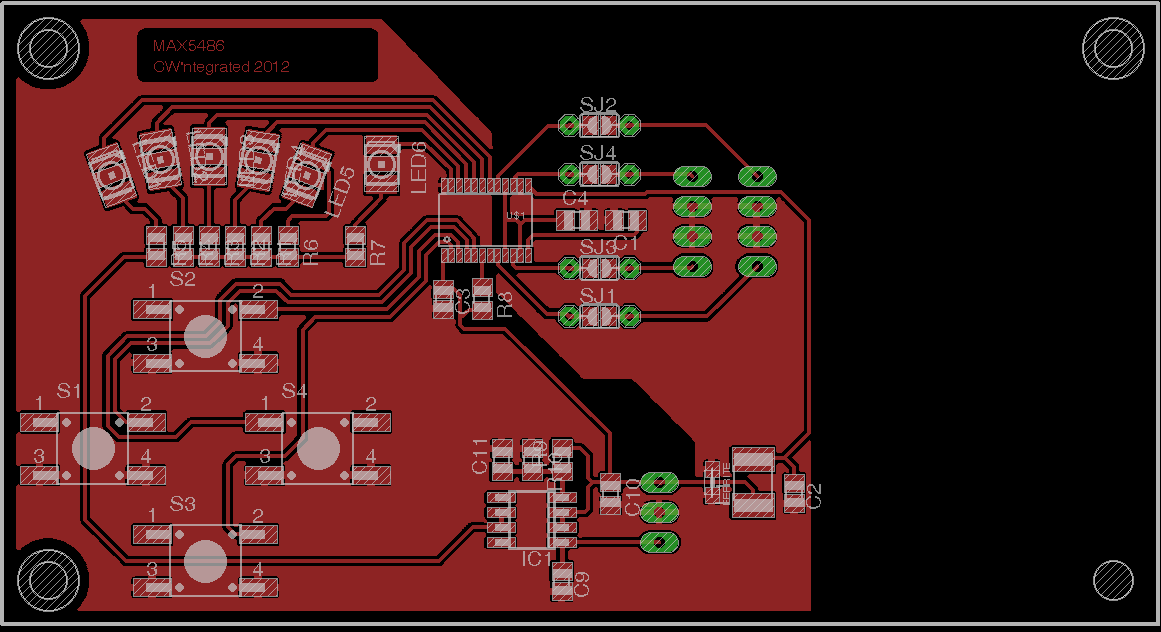

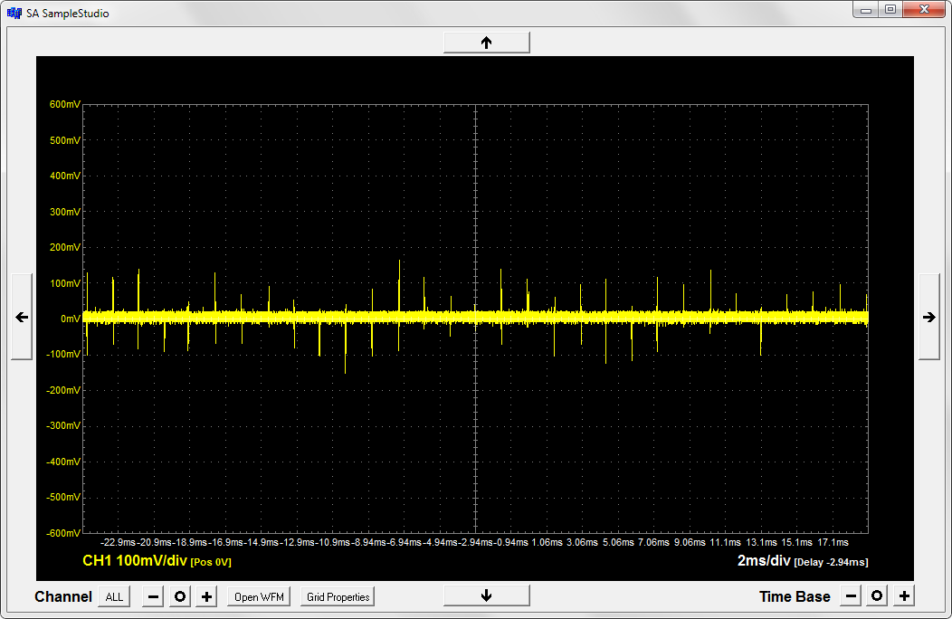

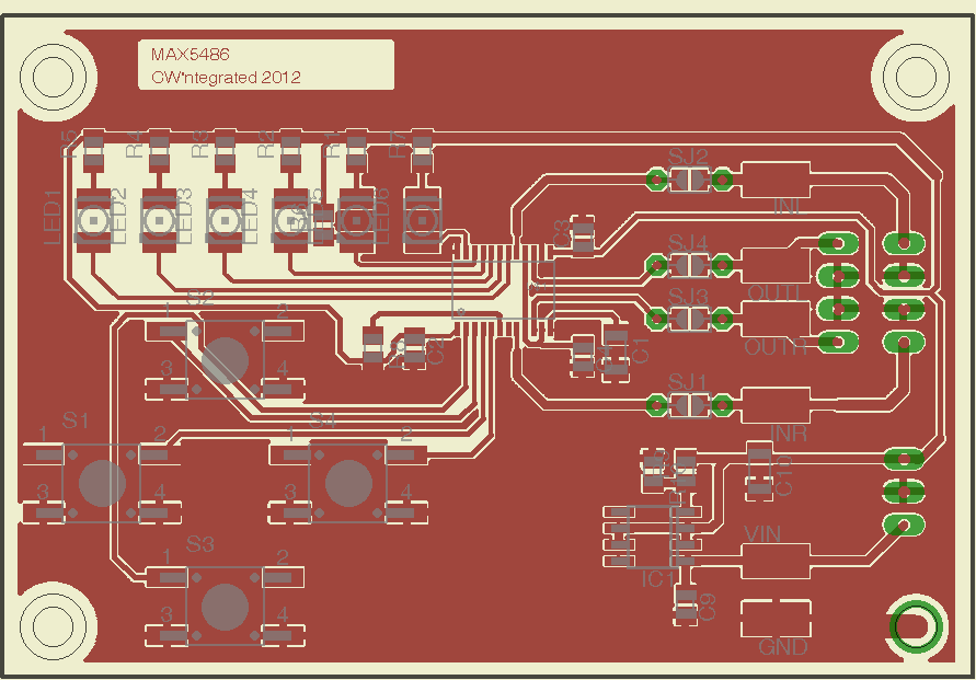

Hi everyone,
attached is my fixed layout for improved noise-rejection. It fixes the PWM-noise coming from the LED-paths and SMPS-switching-noise.

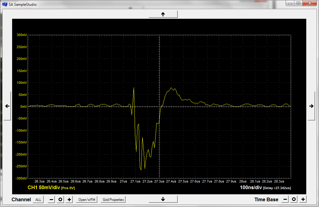

The (now fixed) problem is shown on:
Where a clean dc-powersource (i.e. NO SMPS) did/does not harm the signal, using a SMPS needed some attention. So for this to work, GND and AGND are now seperated and decoupled via ferrite. Additionally the VDD-Input (Analog part) got an LC-Filter (10µH + 100nF).
For trouble-shooting, the ferrite may be left off, depending on your analog signal-path behind the pot.
Note: If you're using clean DC-power, you may replace ferrite (0805) and inductor (1812) with 0ohm.
Feel free to use. 🙂
Regards, doc
