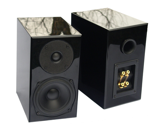

jzagaja said:What do you think about topcoat instead of a paint? After grinding and polishing it looks like this one:
http://www.zgpph.com/kolumny/zdjecia/mietki_03.jpg
That finish is most likely not clear coated if thats what you mean by "topcoat". It looks to be a classic black polyurethane buffed to a high finish. But its still "paint".
sometimes they refer to certain powder coatings as topcoatings. I don't know enough about them to understand why some are called topcoatings and some are called base coatings. They are colored, not clear, so it's not just a top clear coat, it's something else.
