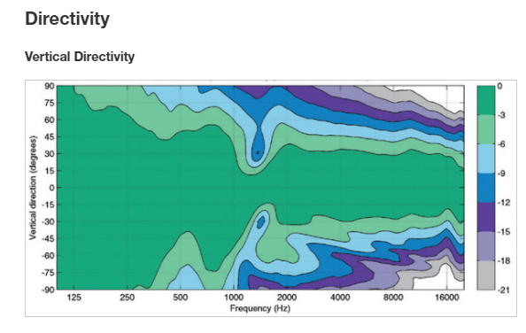

happens on the vertical axis....non the less.
Thats what you expect for all speakers in this kind of configuration with a crossover that high.
Wavelength at 1.7k is 20cm so we are trying to get the 2nd source within 5 cm Center to center to avoid this issue.
most studio monitors suffer from this issue. Genelec just isn't hiding it at all
Am I the only one noticing that you can't get perfect signal unless you are within 15 degrees of center....all that effort and it still beams. The beaminghappens on the vertical axis....non the less.![]()
I wrote this article that explains it: What Causes Off-Axis Nulls?
It's something that's common to nearly all two-way loudspeakers with a waveguide. It's caused by the center-to-center spacing.
