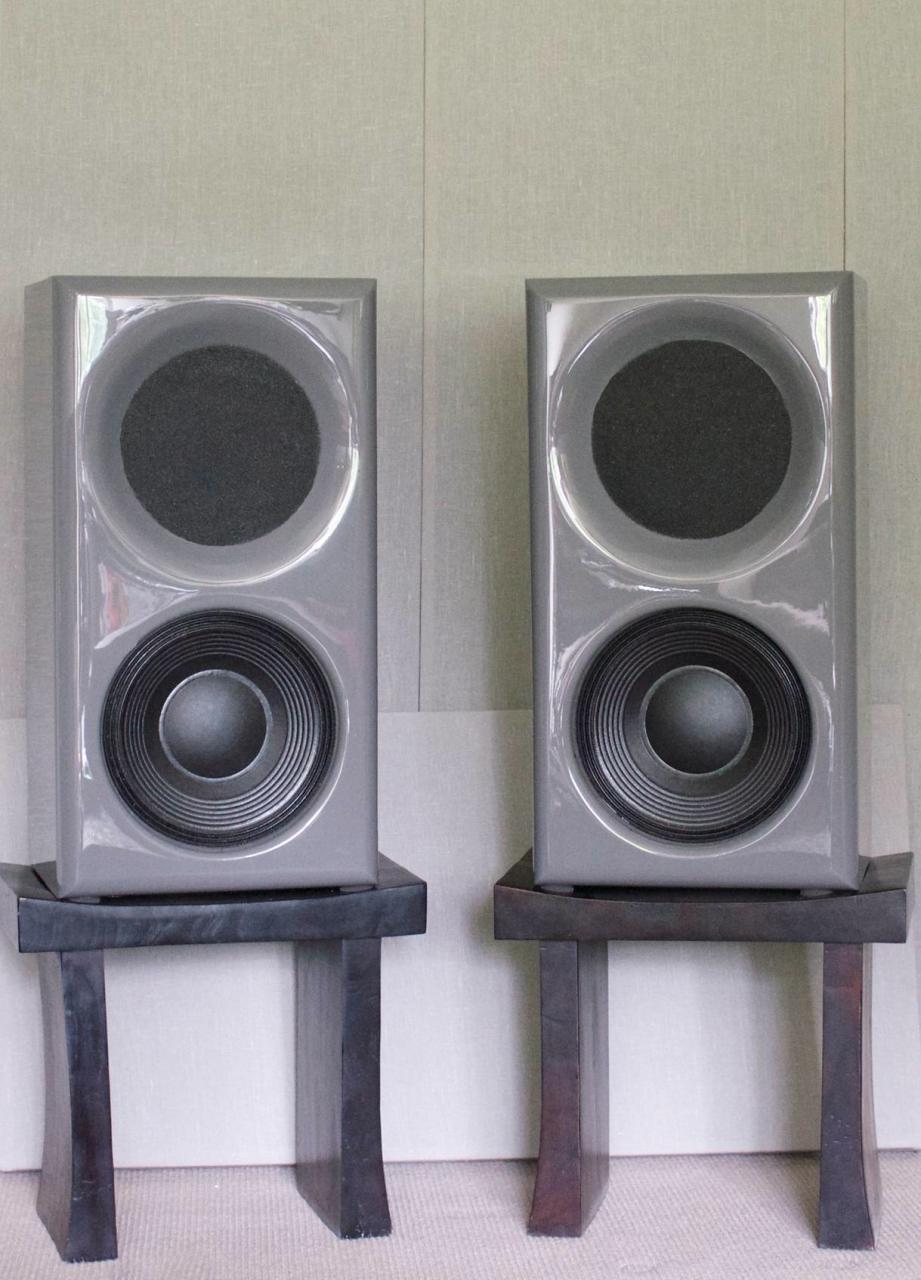

just to confirm this project is now in the final phase. i've used a 2" MDF for the cab and in the end i opted for the bass from the original project so there was no need to adjust the crossover for that. it sounded surprisingly nice from the first moment everything was assembled. there was just some playing with the cab damping in the bass area left and that's it, or it is my brain reminding about different nature of the LF and MF/HF sounds.
the thing i was most surprised with was lack of coloration from the geddes horn. yes, it maybe ain't have the similar feeling of pressurizing the room like tractrix or lecleach do, however that's compensated with much wider sweet spot and lack of beaming. now i better understand the hype about OSWGs.
actually i'm now contemplating about selling the fiberglass waveguides and building the similar from the plywood or MDF, as it would just look nicer in the room.
also at a certain point i will need to upgrade the crossovers with premium parts at the critical positions on the MF/HF filter which is assembled from the cheaper parts, obviously too see how it works.
but it sounds very decent and not too far from my previous horns that were $$$$$.
even my wife who is always a very critical judge gave them a green light soundwise which is an amazing compliment. she's much more critical than me and very often confronts with my tolerance towards some models....the last one she complained about was audio note AN-J. actually the only two ever to get her blessing in our room were oris swing and this one.

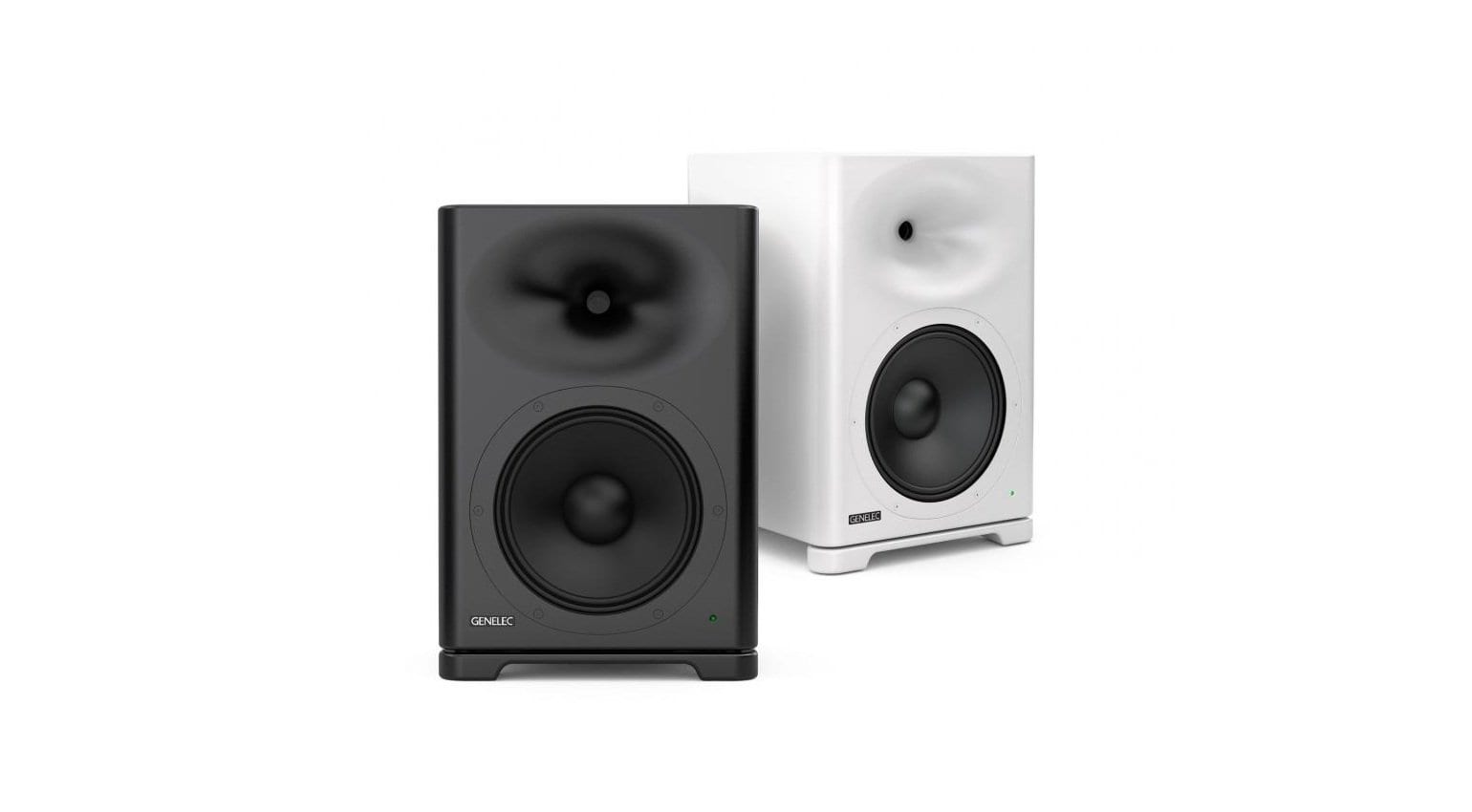

Looks like Genelec is a fan of Earl Geddes:
Gedlee Abbey, a two way loudspeaker with a 12" woofer and a 1.7" compression driver loaded in an O.S. waveguide
Genelec S360A, a two way loudspeaker with a 10" woofer and a 1.7" compression driver loaded in an O.S. waveguide
Before anyone says "there's lots of speakers just like this out there", note:
1) the Genelec appears to be sealed, which is very unusual. (Gedlee Abbey is sealed.)
2) the Genelec is explicitly designed with a high F3. It's supposed to be mated with a sub array and they raised the F3 to increase the overall output.

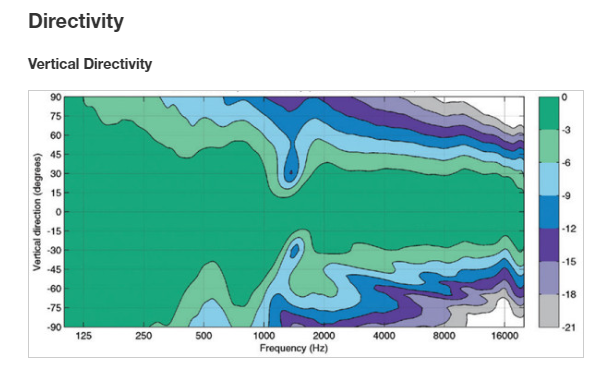

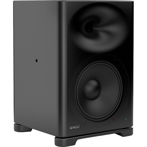

Some more info, gleaned from the brochure:
1) waveguide is 90° x 60° and is largely elliptical oblate spheroidal, similar to the JBL waveguides from a few years back. It's not *exactly* EOS, because there's a slooooow narrowing of the beamwidth up high, same as JBL does now with their ICW waveguides.
2) Crossover point appears to be 1400Hz, based on the vertical polar response.
3) At first I thought the speaker was sealed, but it's not. The ports are on the bottom.

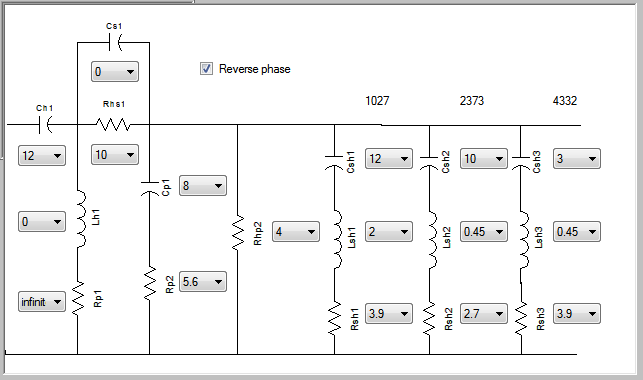

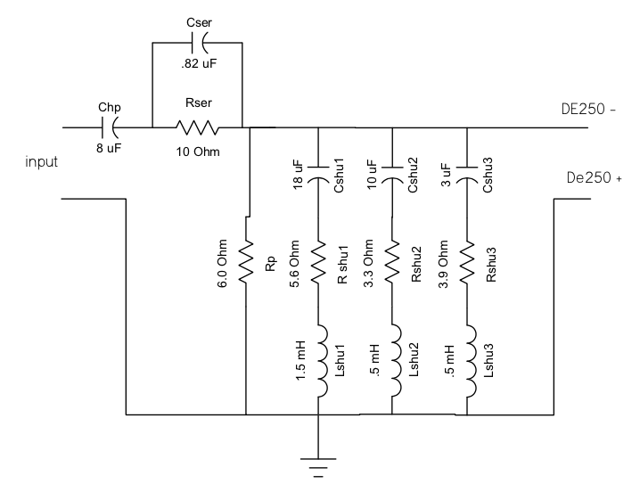

Problem is, I have two crossover schematics for the compression drivers, and I've forgotten which one I should use and could not find that information easily. It was not in the email exchange, but I assume I have seen it either somewhere in this forum or the now defunct forum that Dr. Geddes had.

If the driver is a DE250 pre 2016 then its the right one. The left one assumes a later model, either a DE500 or newer DE250, but I can't tell from the values.
I will then build the one on the right. But still I wonder, since these are both from an email message that is dated November 2012. Is it possible that there was some other change back then? Or already some development with DE500.
