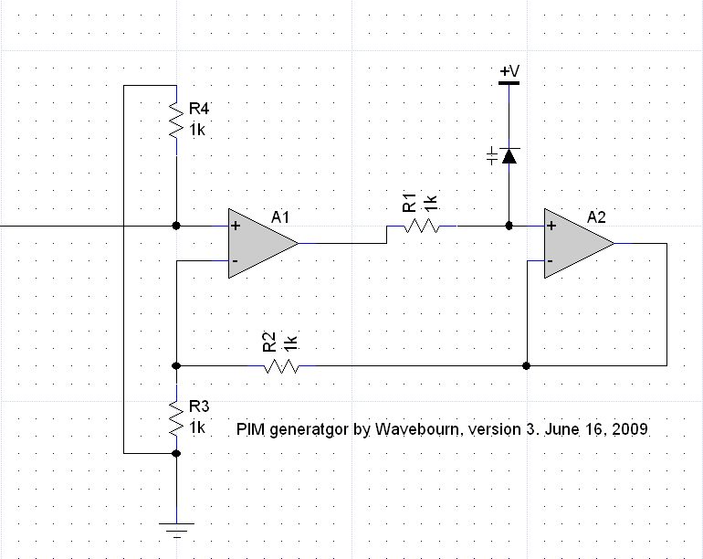

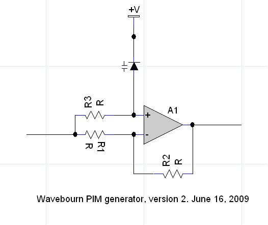

I think that any 180-degree all-pass network with the capacitor being a nonlinear capacitance will act as a PIM generator, and it will have unity gain and no amplitude intermodulation distortion.
Let's go to this version: again, no GNFB, very wide bandwidth (much wider than the whole audio band), but still generates PIM:
We've seen that GNFB is not needed at all to generate PIM.
Now, let's go to the version 3, with the 1'st order (first, literally) R-C, where C is variable It's a Ccb of one of amp's transistors. For simplicity of calculations you may assume that capacitance of the varactor linearly depend on a voltage.
Assume that opamps are ideal in terms of frequency response, but they have a limited gain.
Now, play with resistors R2 and R3 for different amplification factors, an open loop gain of the opamp, capacitance of the varactor, and value of the R1 resistor and see what conditions are needed for an ideal amp as shown to perform as a PIM generator.
Now, replace R1 by a current source then play again...

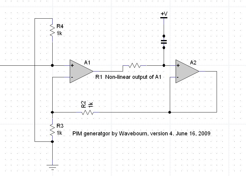

Now, play with this one: stable input capacitance of the output buffer, but non-linear high output resistance of what drives it... You may assume it is the 2'nd order for simplicity of calculations, i.e. it's output resistance linearly depends on the voltage.
What conditions do we need for such an idealized amp to act as a PIM generator?
Now, it's your time to play with real non-linearities and draw your conclusions...

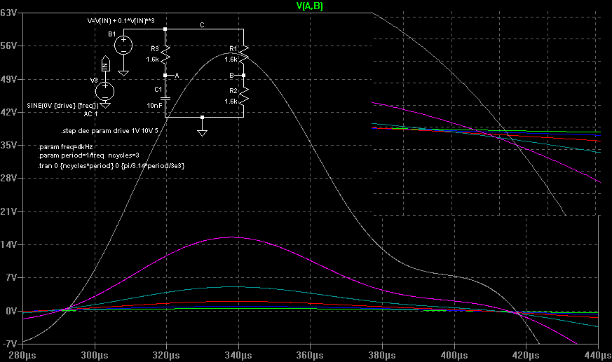

I have NOT read this whole thread in detail so far... but this is my share for the simplest PIM generator ever (I showed this one about a year ago in a discussion, IIRC, with Pavel... or Bob...).
Whenever a nonlinear static transfer function hits a net with non-constant group delay vs frequency we get into PIM troubles... or is this definition silly?
EDIT: found the original discussion... and my example isn't PIM, rather it showed that zero crossing shifts (as an indicator for PIM) can also result from someting else.
http://www.diyaudio.com/forums/showthread.php?postid=1537097#post1537097
- Klaus
