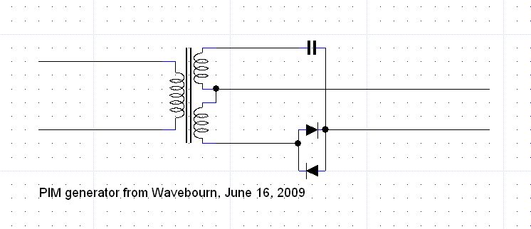

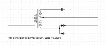

Ok, let's start from a very simple PIM generator. It does not contain a global feedback; it does not contain a feedback at all because it does not have any active element in it, but it does generate PIM. It's open loop bandwidth is very wide, it's gain is stable and equal to 1, in very wide band of frequencies (well, depending on output resistance of the source and input resistance of the measurement tool).
Now, answer honestly: do we need any feedback to generate PIM?

Hi Wavebourn,
Here is what I think the questions and answers are:
Does feedback create PIM? Yes, feedback may create PIM in an otherwise PIM-free amplifier.
Does feedback correct PIM distortion? Maybe, in an amplifier that starts out with PIM when it has no negative feedback.
Does an amplifier with high negative feedback and low open loop gain have more PIM than one with modest feedback and a 20 kHz bandwidth? No, as long as the closed loop bandwidth is the same and all else is equal.
Bob
Ok Bob, please let me repeat:
does this example contain any feedback? No!
Does it have a bandwidth narrower than 20 kHz? No!
Does it generate PIM? Yes!

Bob didn't you mean "high open loop gain" in the first example? That was my example where one can show it in closed form. This is also the most common example used by the NFB crowd.

Good point.
I think that any 180-degree all-pass network with the capacitor being a nonlinear capacitance will act as a PIM generator, and it will have unity gain and no amplitude intermodulation distortion.
Bob
