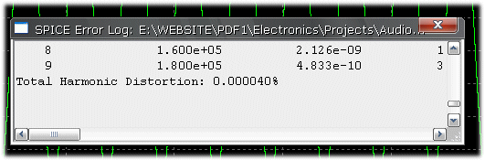

Look here, for how to do two-tone 1:1 IMD sims:Rafael.luc said:You have any example to measure IMD in LTspice?
I would like to simulate in my circuits....
http://www.diyaudio.com/forums/showthread.php?postid=1349571#post1349571
- Klaus
