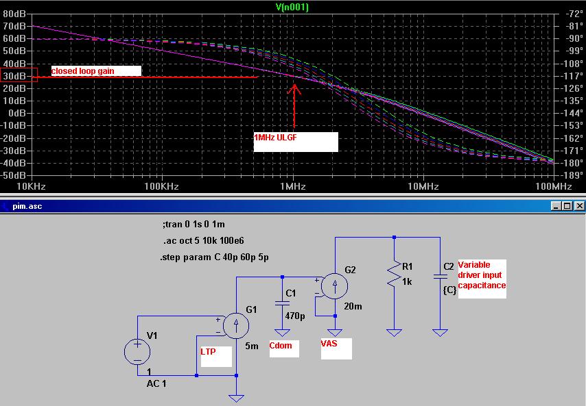

BTW, attached below is a simulation to better articulate what I’m going on about. It is simplified open loop simulation of a typical amplifier designed to a low NFB philosophy (which may also eschew Miller compensation, which is just a nice trick to maximise NFB, after all).
G1 is the input long-tail pair with a gm of 5mA/V. G2 is the voltage amplification stage, with a gm of 20mA/V. The VAS is heavily loaded with a 1k resistor and dominant pole compensation is provided by C1, shunting the output of the LTP.
The amplifier is frequency compensated for a closed loop gain of 30dB, returning a unity loop gain frequency of 1MHz. Note that for simplicity I have omitted the resistive load on the LTP, so the open loop bandwidth is not limited to 20kHz or beyond. It’s probably worth noting here that resistive loading of the VAS is not the only requirement for wide open loop bandwidth, but resistive loading of the LTP is as well – current mirrors are definitely out!
Anyway, due to the lack of feedback-compensation, such as a Miller cap around the VAS to dramatically reduce its output impedance at HF, the VAS output impedance defined by the load resistance of 1k.
C2 represents the driver input capacitance that varies non-linearly with signal amplitude. I have stepped C2 through 40pF to 60pF to show the resultant phase modulation.
Of course, you can rewire the VAS for Miller compensation (evil NFB

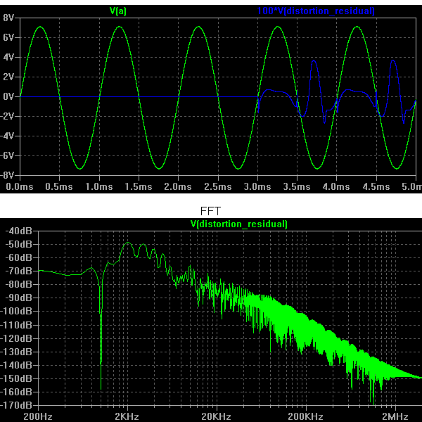

jcx said:My fundamental null tool for LtSpice calculates the exact output phase before the subtraction using behavioral sources to link up Fourier integral equations
That's a great tool BTW. When I first tried it, I thought something was wrong because the residual appeared to have the same period as the fundamental. But I did a .FOUR on the residual and got a fundamental null greater than 200 dB! Great work.
Attached:
G.Kleinschmidt said:
Say what? 😱
Of course, you can rewire the VAS for Miller compensation (evil NFB) and this phase modulation practically disappears due to the pole-splitting effect.
Certainly, you can offer a highly simplified case that does not represent a real amp where the theory does not apply - and from my perspective you have.
It seems to me that the resistive component of the VAS load will be non-linear due to beta dependency on Ic, crossover effects and probably others. I was not talking about a resistor swamping capacitive effects but rather other non-linear resistive effects. Indeed, JC's example was going from 100M ohm to 1M ohm.
I'm not suggesting that anyone would do this but to make your sim more representative of the effect put 6000pF (linear) in parallel with the 1K on the VAS. Then show your sim results with the *same* stepped capacitance.
Also, you show the effective Cdom as a linear cap to ground as I interpret your diagram. A non-linear Miller cap (device capacitance) that actually sees the gain of the VAS is also more representative of the real circuit and the effects that we are looking for.
Wow, you completely miss the point. Your 6000pF suggestion makes no sense. What driver transistors have that much input capacitance? And as explained, C1 (Cdom) is a SHUNT compensation cap.
The fact that I stepped the load capacitance linearly doesn't matter at all - it was just to show the magnitude of phase modulation at will occur with a small variation in VAS load capacitance if the VAS output impedance at HF is in the order of 1k (as in the Otala amp, just for example).
This is the PIM issue I was replying to Andy about, and it has nothing to do with the new discussion about a VAS load resistor swamping non-linear load effects.
Also, if you think that my simplified simulation is not representitive of a real life, workabe amplifier, I can draw the amplifiers full schematic diagram for you.

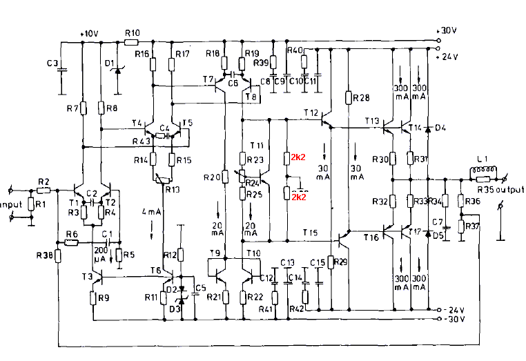

Now would everyone agree that Otala's VAS and chosen frequency compensation scheme (working into only a double EF) is somewhat sub-optimal, from a PIM perspective?
He used his way to skin the cat. Very creative, by the way, instead of copying and pasting from textbooks and online forums.
I personally would hesitate to use 3 stages surrounding them by feedback, though it was common then in tube amps that did not need so deep feeedback to sound properly.

G.Kleinschmidt said:![]()
Well, it's certainly sub-optimal from a distortion perspective. But for me at least, it's not easy to see how much of the distortion of the closed-loop amp is PIM and how much is AIM. OTOH, I think the distinction is vastly overrated. Basically, I think PIM is interesting as a thought experiment and not much more.
- Matti Otala - An Amplifier Milestone. Dead or Alive
