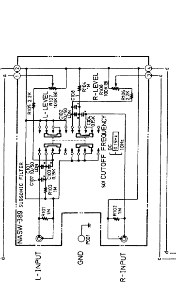

Why even bother doing that.Hi. I am trying to figure out the best impedance match between a passive attenuator, and a unique old amp.
Here is the input to that amp.
100K would be the attenuator

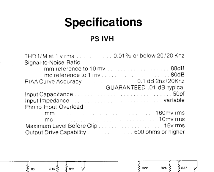

which PS Audio preamp?The stated output of 600 Ohms is with a preamp I don't own. The output impedance of the PS Audio is unknown.
But it doesn't matter they would spec the minimum (which would be like 100 ohms, more likely expressed as >100 ohms)
The designer said it wouldn't work properly unless the impedance from the source was lowered to 600 Ohms
The PS Audio is a IV-H.
no, you wouldn't want to do that. the input filter would not like it. What you have should work fine together without an attenuator.The designer said it wouldn't work properly unless the impedance from the source was lowered to 600 Ohms

Your preamp is fine.
Its designed to drive 600 ohms or higher
And if you really want to know, the preamp you bought would need 50K or higher anyways to work nicely. looking at the schematics
They don't terminate it inside. Like we do with passive summing circuits.Wouldn't that set the output @ 50K?

The preamp/power amp combination you mention, including unbuffered filtering at the input, then straight feeding a 100k pot is poorly suited for what you want to do.
