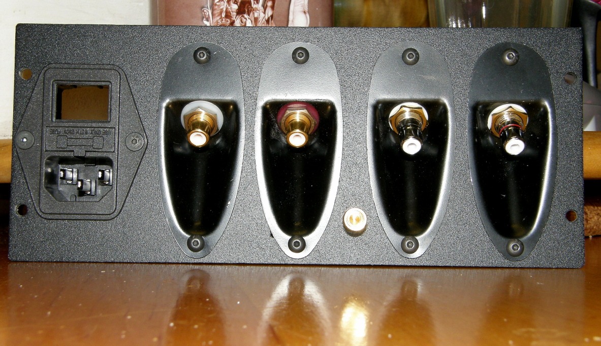

It's also important to allow enough strain relief on the wire connections and plugs.

You mean, like this?It's also important to allow enough strain relief on the wire connections and plugs.
