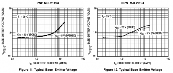

Speaking of transconductance, Figures 11 and 12 in the datasheets for MJL21193 and MJL21194 show there are parts of the line below 1A where the plot is reasonably flat. Perhaps some use of this could be to devise a common emitter amplifier test jig.
