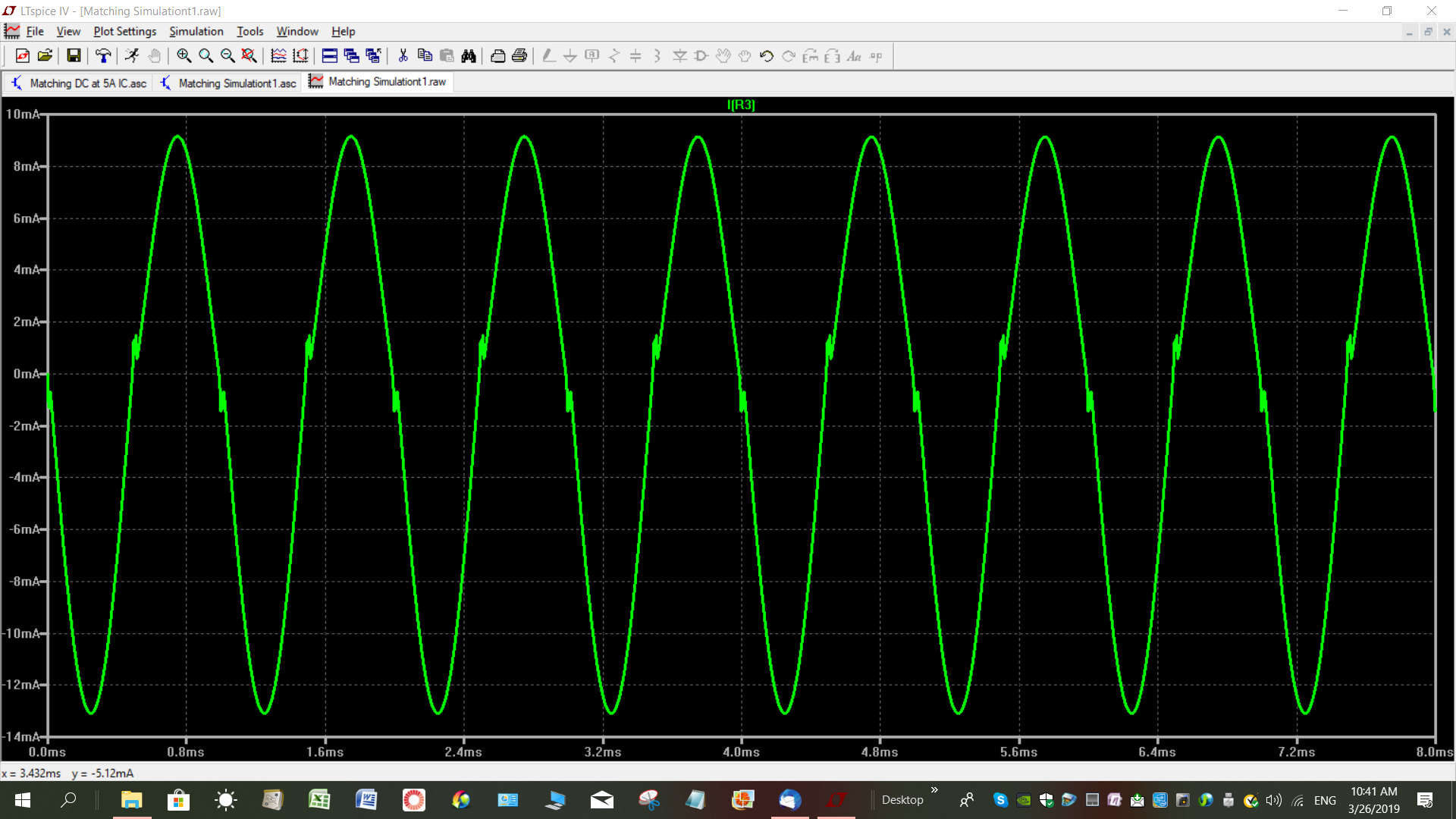

Some Simulation Stuff
I did have two takes on the test set up in my simulation.
The datasheet circuit - with series blocks including a source amplifier and the AP1 test equipment in the chain. I could not include these unknowns but gave this a shot without them.
I found when looking at the current across the 50R series feed resistor there were notches in the sine wave which were not apparent at 40 peak voltage outputs. However if the input voltage to the power transistors was reduced these notches then appeared in the output wave form and the THD % increased.
Having been 0.524% at 100W a reduction to 1W resulted in an increase to 3.38%.
No doubt the source amplifier includes a feedback loop, and this would make those results look better if it was possible to include this circuit block.
Ignoring such benefits, working at low power levels uncovers a dead band in the cross-over region and my second attempt I saw fit to bias the power devices to cover the gap. V4 can be adjusted to test other bias levels.
The modified circuit is still notional but it did obviate the notches and reduce the THD by 20 dB at 100W. At a level of 1W this did creep back up a little but feedback should handle this in a fully worked power amp circuit.
Feel free to experiment with or make changes to either simulation.

Hi mjona.
First circuit, bias is no good.
Your second circuit is on the way to a decent power amplifier.
Add an Op amp LTC6090 in front to drive the bases of your output transistors, then with a couple of resistors apply feedback. Then your are on the way to low THD.
