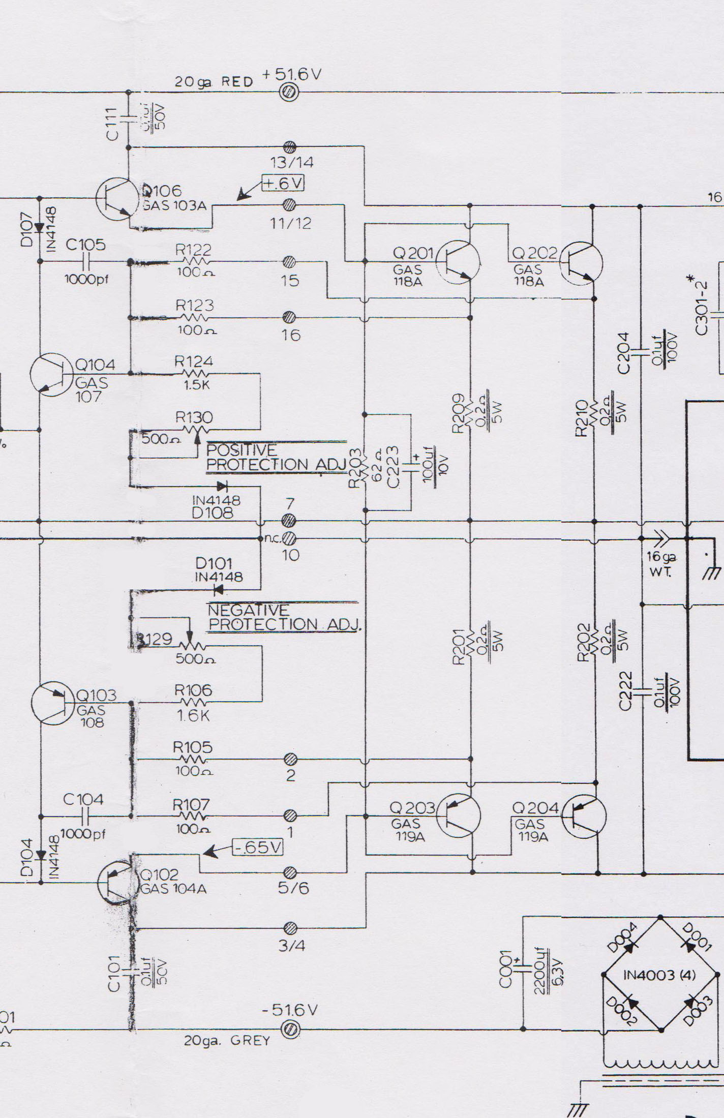

How many great amps have been designed in the past when there was no such thing as complementary transistors, even the ones that were called that had NPN hfe's twice that of PNPs. So Sure matching helps, but, how much is the real question.
