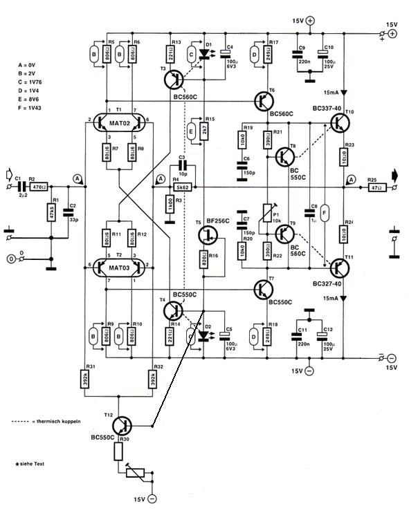

MAT02, 03 Elektor preamp schematic
MAT02 MAT03 elektor preamp class a

This MAT02 MAT03 pre amplifier is one of my absolute Elektor favourites.
Of all times!
There is also some other versions of same circuit concept, in Elektor,
used for Class A HeadPhones discrete amplifier.
I can only recommend this 'Super Class A Pre Amplifier'.
Very good Audio!

Re: So:
bogdan_borko said:
What makes this preamp THE "HI END" ???
bogdan, what do YOU think?
at least you may have an idea, by study schematic a bit
My own idea:
- Excellent matched input pairs. Expensive transistors? YEEEES!
- Full Class A output stage. Does Op-Amps have this? NO!
.... 98% of them OP have a Current idle supply TOTALLY of <10mA
.... This amplifier has got 40mA idle, only in output stage
.... Which means it will put out close to 80mA in True Class A
lineup
1."Expensive transistors?" - NOt a high end argument!
2.It didn`t ment to copare it with op amps...
3."This amplifier has got 40mA idle -" NOt a high end argument!
4."Which means it will put out close to 80mA in True Class A" - all discrete preams work in TRUE class A.
so?

witch schematic?
the one you postet last?
it has an idle current in output stage of 15mA. So this amplifier is only capable of delivering 10mA eff. in "True Class A"
Regards
Jürgen

you still haven't given your own opinion on this great amplifier design maybe you do not want to risk somebody else will express another opinion and argue with you Don't be afraid, do like me, state your opinion! 😉
well, you asked - I answered If you are not satified with my opinion maybe you can tell us all what is bad with this amplifier Surely I have seen many preamplifer I like less and which most probably would not match the performance of this on.

Re: Re: Re: So:
Regards
Jürgen
What I know it has got and can be made, at least, to have 40mA.

Come on man (Lineup) I`m not your enemy I AM A FRIEND! You`re contribution to the forum is big and I have nothing against you.
I wanted to say that elektor likes to put stickers "HI END" on everything and I`m curious what makes this design to be HiEnd?
Complementary, high price transistors, output in class A... that are not arguments for HiEnd.
Wath abut OLG and OLB.
