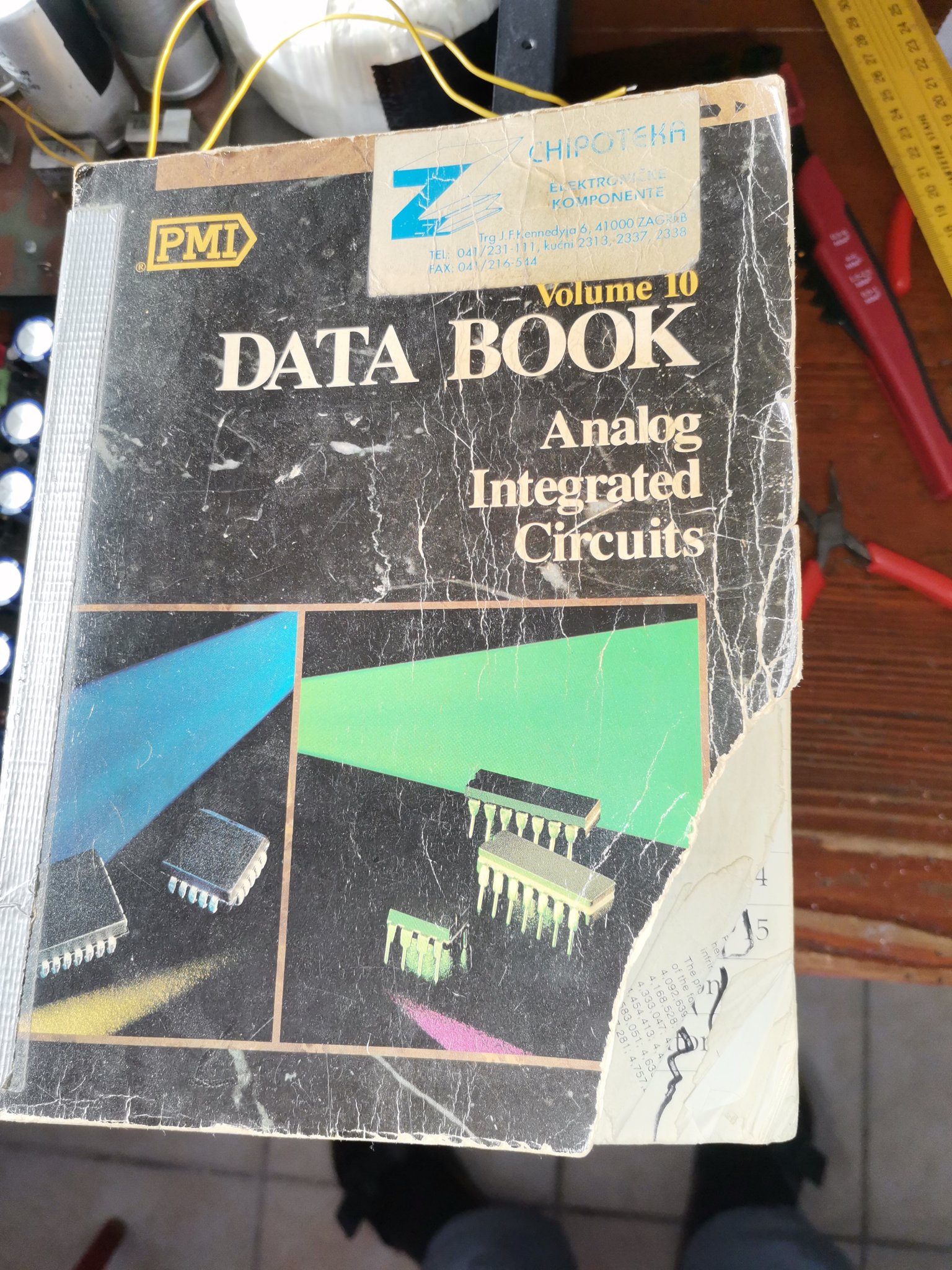

Didn't read this tread in details but I see it is about old matched pairs. If someone needs I have this original book from PMI that was originally making them before Precision Monolithic Inc were sold. If you need any page from it i will scan for you there are many pages on MAT and SSM matched pairs.

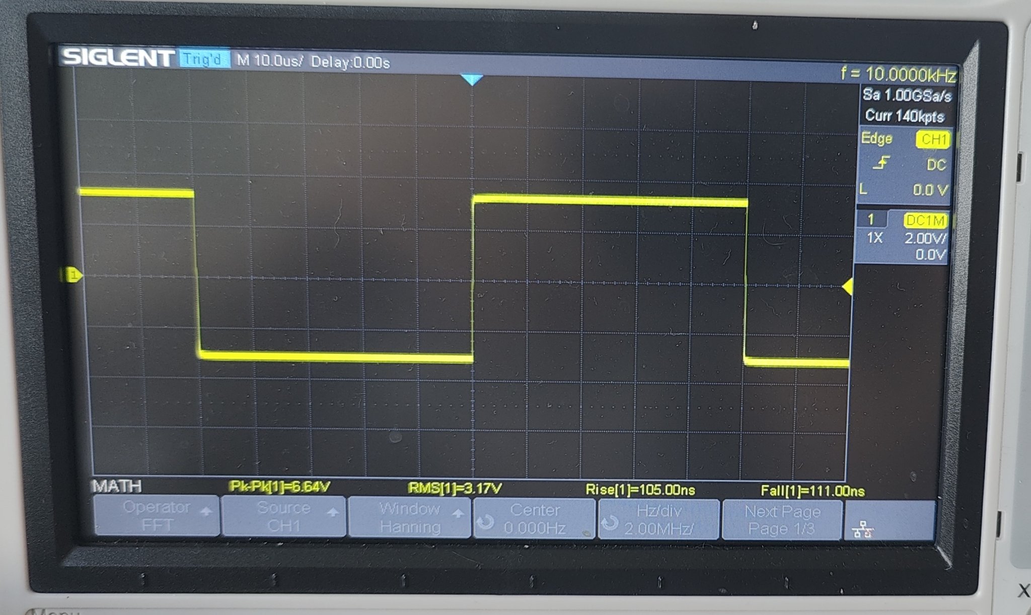

I've spend all evening last night trying to find some curve traces on the THAT-corp just to compare to the BCxxx, but there's nothing to be found online. Only the datasheet from factory. That said, I've decided to go with the THAT340.
DC-offset is more stable then with the BC550C/560C.
I'll do the preamp with the TTA/TTC004. Even at 40mA across each emitter, the TT's stay cool and DC-offset remains calm.
I do find the preamp to take quite some time to find the Null-Point at power up, so I'm leaning towards the servo-version.

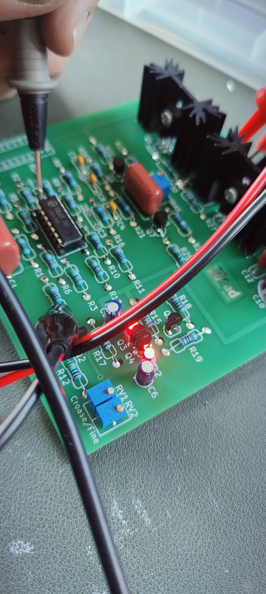

The picture is with the THAT340 diff and TTA/TTC outputs at 10kHz

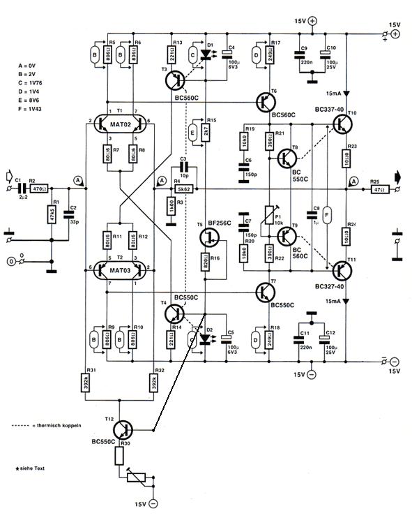

Hello HCPOWER, the schematic is too blurry and I can't see the value of the components clearly. Do you have a clear schematic? Thank youOld thread, but seams like a good place to aske about this preamp.

I just followed the schematic on page1/#4 https://www.diyaudio.com/community/threads/mat02-03-elektor-preamp-schematic.41993/post-488877
I build both the servo version and non-servo, and settled with a servo.
I've tried 1845F/992F but didn't get it to work properly. BC549/559 or 550/560 will get you going.
The tricky part is to set the offset if MAT02/03 is not used. I'll leave this to the builders for now, but I got it working with THAT340 primarily by increasing R29.

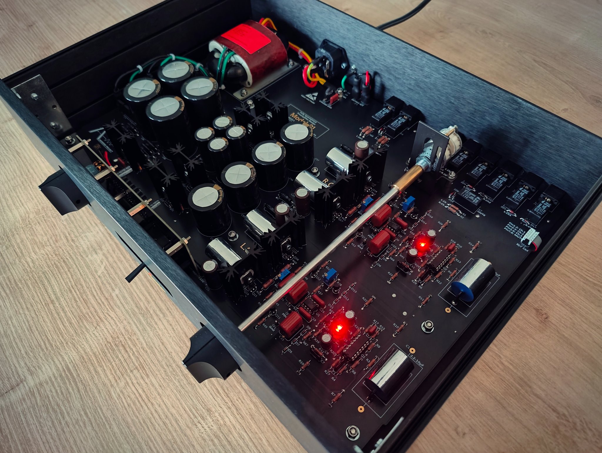

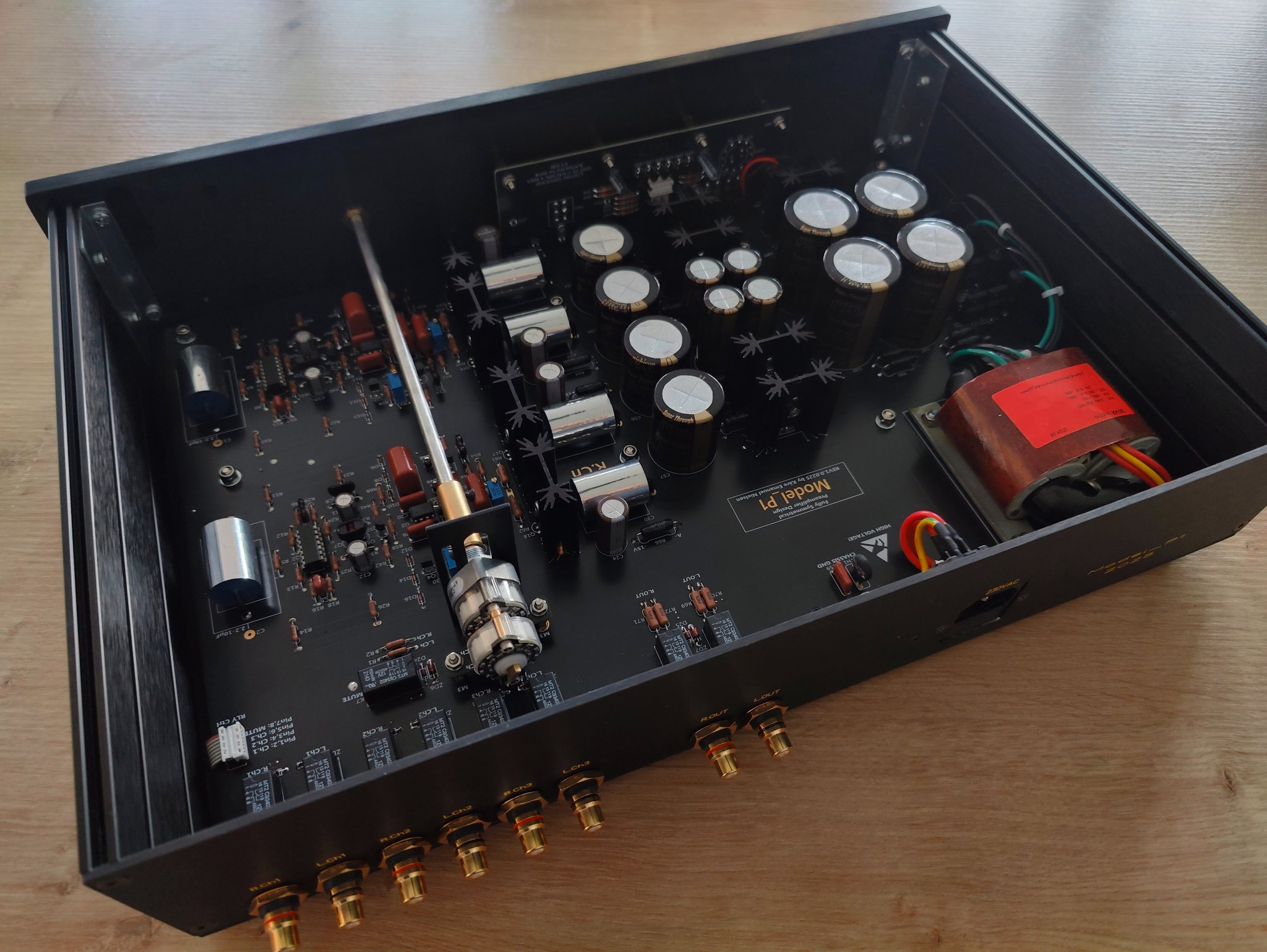

I've finished my build some time ago but forgot to share on DIYA besides from a simple question regarding R-core transformers, so here's a picture of my version. Vastly overkill PSU, but had a lot of fun while building this unit.
I didn't stick completely to the original schematic besides from the overall topology hasn't changed, and the two 10Kohm/150pf has been removed as they weren't needed with the TTA/TTC004 outputs I selected to use.
It sounds excellent and I see no problem recommend others building this "old" 1993 Elektor preamp as posted on page 1, even with BC549/559 as diff if matched properly.
The magazine talks alot about matching diodes and transistors, and it's a must.. Only thing that's not mentioned is the BF256C.
After finishing this build I ended up matching two BF256C, one for each channel to keep the currents source delivering the same mA between the two channels and performing equally. I would recommend this also.
