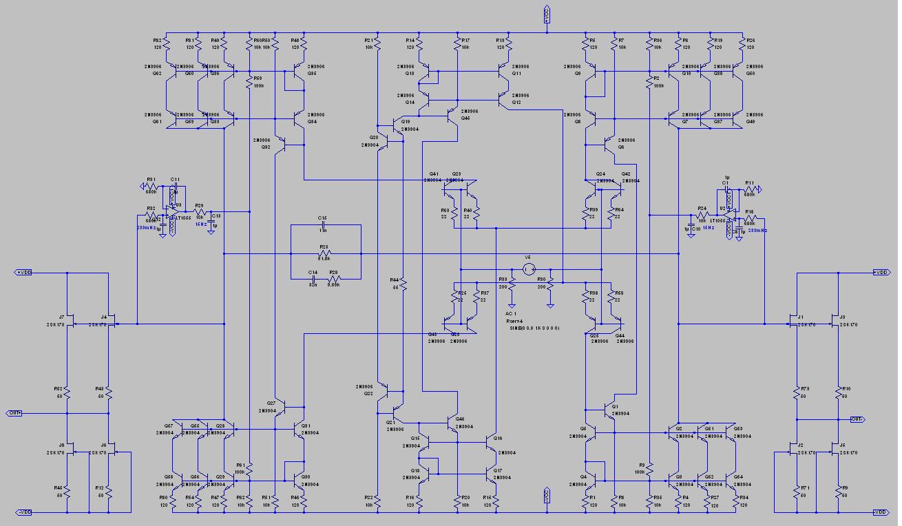

You need to connect the servo to the output of the buffer, otherwise vgs (when connected to the input (as shown 🙂)))) of the fet's is used to create an imbalance in the mirrors. And if you insist, the experiment (that fails / will fail) will be to switch it to the buffer input (and back (very fast)).
I see what you are saying.
Let me correct it then!
I was thinking why it was working on my prototype with the servo before the buffer.
Here is the updated schematic, this should work just fine.
Thanks for the input.
Edit: Wrong I was. I should have said that the vgs of the fet's would be translated in a output offset if the servo-input is connected to the buffer input.
See picture (telling a 1000 words) 🙂 [And yes, I have seen nicer drawings]
Fine, I don't understand why the latter wouldn't work, since the output resistor will restore the output offset to 0 (simulation shows that it properly works).
Servo will push 0V at the gate, Source of the Jfet will go roughly down to -0.2V and then other side of the resuistor will cancel the offset restoring it to 0V.
Can you tell me where this reasoning fails?? 😕
EDIT: I have the prototype running that way and output offset is about 1mV!

It (probably) fails nowhere, but connecting to the low impedance output will be better than to the high impedance input, also it will remove the 1mV, and there is no chance that component tolerances, input voltage differences (vgs), aging, temp, and more factors will ever result in (any form of) output offset.

I believe that the most important part is that you have same beta in all mirror transistors, making quad arrays a very good choice, in some of my paradise variation i have used 3906/3904 quads with good results. I have always used about 120 ohms as degeneration, this is solely based on experience. In power-amps with larger currents I use smaller, in order not to loose to much rail voltage.

I also think 120 Ohm is about optimum. Making it much smaller will amplify the noise of the mirror, not a big problem in power amps but here i think it is critical not to worsen the noise of the input stage. Making it bigger makes the output impedance of the mirror higher
and yes, it will eat up some dynamic range. The output impedance of this cascoded mirror is already sky high so i think we are fine.
