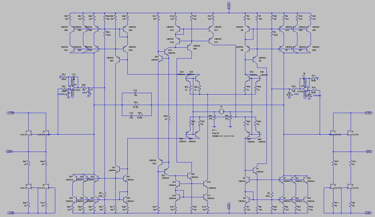

after some simulations, it seems that floating RIAA will work just fine.
The values on the schematic offer an extremely high precision across audio band and bass response at -3dB is 0.3Hz.
My intent is to have the circuit floating as much as possible, thus I eliminated ground reference from helpers and RIAA as well.
I would like to run it with battery only + and -.
I am currently running it like that and no ground tied to the chassis and I get no hum no external interference but sound is clearer than when tied to GND chassis and running of GND.
Please let me know your thoughts and I will include this schematic, if you guys approve it as well, on the proto layout.
It may sound crazy but the circuit as is now could work on only one floating voltage without ANY PSU ground.
The ground is then only the audio ground.
Yeah that's what I meant! I have it work without any PSU GND.
I mean yes the GND from regulators is connected but the GND from battery not.
Sounds just wonderful.

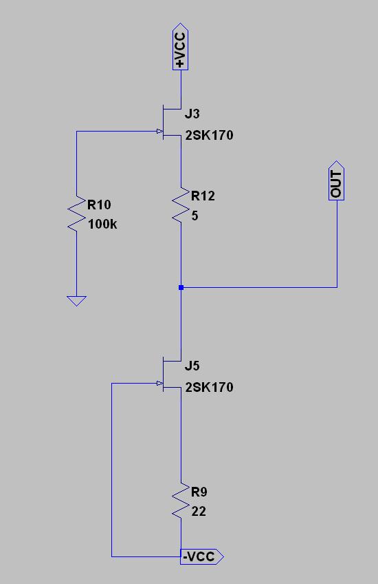

Now i am confused : you use the InterFet part.
I though you run this stage with bipolars.
the intefet part is only on the buffer stage (see picture although values are different).
Everything else is BJT.
I am using half for the current source and half for the active device.
I am thinking to use one for the active device paralleling so each side at 15mA each, hiting then 300mW per side and having cascoded BJT current source with LEDS for bias.

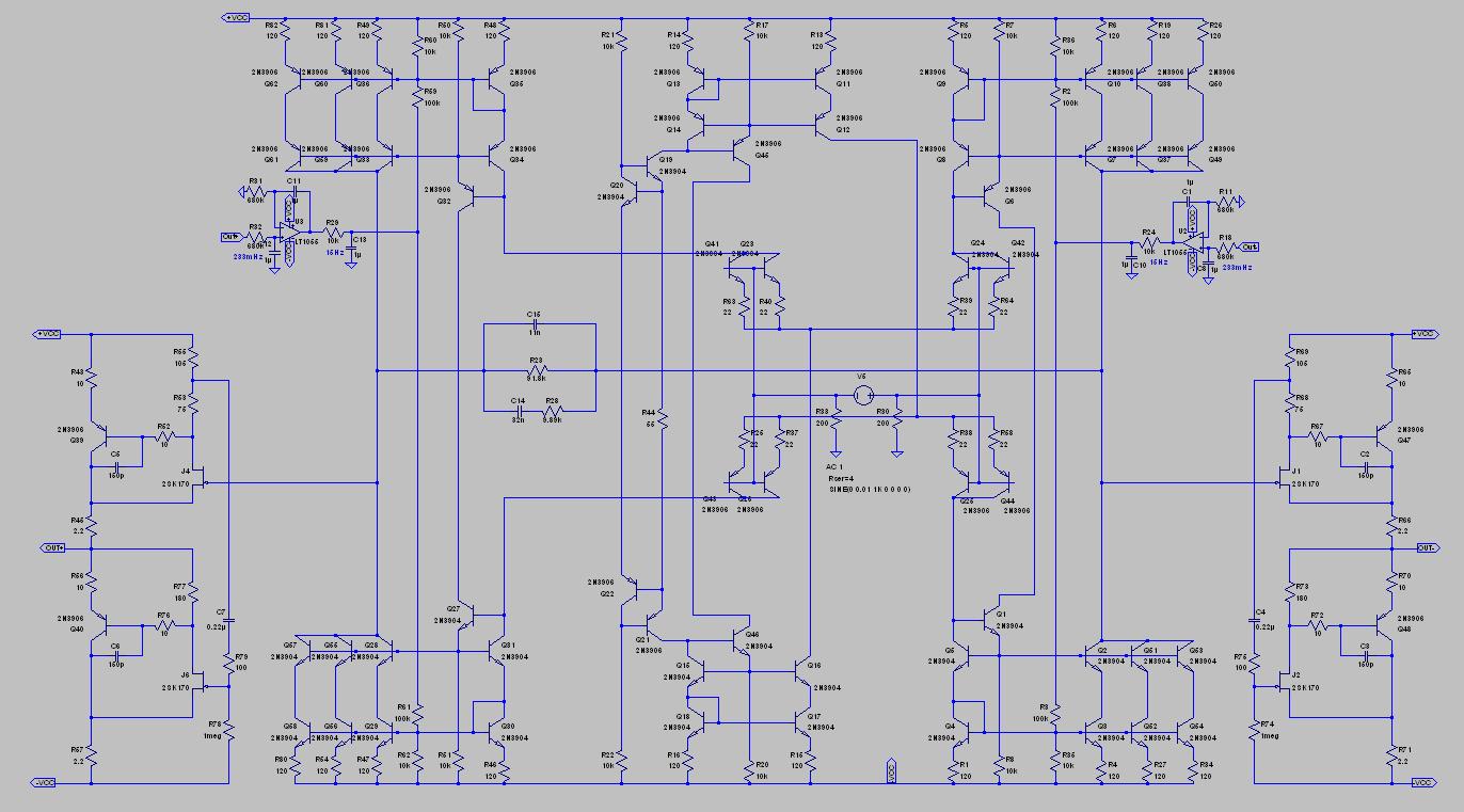

If no cost objective is a concerned here, which it shouldn't, then I would use 4 IF3602 per channel each one biased at 15mA where current source is made with half of the IF to match better thermal drift and output offset; then move the servo before the buffer.
I will give it a try to it tonight see if:
1) gets rid of the distortion
2) sounds any better than only one
Should I on the proto's layout include Calvin's buffer or the double IF3602's?
If I include the latter you won't be able to test it as is but you can always put your external board on it.
I could also do viceversa i.e. put Calvin's and then put the external board with the IF on to compare. :cubehead:
This is probably the version I am going to build if it's ok with developers here (Joachim, Franz, MiiBi).
Since it is not cost objective design, the IF3602 proved to be that much better over the "standard" paradise buffer.
This doesn't mean it will be on the final design as once proto is in a comparison with other buffer will be run.
If so I will try to enter this on Caputure hopefully tonight (however need to try the two paralled IF3602 at lower current to verify that sound is mantained or bettered and if distortion is gone, so time might be a bit tight).
Once schematic on Capure is completed I will post here so we can all review it before going to layout.
Here is what I have on the simulator so far. This is really an exciting design.
I will also try in the next days to see if phono can operate without ground from regulators thus with a complete floating audio ground.

You need to connect the servo to the output of the buffer, otherwise vgs (when connected to the input (as shown 🙂)))) of the fet's is used to create an imbalance in the mirrors. And if you insist, the experiment (that fails / will fail) will be to switch it to the buffer input (and back (very fast)).
Edit: Wrong I was. I should have said that the vgs of the fet's would be translated in a output offset if the servo-input is connected to the buffer input.
