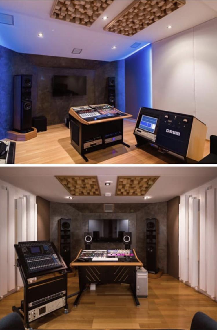

Mitchba: it was a Neve? I don't recognize the model ( but flying faders!).
Yes, that one came from the Who's recording studio! Fully automated with flying faders indeed. HUGE amount of headroom. Lots of fun. Collectors item now.

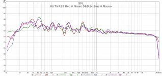

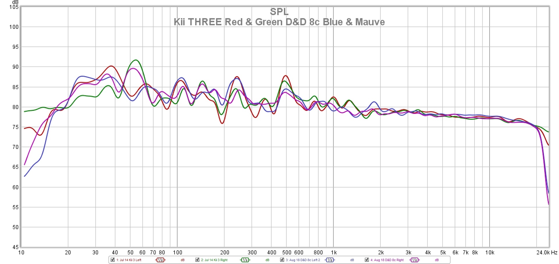

is this where the Dutch and Dutch and Kii come in? Are they actively manipulating room acoustics on a deeper level than FR at listener point?
Cheers! The D&D 8c and Kii THREE both are cardioid designs with constant directivity down to 80 Hz. 8c is passive cardioid and THREE active, but both work equally well:
attachment.php
Here I have used each loudspeakers onboard boundary, PEQ and contour controls to match the response of both speakers in the same location. In a DBT I doubt I could tell them apart.
The advantage of the cardioid pattern is that it mitigates speaker boundary interference pattern and some room modes better than non-cardioid designs. Not a replacement for digital room correction, but does help and makes it easier to set them up and get decent sound quickly. But, I still use digital room correction to fully optimize them to the room.
